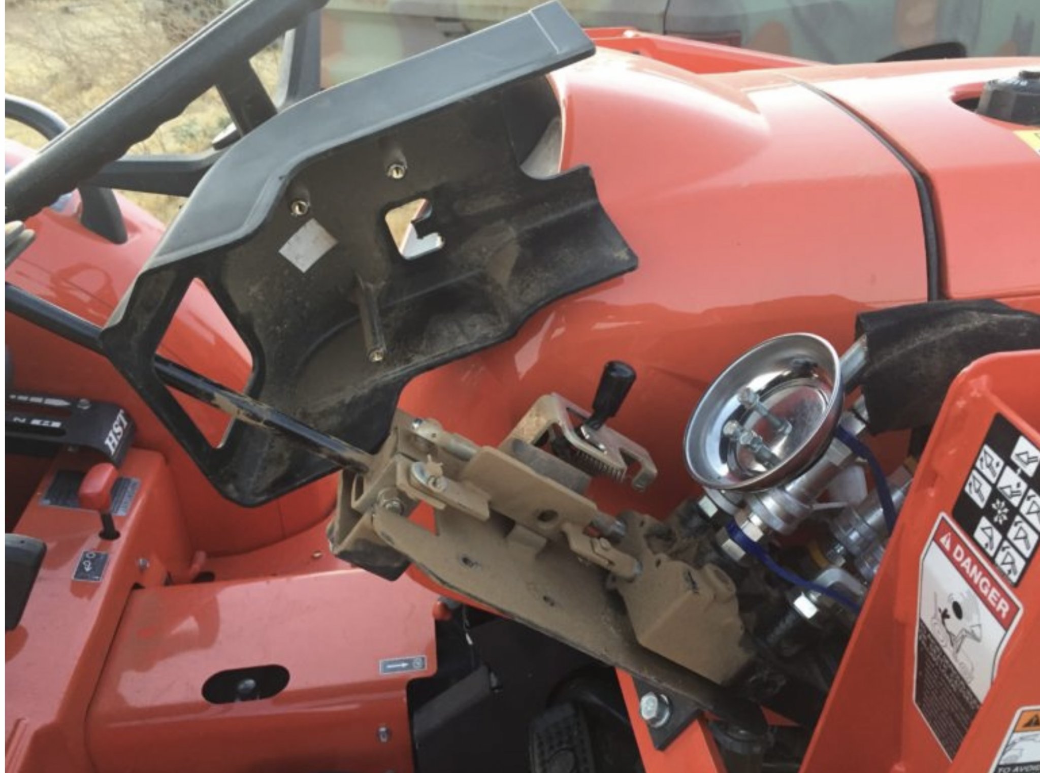

I took my tractor down to the land today to start clearing for a 27 x 24 tractor shed.
Half way thru the loader control falls apart and the joy stick flops all the way down.
Not a huge deal but in my situation complicated getting back to where I parked my wheelchair as the loader was in float position when the control stick fell apart. I am not sure if part 070 pulled the threads from the control stick part 110. I was not able to drive forwards without the grapple trying to dig into the soft sandy soil. . With the cover on it was impossible for me to get it back together and of course no tools with me.
Anyways before I run back down with tools can someone confirm that its just the one bolt numbered #290 that attaches the cover to the rest of the assembly

It has 3 - 10mm bolts holding the cover on. Looking from the bottom of the vale. Right side - top and next one down. Left side- top. I didn’t take the lock out knob off, just slid the cover over it.
