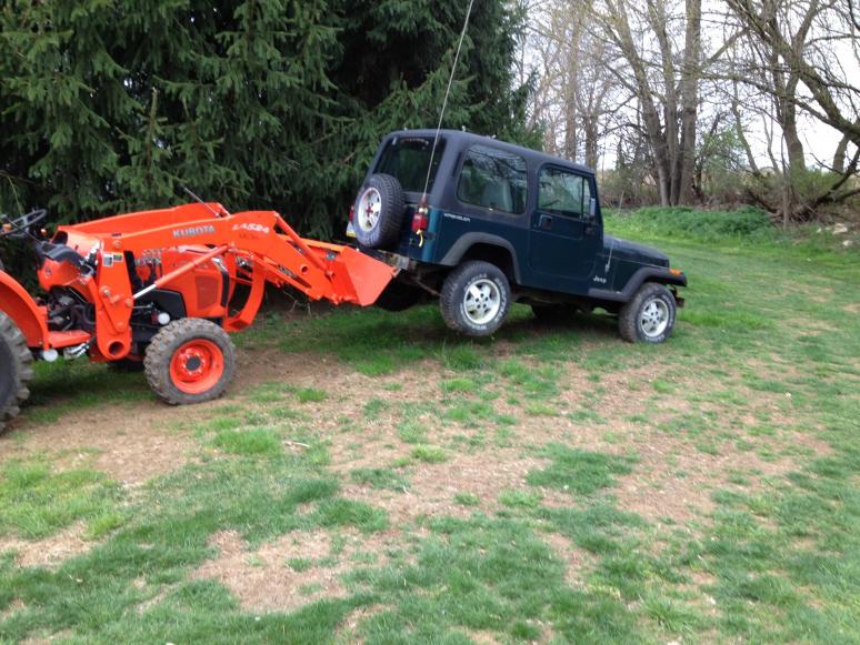

Tractordata.com shows the same capabilities for the LA524 loader on both tractors. My GUESS is there's a standard/common hydraulic pressure that Kubota uses. Since it's the same loader the cylinders are used so the same pressure on the same cylinder = same lift.
That pic reminds me that it's about time to put the cab back on. Sounds windy and chilly outside this morning. Hopefully we'll see more snow here this winter:D
