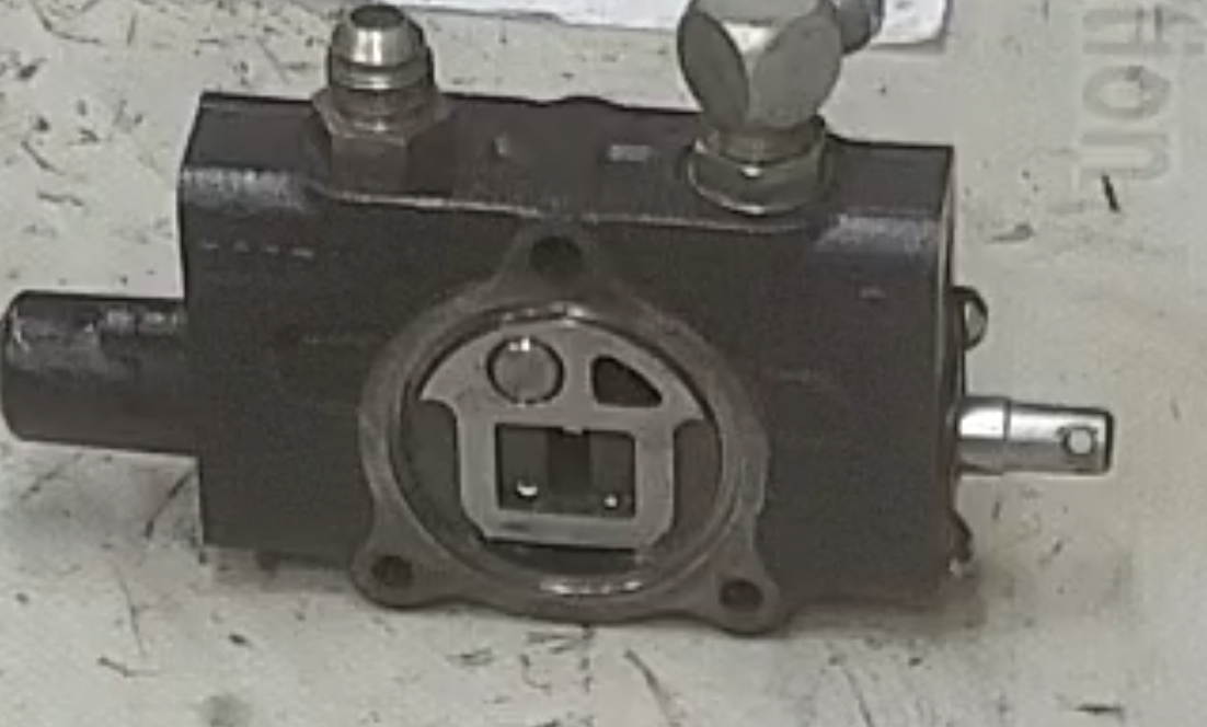

I bought pretty much all the rebuild kits from messicks, took the control valve off and pulled it all apart and replaced all the seals, springs, bearings, etc. I replaced the 120 and 130 above. When I put it together I laid it down so I was stacking vertically so the springs stayed in place. I took a video taking it apart, but you never have the exact pic you need. I was looking for a LA480 manual so I could verify the direction of 130, which a cylinder with one flat side. The pic of pulling apart showed it flat side pointing right - spring on top of flat part, but this makes me not so sure. Like the flat part should be inside the unit and the spring fits inside the cylinder part of it. But I replaced all the o-rings, springs, plastic seals and poppets (130) I believe they are called. Original spring tension felt fine and the original poppets were in good shape, just a few scratches around it I could feel with my finder nail.

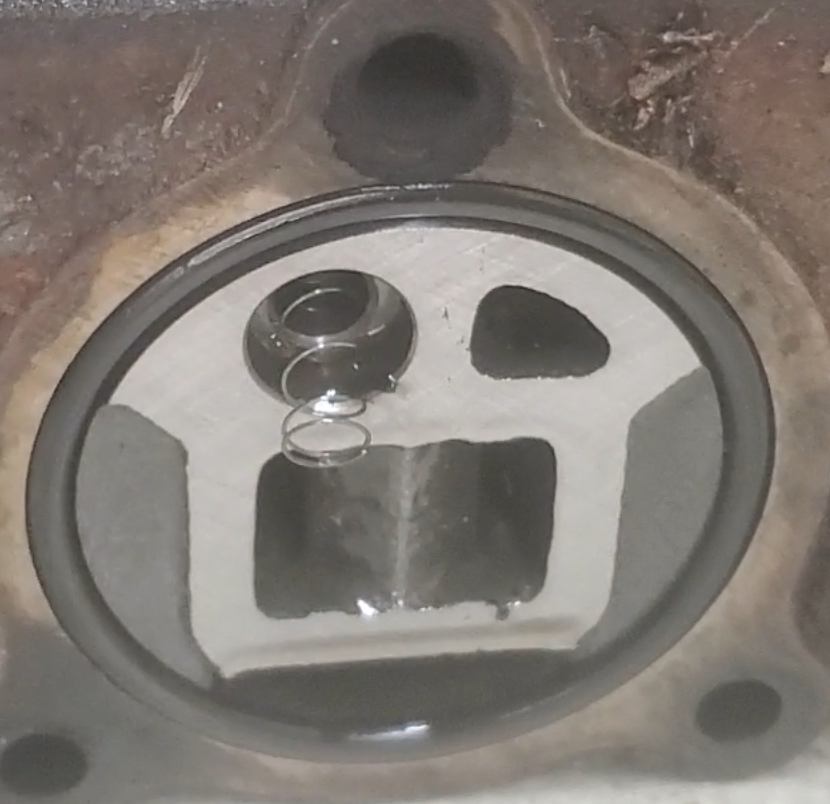

Ok, now looking at video, it looks like it went spring in the hole, the poppet and I did poppet then spring. These are tear down pics. That means I have it opposite order. $#&#!!
View attachment 147076 View attachment 147077
Poppet goes in with recess out. Then spring goes in the recess.
Edit: this diagram is for a Husco 5000, which I'm not sure yours is. Is there a tag of some type of some id cast in?

Thanks that was it. I had poppet flat face out and then spring. Switched it to flat face in with the spring in the poppet and it's working correctly. Bucket still drops when it's not running maybe an inch every few minutes. The main reason for rebuild was for the bucket slowly dropping under load while running. I'll have to see if the rebuild fixed that issue.
