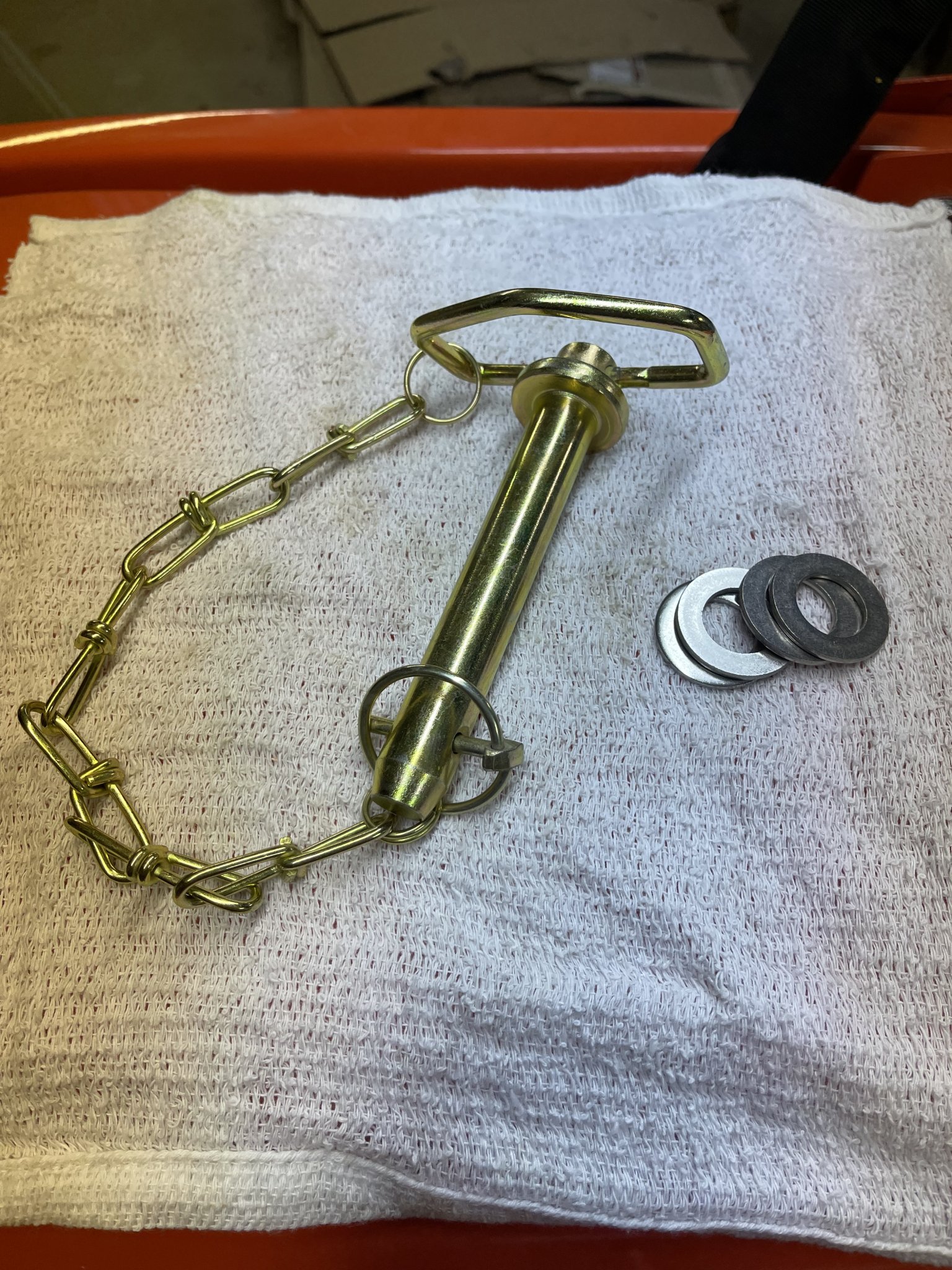

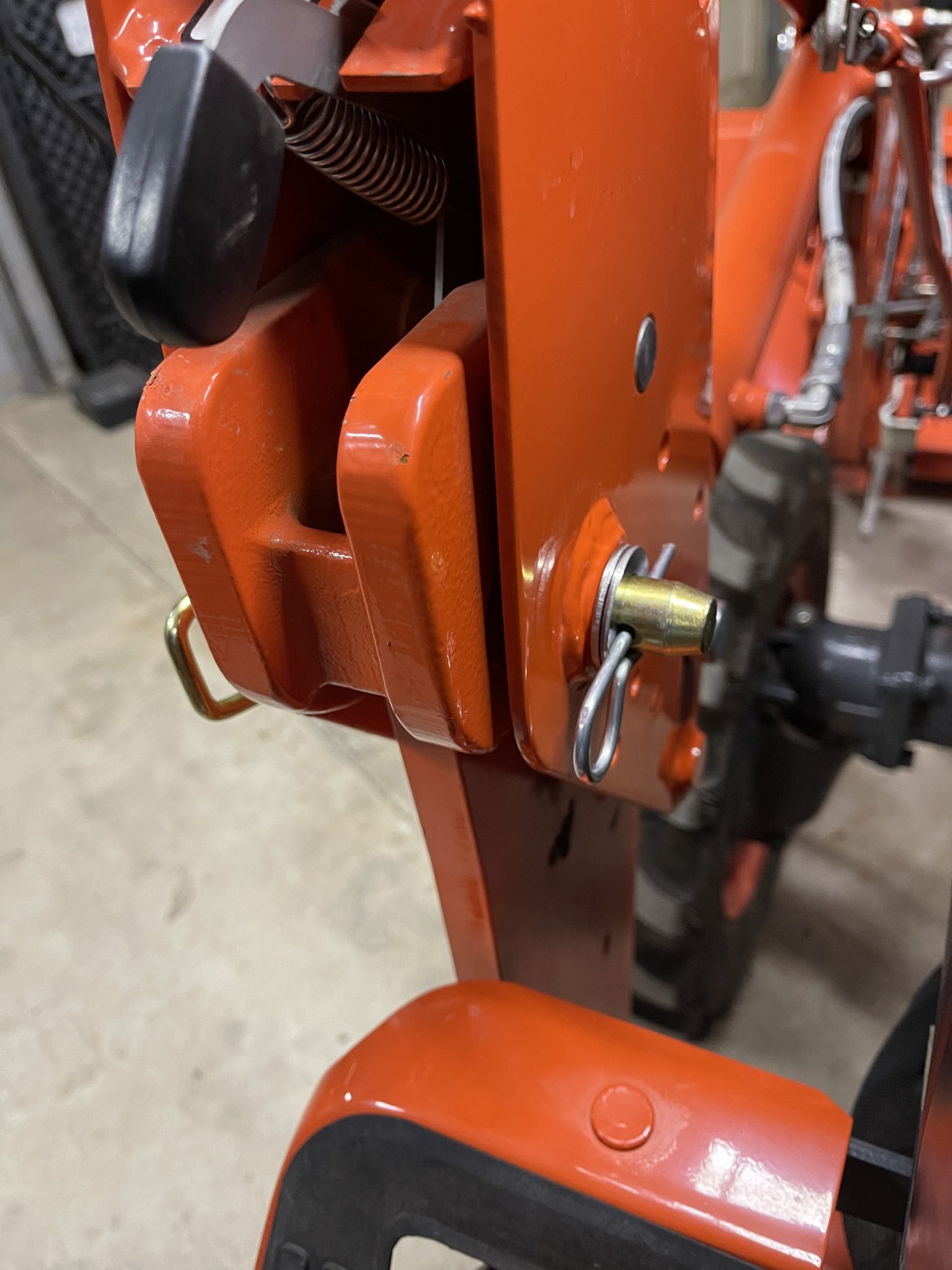

Well after waiting 4 months still can’t get the parts from Kubota.
So I took the tractor back from my dealer and put these pins in For now.
So now their is no way it can come off.
McMaster Carr #98497A664 Pin and 98017A220 Washers.

Solid fix, great pics. Unfortunate that you are still waiting on a Kubota solution, but your solution is first-class. Thanks for the excellent update! (y)
