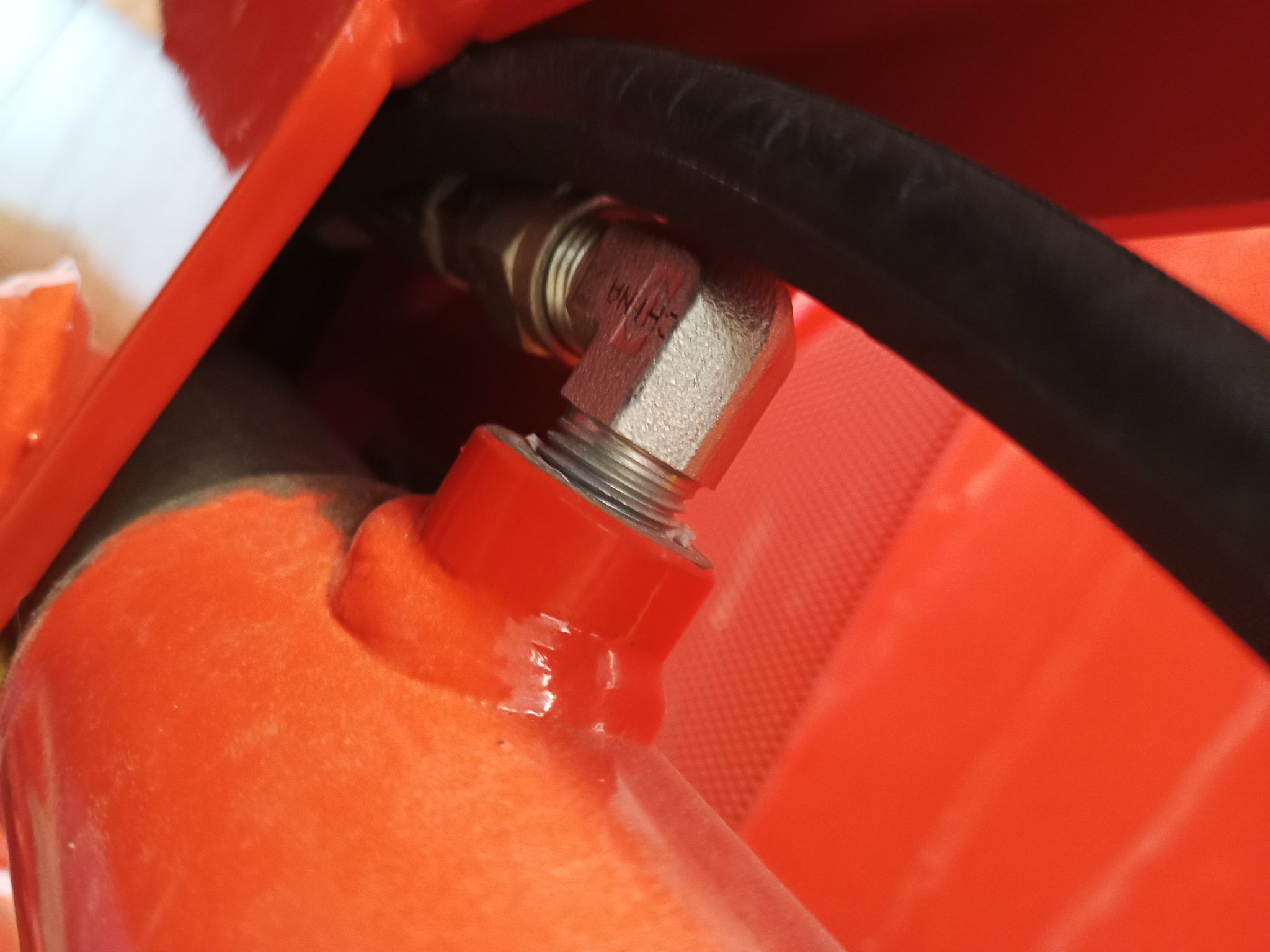

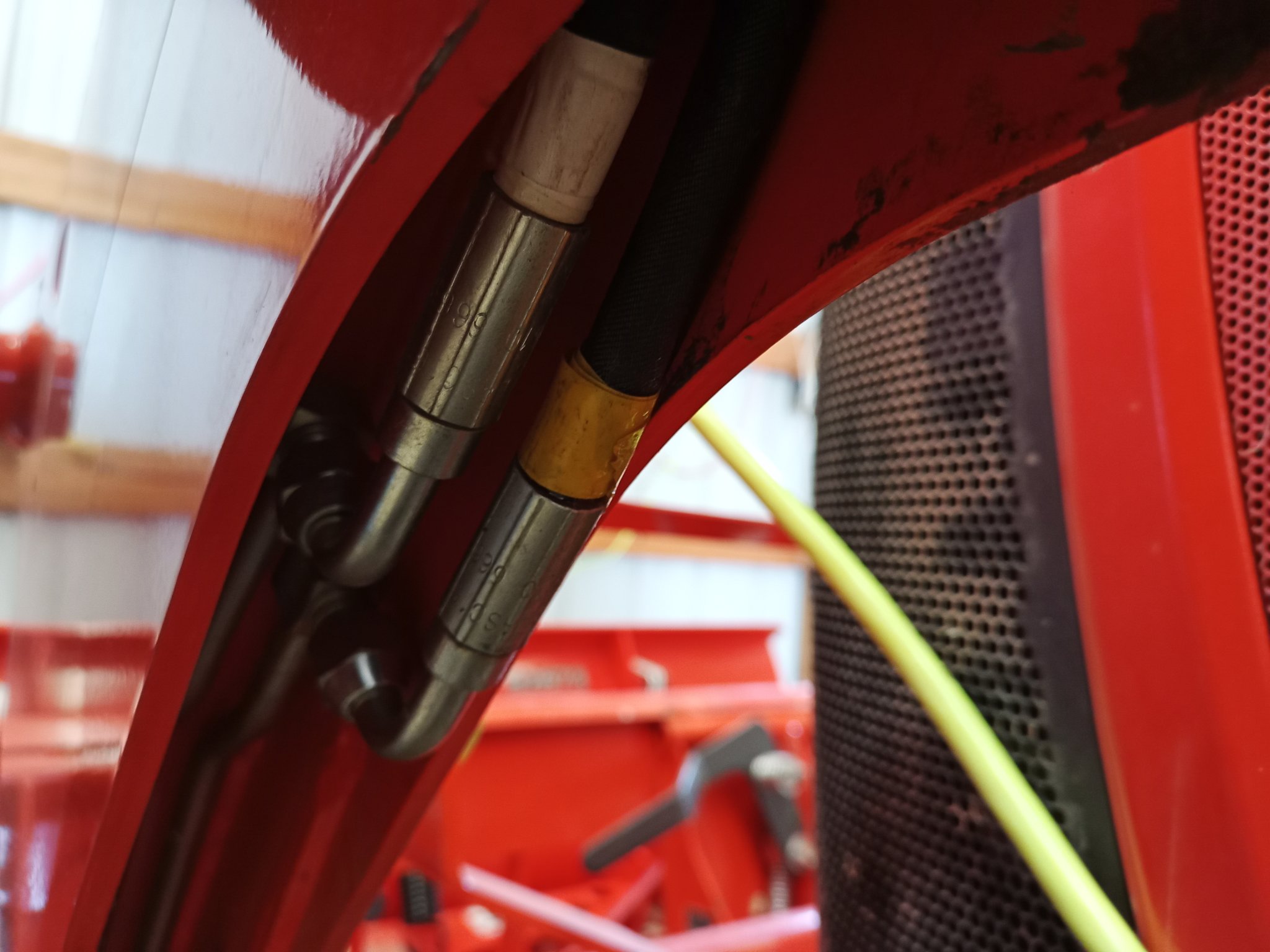

Hose is leaking and it looks like a PIA to get to. It is the short hose, yellow marker tape, on the left side of the FEL if you are sitting in the driver seat, pics attached. Limited area to get to fittings. Anyone ever replaced this hose and if so how did you go about it, tools, etc.

If thats on the base end of the cylinder as it appears just remove the pin and.lower the cylinder.

Thanks, looks like that will be the best avenue to tackle it. It's not too bad but I do want to fix it, Kubota dealer is 50 miles so will have to wait for better weather to get a new one. I assume you just remove the set nut and drive the pin out.
