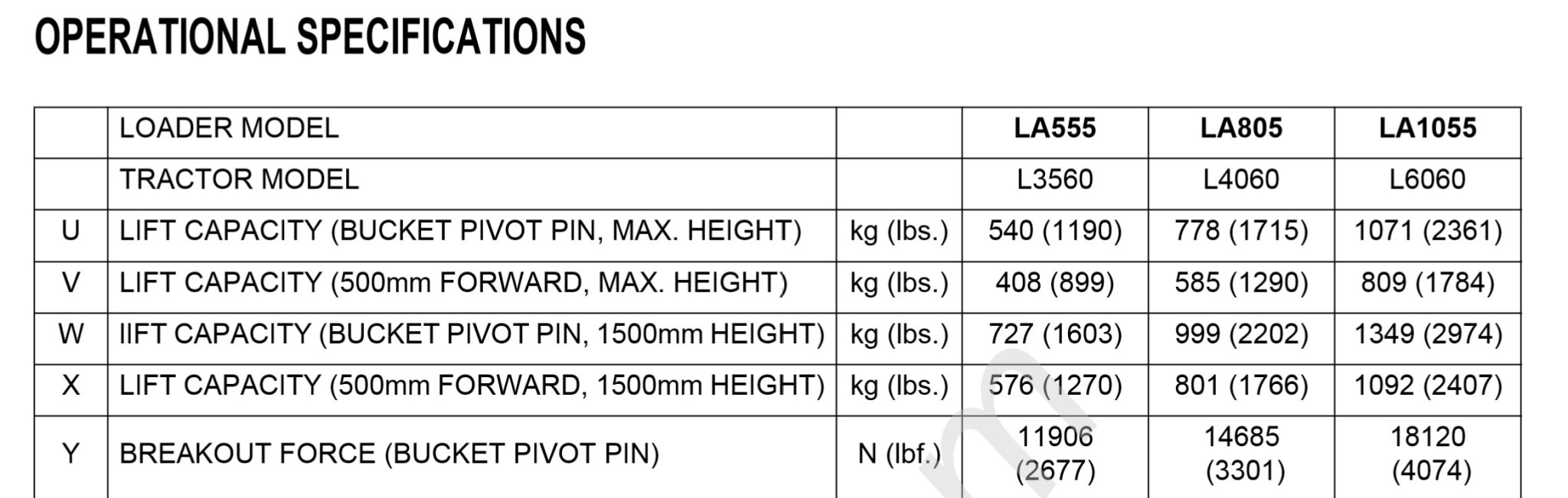

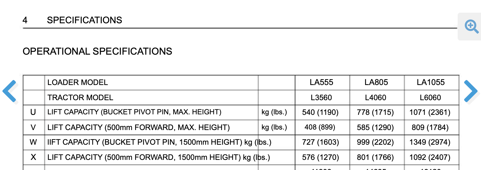

Updating, I didn't find the full loader curve, but I found this copy of the loader manual: https://www.manualslib.com/manual/954577/Kubota-La555.html?page=16#manual
And on page 16 it says 2,400lb to to 1,500mm, which is 4.9 feet. That's pretty damn close to what you need, even if you allow 400lb for SSQA and forks.

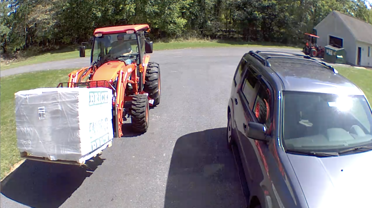

I've never owned a L6060 but I'm on my second MX series tractor and I unload and double stack 8 skids of Woodbricks every year with the MX tractor. Each skid has 1 ton of Woodbricks on it I never weighed them so I don't know the exact weight with the skid and stretch wrap on them. My forks weigh around 250lbs. and are 42" forks. I would think you should be able to do it with a L6060 as well. I have the tires filled and 3 sets of wheel weights plus I use a 1k 3 point ballast box on the tractor. I can tell it's at it's limit when handling the pallets but I've never had a skid it wouldn't lift or double stack since 2017 when I started burning the bricks instead of firewood.

My read is that the owners manual says it'll do it. It's at the limit, so good ballasting, being careful etc are important. But in terms of the mechanical question "can it lift it" I think the answer is yes.
