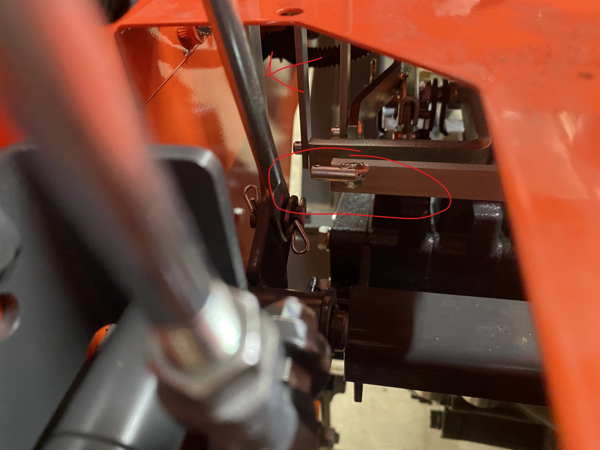

What is the updated linkage and what does it resolve or improve? Thanks.
In this picture....
You see the front horizontal bar with round bar tacked on.. Thats the bar that goes to valve 1. Directly behind the vertical round linkage that mostly in focus, you can make out the vertical flat linkage that goes up to the handle. This linkage obviously isnt lined up with the horizontal linkage. It needs an offset in it to mate up. The updated part has the offset built into it.
