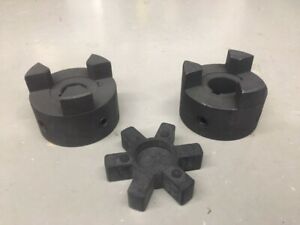

If you still have the old shaft and parts, you could get running again making some aluminum or steel drive disks with bolts & elastic stop nuts left a half-turn loose so the assembly can run without binding.
A local repair/machine shop could make up a new shaft with 2 inexpensive flex couplings. The pump and engine are both hard-mounted so all the shaft needs is decent torsional strength and a bit of alignment flex. Two-row chain couplings are inexpensive, easy to adapt, and long-lasting. Kubota used them on earlier models. Jaw-type couplings are cheap too and compact.
