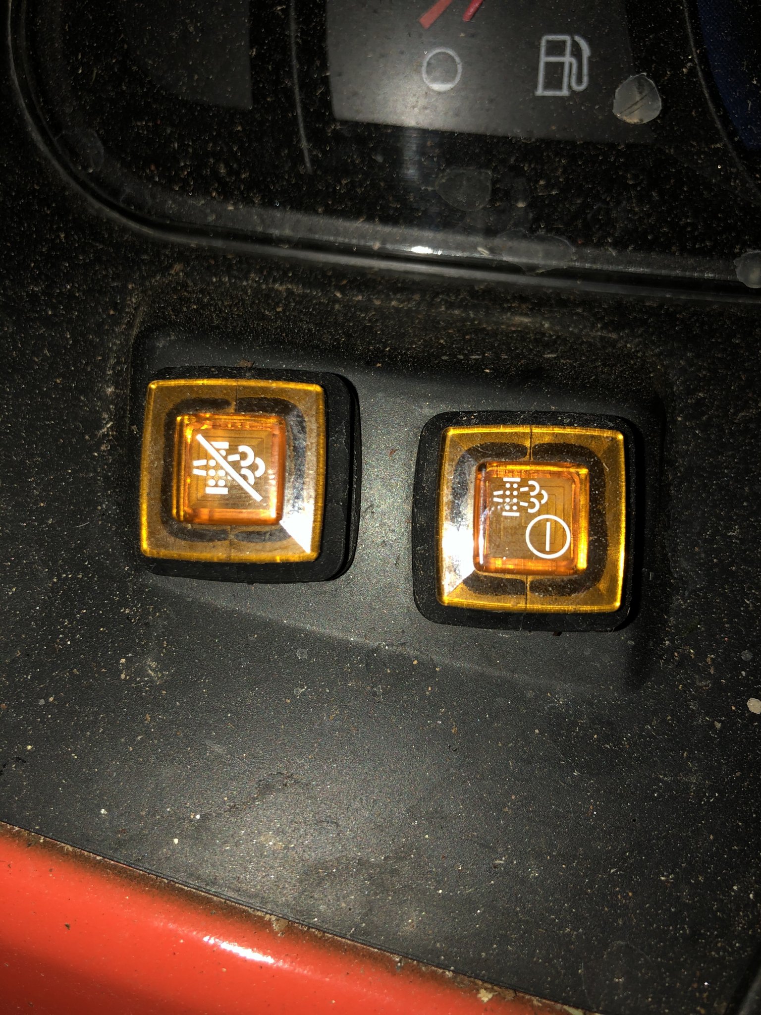

This is what my dpf lights look like.

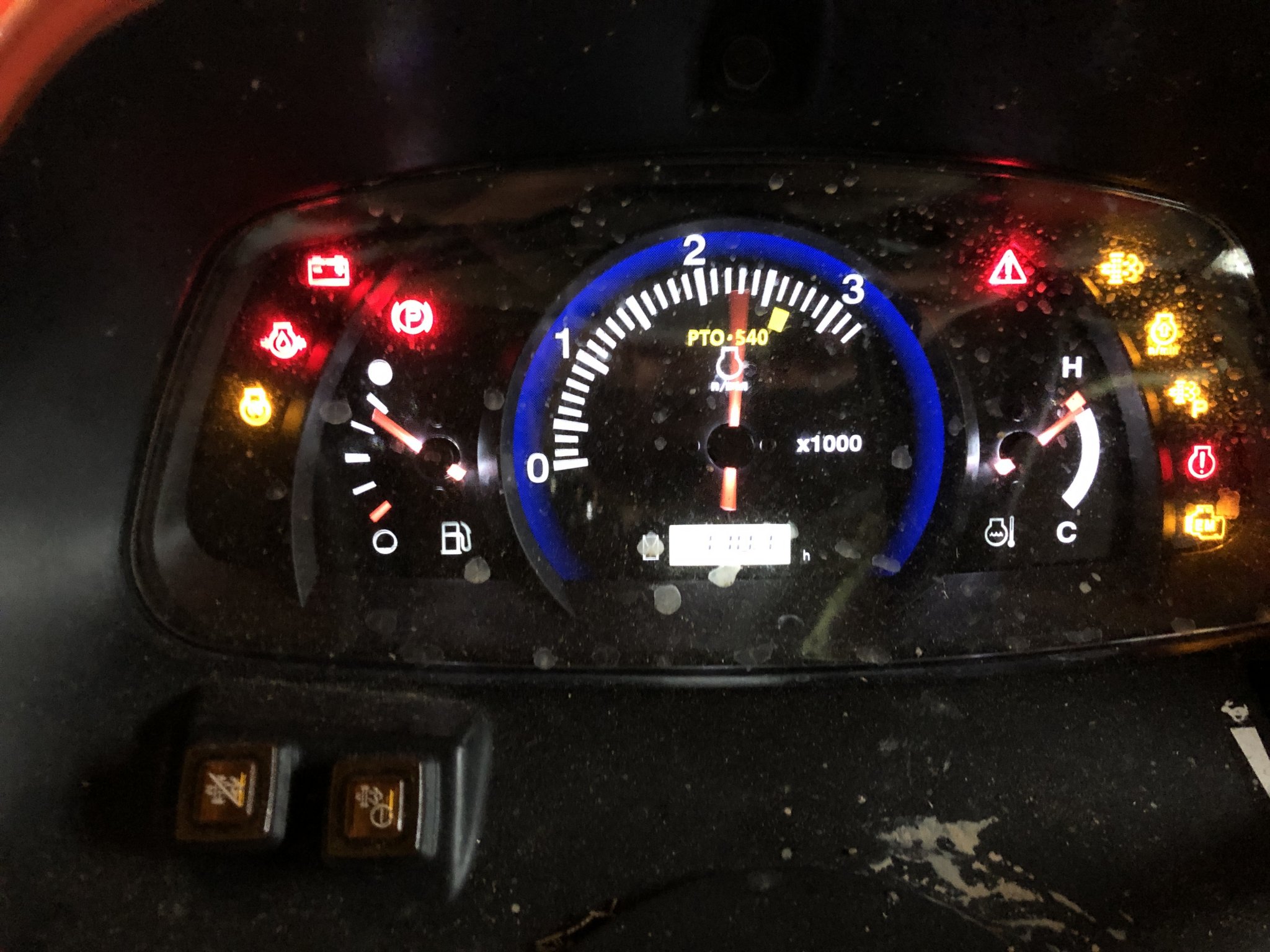

This is what my instrument cluster looks like (when it’s doing the pre-start light check).
If yours is different the rest of this is probably useless. Took a video but it wouldn’t post, so I’ll tell you about it.
Start tractor. No dpf lights anywhere. Press inhibit button and it lights. Press it again and it goes dark. Shut off.
Restart. No dpf lights. Press inhibit button and it lights. Shut off.

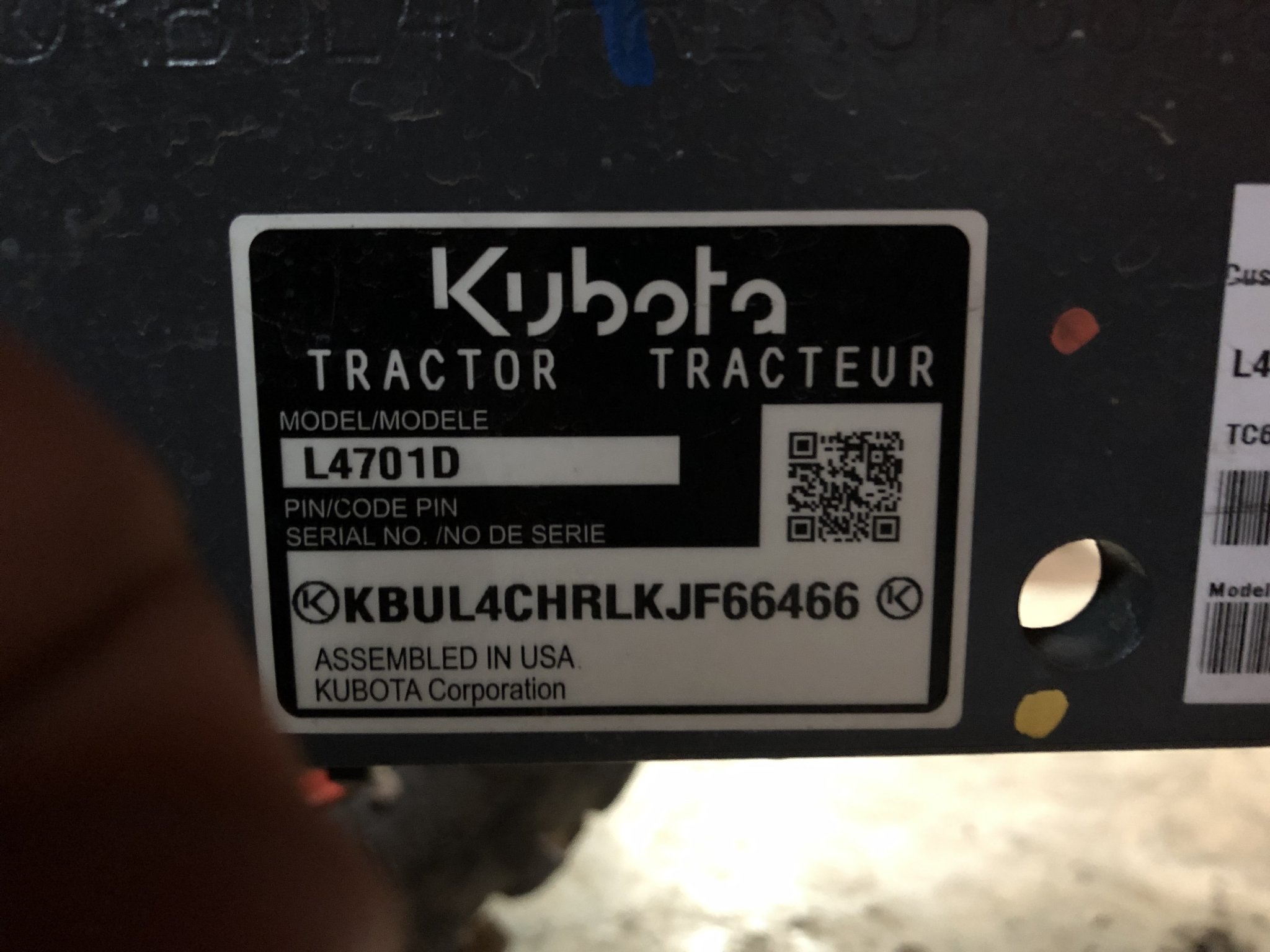

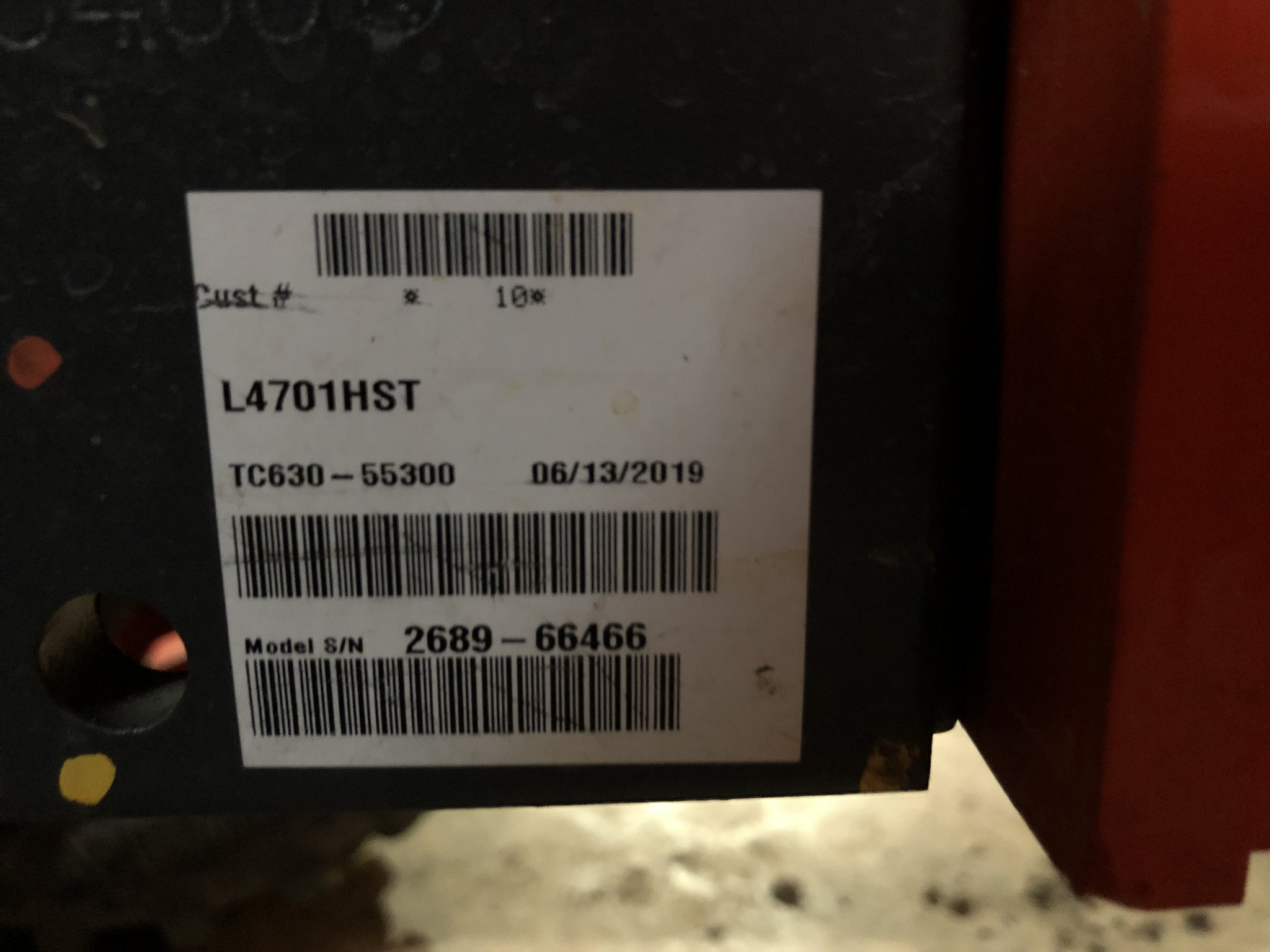

Bottom line, that’s how mine works which is consistent with what is in my manual posted above (albeit in a rather incompetent manner). IF yours is the same, you have a problem. If it isn’t, anything I could tell you is useless. I’ll post a couple more pics of the ID stuff on mine shortly so you can compare if you wish.
