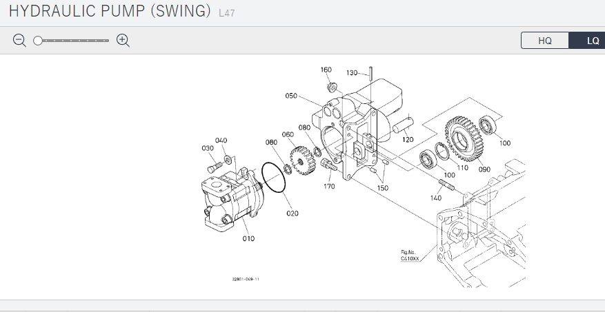

The three point and the BH are controlled by a swing pump.

To check if the pump is bad is the same for just about every pump
Find the pump
determine the input side and then the output side
follow the output side hardline to see where it goes (if possible)
the output line usually goes to some connection point and then a control valve.
hopefully you can remove the hose into the valve that was the output side of the pump.
If there is a quick disconnect on the hose end it should be removed.
Put hose in a large clean bucket
Start tractor and if pump is working then a LOT of oil should be in the bucket.
Do NOT run tractor for long or you can drain out the sump quickly. (If the hose end was put into the fill port of the sump instead of a bucket you could run tractor as long as you want.)
If there is no flow from the output then there may be a suction side problem or the pump has failed.
You can remove the pump and see if the input shaft is broken off if it is not working.
Since your machine is a dedicated TLB all of this may be difficult to remove since it may all be internal to the cases.
