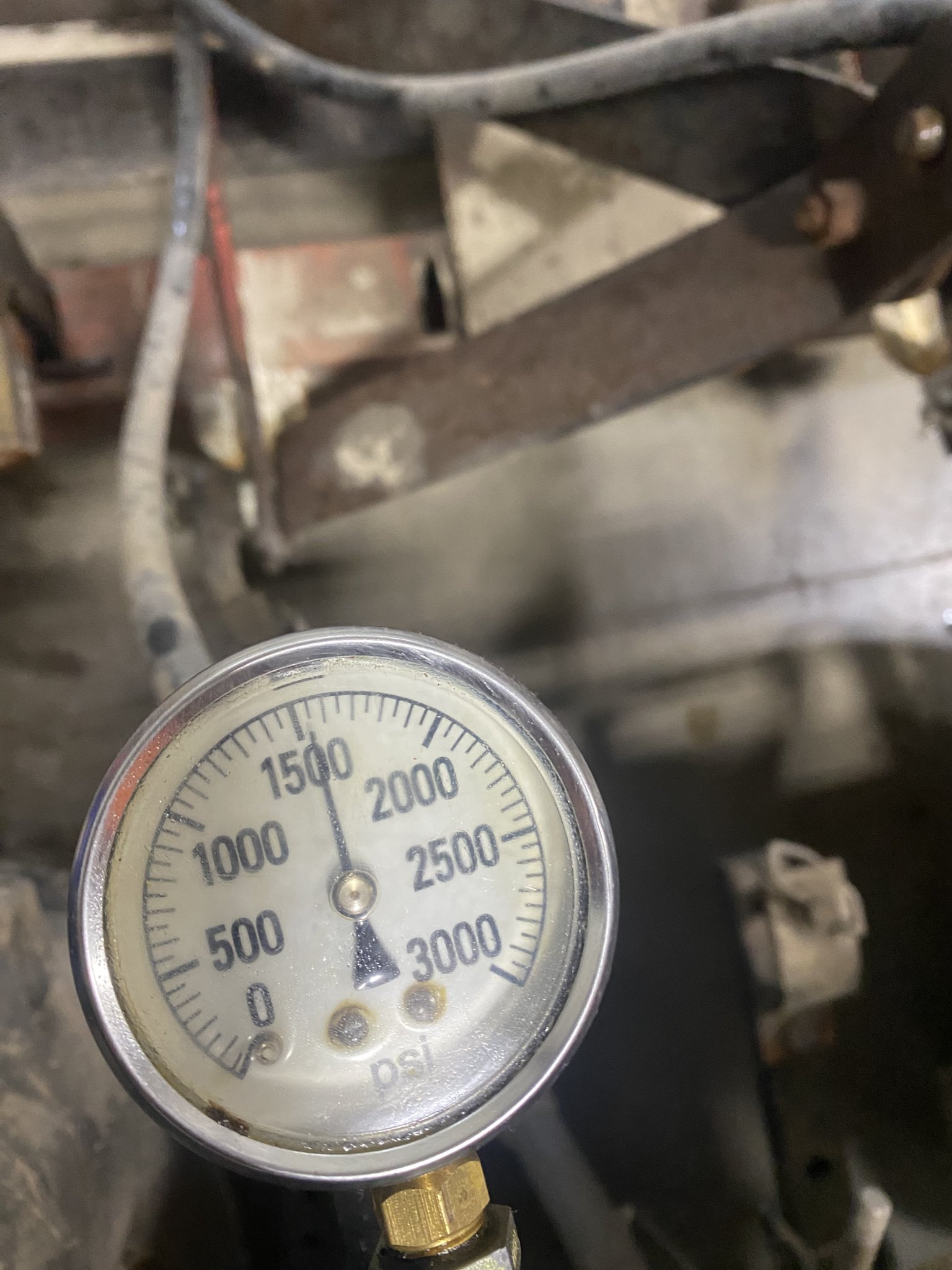

So i have a L4630 and the hydraulic pressure is only 1500 psi, it should be 2500-3000 ish psi. The dealer said the pump was weak so i replaced the pump and no change. They then said it seem fine to them. Any advice on what it can be?

How are you testing the pressure and where?
9,712
5,130
Hydraulic pressure gauge, and have checked at loader valve and remote valve.

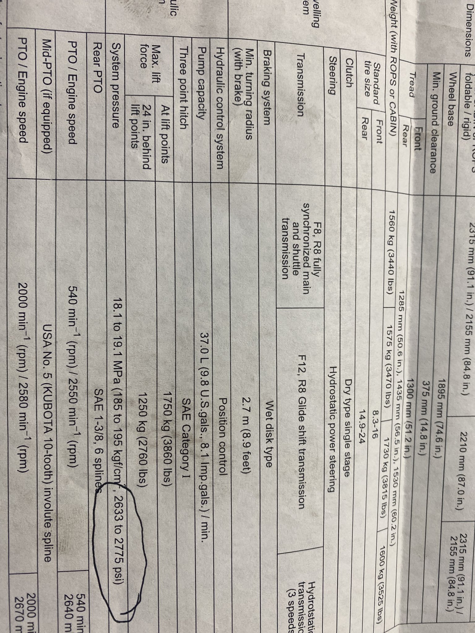

The loader wasnt lifting like it used to, and other attachments weren’t working properly. I have verified from Kubota that pressure should be at least 2500 psi at idle. Replaced pump, per Kubota, no change, changed main relief spring, popet, and spring seat, still no change. Only 1500 psi and any point.

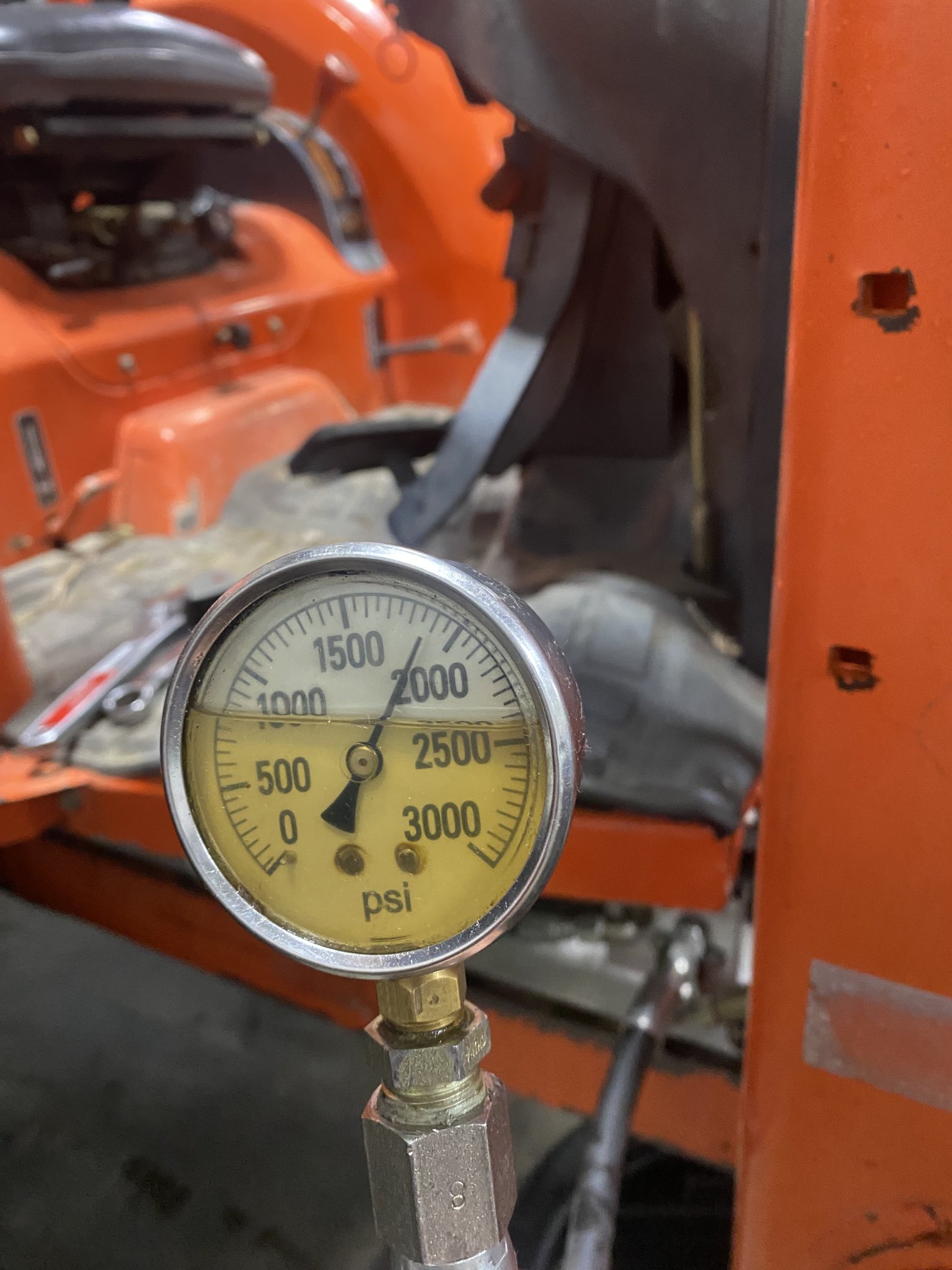

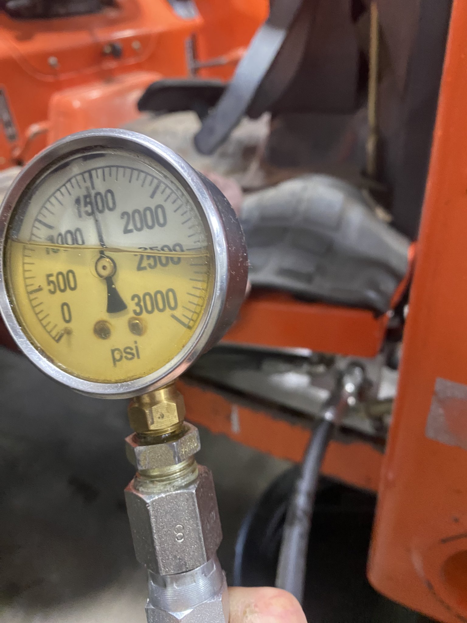

I have a hydraulic pressure gauge and have checked at the the loader valve. Unplugged a hose. Installed pressure gauge, and started tractor and operating that function, then also did the same thing at the remote valve.

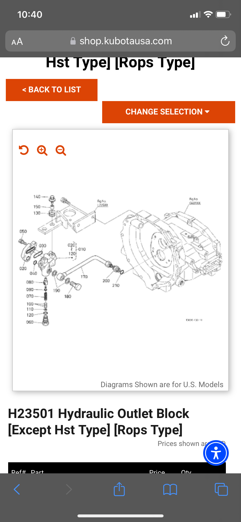

Screw the pressure gsuge directly onto the pump outlet port on the tractor's hydraulic block. Record pressure at both idle and max RPM.
9,712
5,130
I need to hook in to line 170?
No - that eliminates the relief valve and you are not equipped to do that correctly and safely.

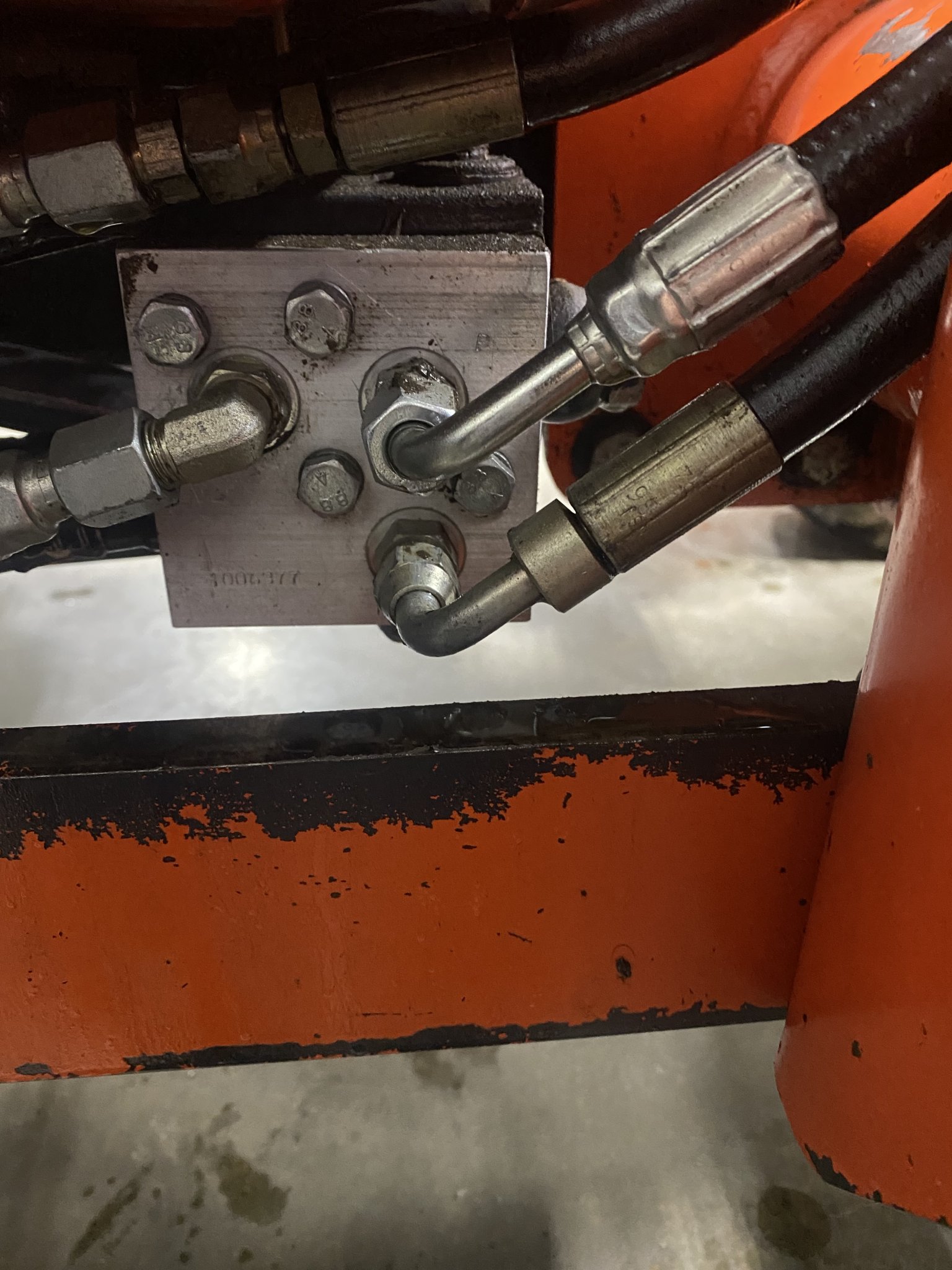

You need to hook into the pump outlet port on the loader outlet block that replaces 020. Post a picture of the current connections for help identifying the correct port.

Top right hose in first picture. Disconnect the hose and connect the pressure gsuge to the fittung in the block. I would guess thst is a JIC-08 male nipple. When you start the tractor you will be deadheading the pump agsinst the relief valve and you should see that ~2200 PSI number.
