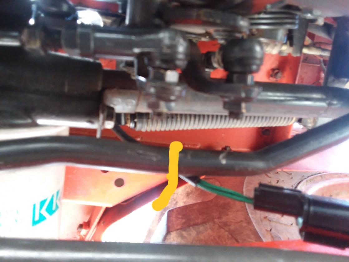

I took the damper off and it is still real hard to push the pedal down. There doesn't seem to be anything else hitting against the linkage. The spring and tensioner did look bent to me so I bent it back to where it looks correct. The pedal seems a little looser now but still not right. I might be getting close.
