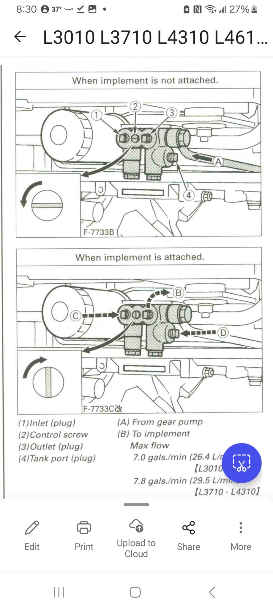

If no flow first thing I would check is to see if the selector valve on the hydraulic outlet block is in the loader position. If it is I would then verify the hose is connected to the pump port on the outlet block.

I’ll check out the outlet block first thing in the morning. Thanks for the info
Well. You sure earned my thanks on that suggestion. I had no idea about the select valve. I’m a happy owner now! Also on the bright side, I was able to repair several other potential issues while trying to sort out the hydraulics. Thanks again
