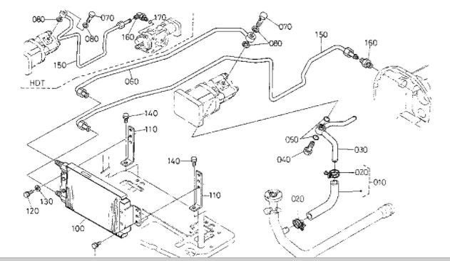

Which line and fitting are you having a problem with?
Looks like the cooler lines are a simple flared compression fitting.
rbargeron
Jul 6, 2015
1,182
259
western ma
In the diagram tube 60 uses a banjo-type fitting at the pump end - which should be re-used if it's undamaged. The tube's flare-fitting end should be cut off and replaced with a new extension hose. See edited post above.
