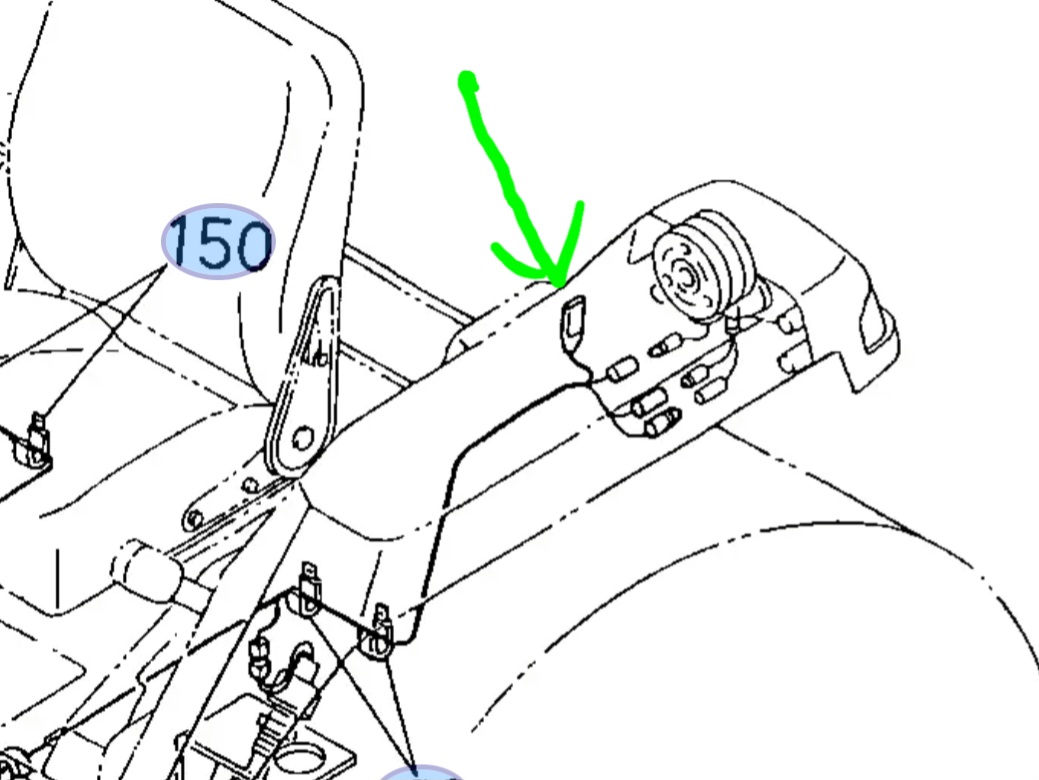

Is this flat connector supposed to be grounded (attached)? It's just hanging under the fender right now. Also, the safety switch above the left axle under the deck is disconnected (clutch or trans, not sure yet).

It’s unlikely that a “flat connector” is to be grounded. It’s more likely it’s to be connected to a receptacle… or a “spare” receptacle which was optional equipment/perhaps never installed.
If you test it’s contacts or wire for “current” and is found to be “hot” then it is likely the latter.
Grounding it might blow another fuse.
These “harnesses” were designed to fit several different models with different optional-accessories. Don’t be surprised to see some of them unused.

Diagnosing wiring issues is always fun (not). You need a wiring diagram and a fair amount of patience. Work your way from source to load doing continuity checks wherever you can break the circuit apart.
The flat connector you speak of is most likely for connecting a rear work light. It should show 12V when you have the ignition switch to on, then nothing when when off. If you ground it then turn the ignition on, you will blow the fuse that protects that circuit.

FYI.. Kubota generally uses BLACK as their GROUND wire colour code, so if those rear lights have 3 wires and one is BLACK, it probably goes to 'ground'.

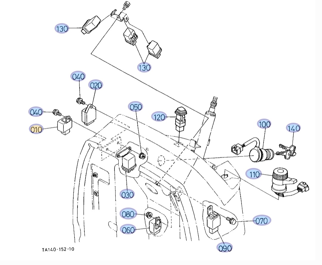

Good idea. I managed to find a wiring diagram online, so things make a little more sense now as I dig around in there. Between that and parts schematics I may be able to figure this out.
I'm really starting to think that it's the turn signal switch based on both right & left being hot when the switch is in neutral. By hot I mean it would barely illuminate my tester. Also, when I would switch it to right or left, the power to that wire would shut off, not get stronger. On the other hand I don't know what the switch is supposed to do when activated...
