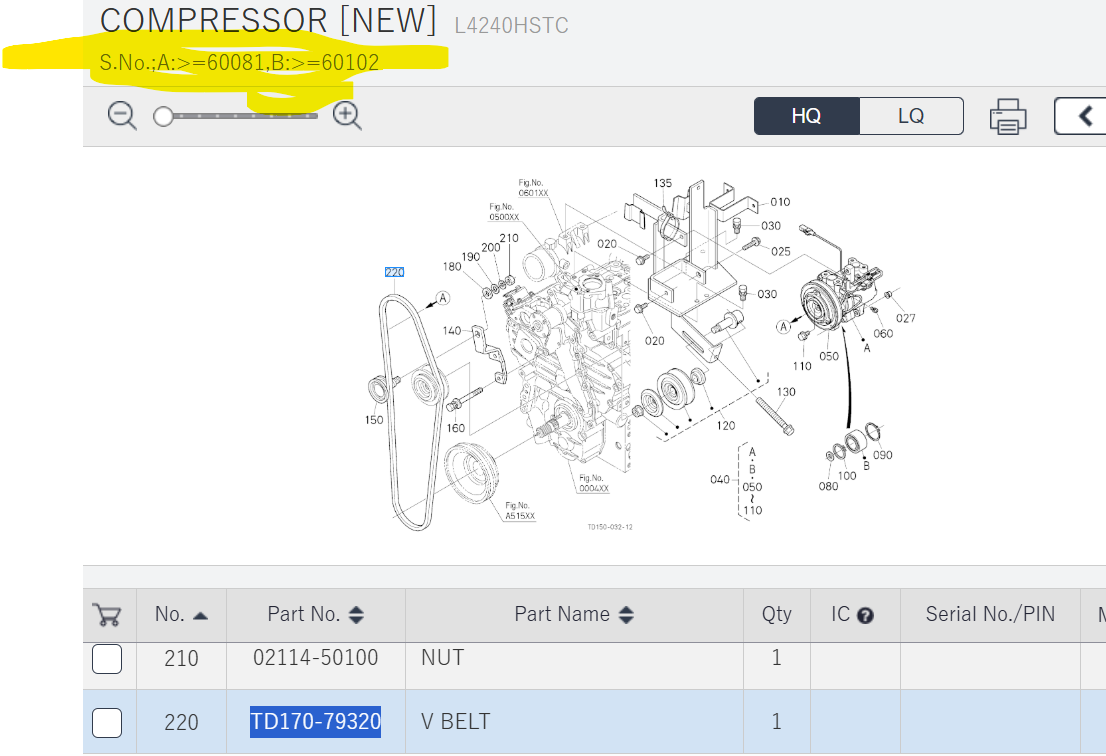

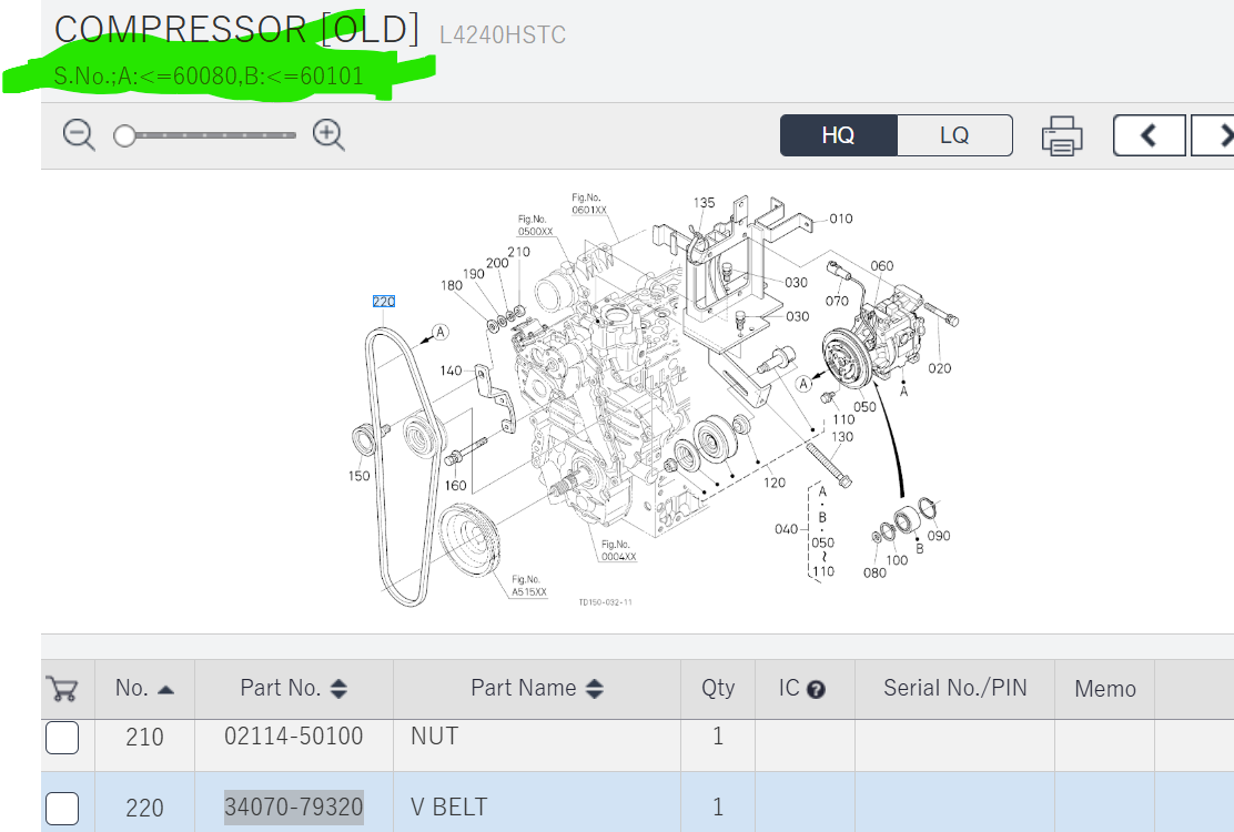

B Baldric New member Equipment L4240 Jan 15, 2022 18 2 3 Devon, UK Jun 15, 2025 #1 Does anyone know the part number for the air con V belt on the L4240 tractor? Been looking for hours and cannot find anywhere, nor can I find a parts list manual! Thanks

North Idaho Wolfman Moderator Staff member Lifetime Member Equipment L3450DT-GST, Woods FEL, B7100 HSD, FEL, 60" SB, 743 Bobcat with V2203, and more Jun 9, 2013 33,466 8,745 113 Sandpoint, ID Jun 15, 2025 #2 These are for a L4240HSTC If you have any other variant the numbers could change. The L4240 also has sub runs of -2 -3 -4. Last edited: Jun 15, 2025

B Baldric New member Equipment L4240 Jan 15, 2022 18 2 3 Devon, UK Jun 15, 2025 #3 That's a great help....my variant is FST not HSTC and is a 2013 model. I hope they use the same belt. Thanks again
