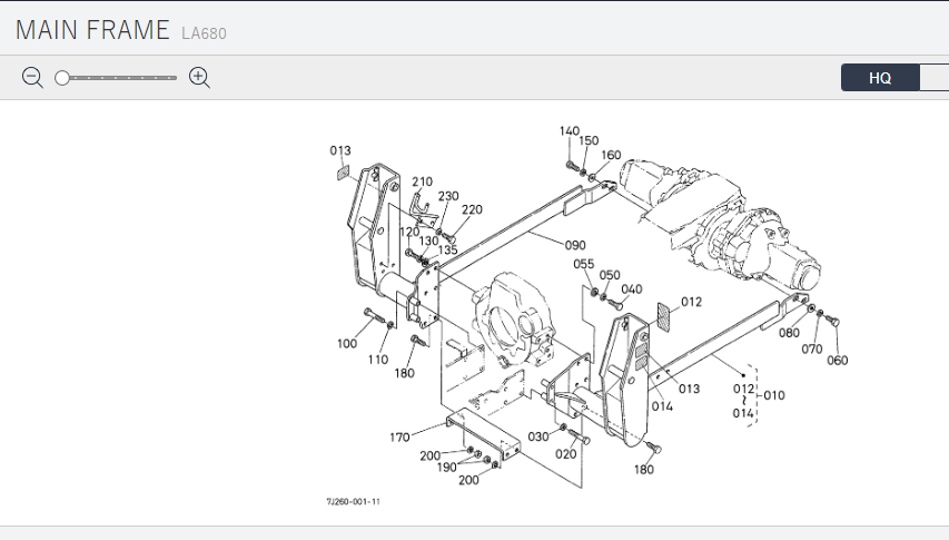

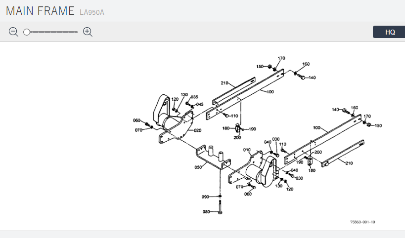

We are putting a front end loader on our L4200 to move mulch with. I don't really know much about loaders. I think that a LA680 is the standard loader, but I can't find one for sale within 500 miles or $4000 dollars. I have found a LA950 loader with the right size bucket and all the valves and hoses for $1500. Would this fit or could it be made to fit? If not, what other loaders would fit?

There were two options, the LA680 and the LA681.
And sorry no the LA950 won't fit without a lot of rework, it was designed for a much older tractor.
Look at Wood's or Westendorf as alternatives to stock.

When you say rework, how much fabbing would we need to do to get it to fit? I have someone who enjoys welding and will do it for free.

What you would need to match, la680 for your tractor.
What you would get with the LA950, if you get all the mounts!
