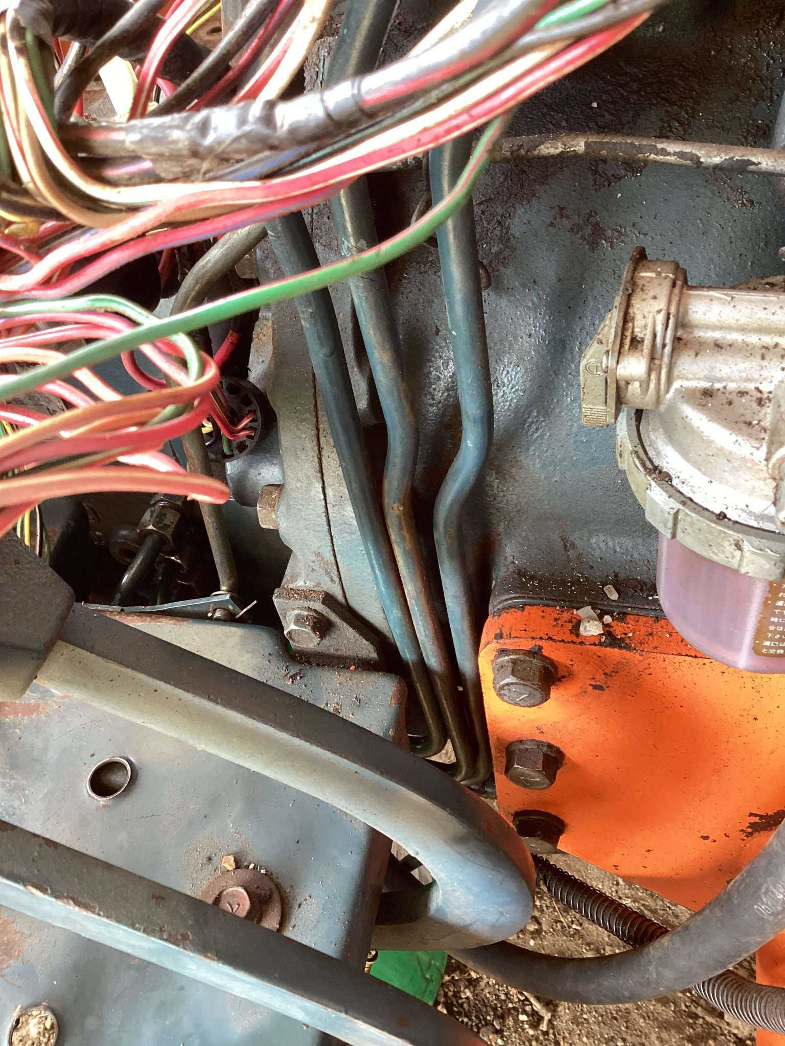

Update: The used hard oil lines came in today. @Nicksacco thank you again for locating those. They’ve seen some use for sure and someone was a little rough when they pulled them off the donor but I got them installed. I like how they fit tucked in between the bell housing and subframe mount. No rubbing on the throttle or brakes like the hoses did:
They shift MUCH smoother too. Diameter of the hard line is a fair amount bigger then the 1/4” hoses. No leaks after a test run. The fittings are compression that Had mated to another machine. Normally I wouldn’t reuse those. But some teflon tape on the leading edge of the compression part did the trick. Some folks don’t recommend that. Not sure why it wouldn’t work. Time will tell.

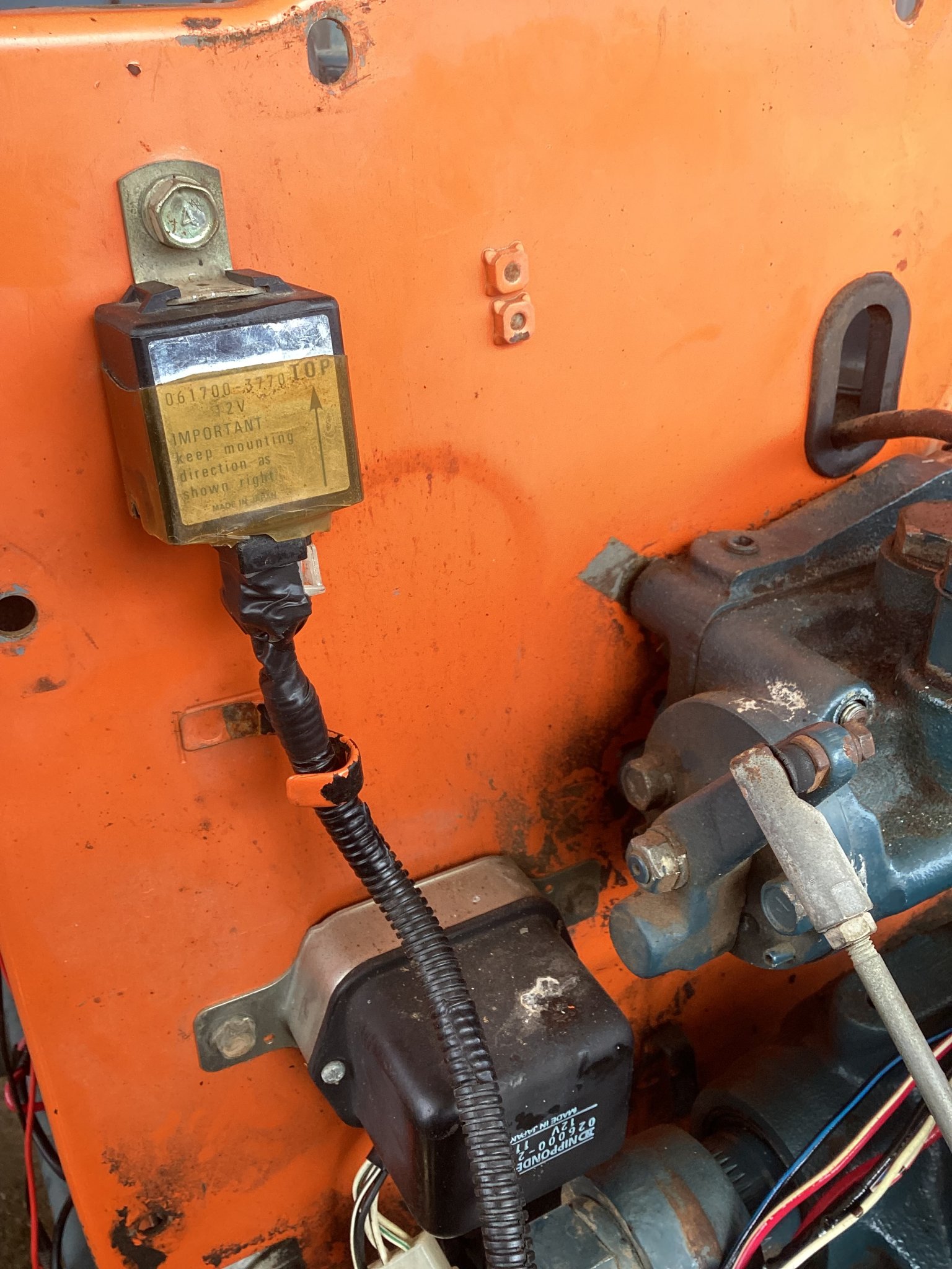

Spent a little more time on the electrical testing today. The fuel cutoff solenoid is good, but the timer is bad. The relay is stuck it seems.
I removed it and gently beat on it to see if it would free up. And it did for a few times, but then quit again. The part is $200 to replace so I may have to live with the manual cutoff for now.

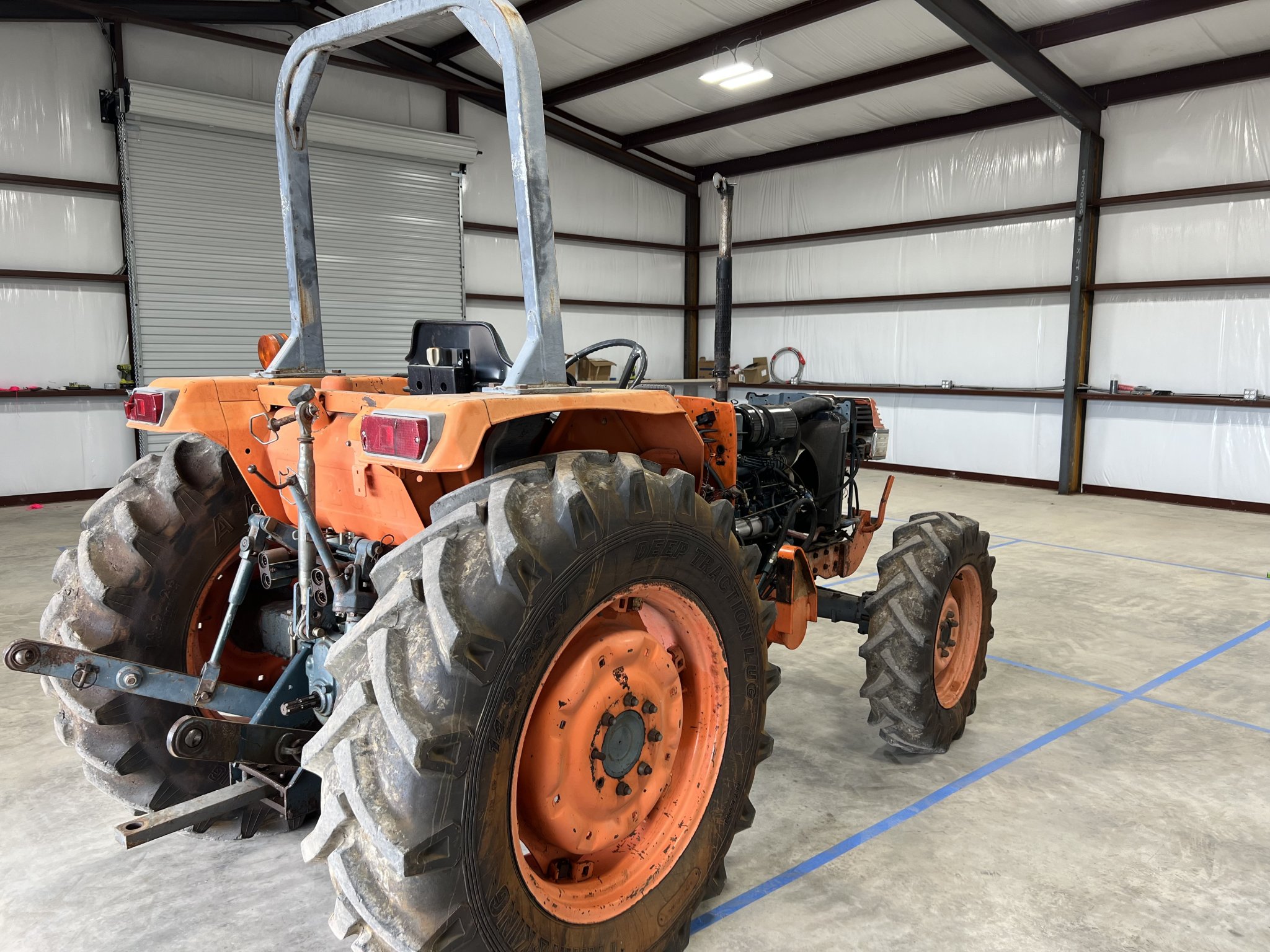

Since we aren’t leaking oil or anything anymore I moved it into the new shop. We are supposed to get some rain tonight and tomorrow. Y’all say a prayer for it, or do a rain dance, or pray while Rain dancing. 🤣
That part number may have been superceded. Denso 061700-3771 may be a replacement. You can find it for $60 or so.
Can you get into the old one and replace the relay?
Oh cool thanks. I’ll check that out. No, unfortunately they’ve got that Epoxy stuff pretty much all over it all.

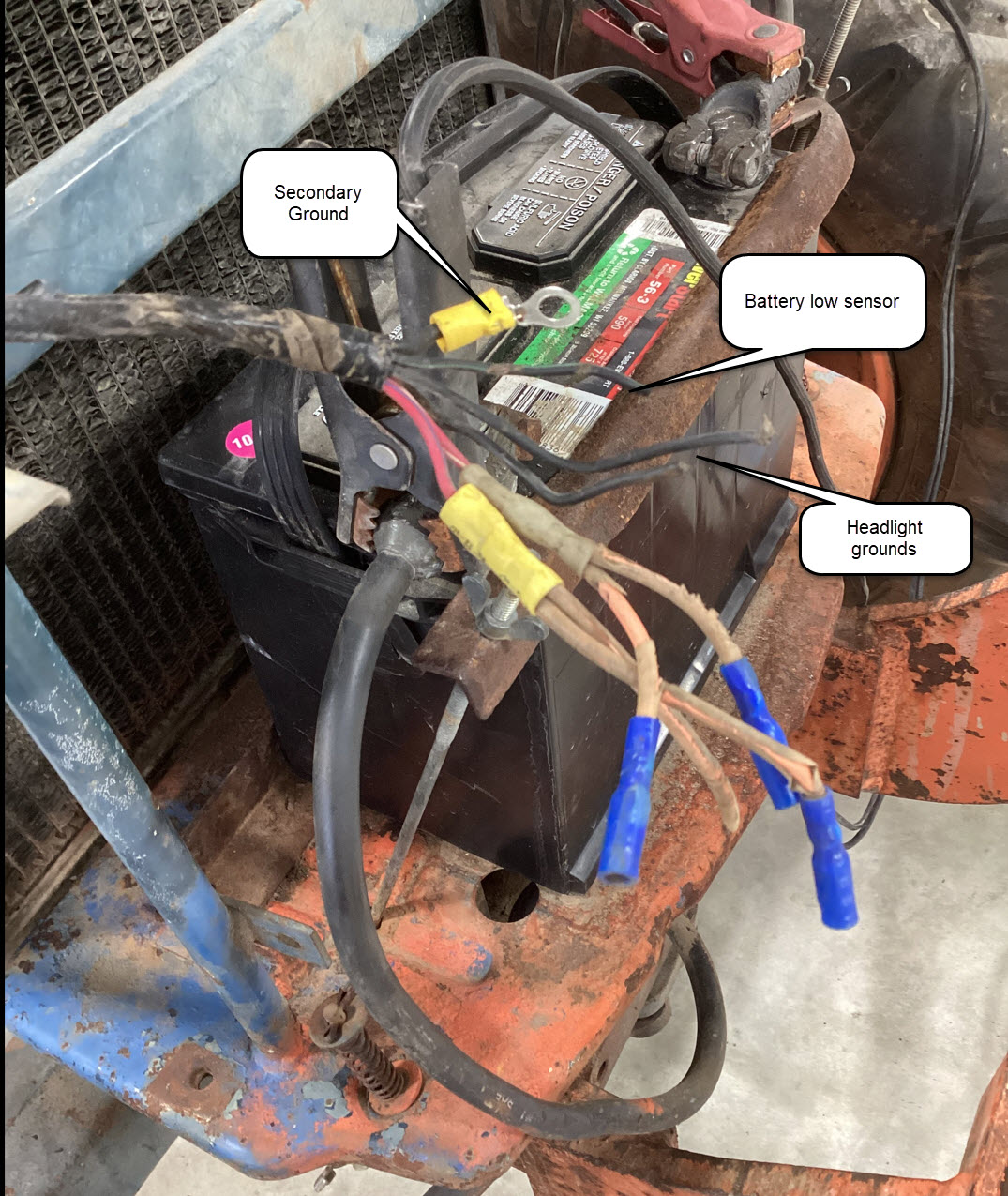

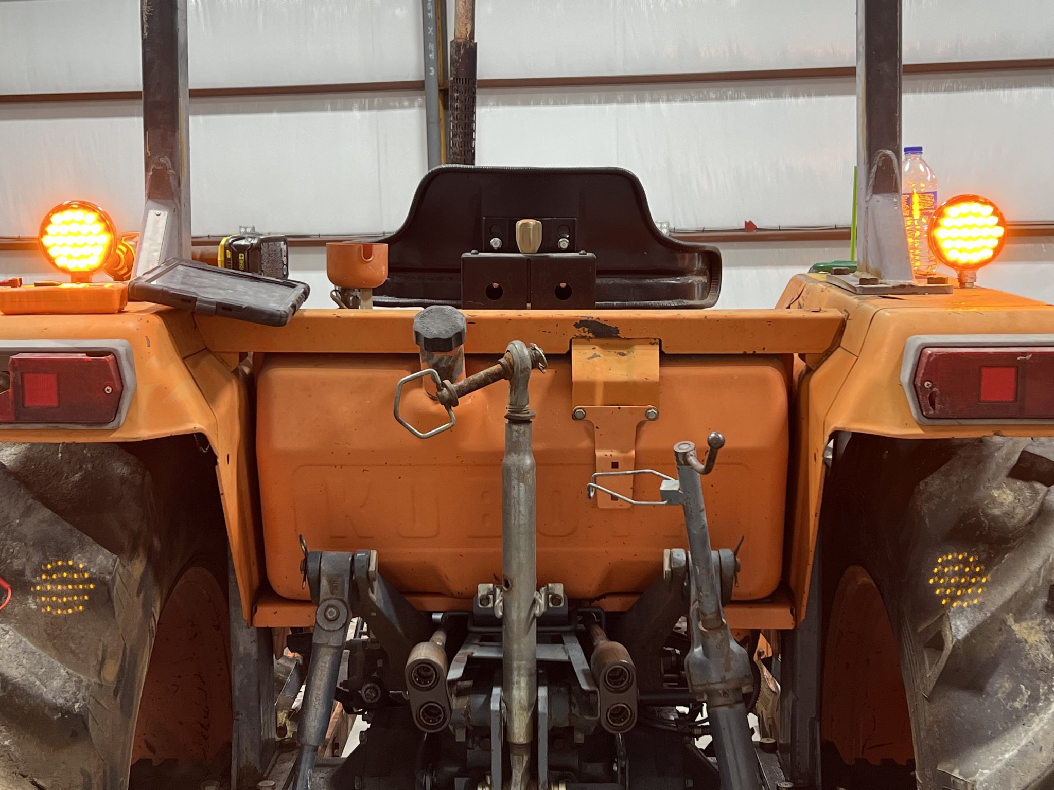

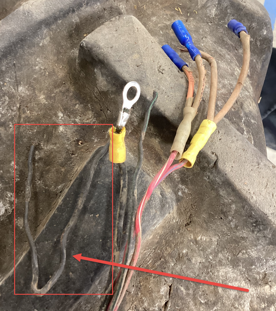

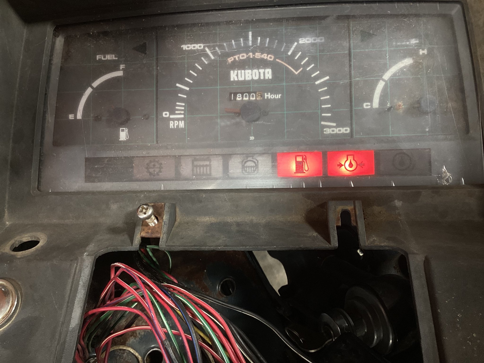

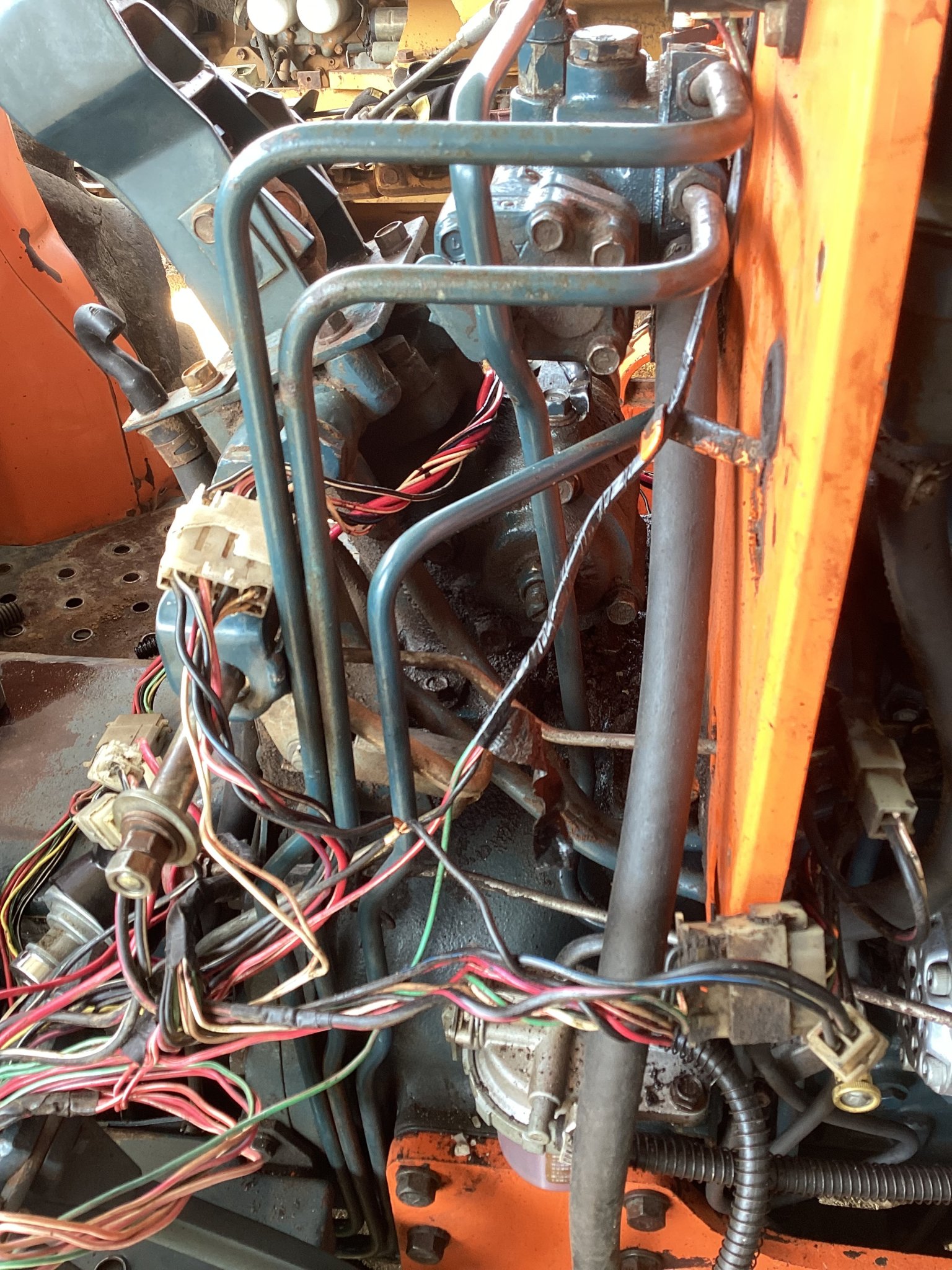

Update: Still going through the electrical procedures in the WSM. Found more modifications made due to the switch issue. a couple of ground circuits also cut off at the harness. The hazard unit is indeed toast but just about any flasher should work as a replacement. The stop relay is toast. Looks like Po’s find mIght work tho (thanks!). And thankfully the voltage regulator, fuel sender and alternator check out fine.
I also made my way through all the sensors And they all check out too. got the new Vacuum sensor installed on the suction line. It’s not pulling the vacuum I’d expect from the ohm readings. We’ll see how it does when I get the suction line o-rings and rubber sleeve changed out.
The biggest challenge for the electrical (besides the previous mechanic) is the dash. Outside of the starter and lights, everything electrical has to do with the dash and it’s just not in great shape. The gauge needles are missing and the lights are old style twist on the circuit board.
chased my tail on this for an hour or two. Just not good solid connections anymore. I considered drilling holes in the plastic light caps and putting led’s in there, using the wires instead of the board. Given the state of the gauges I’m also considering getting rid of this and doing a flat dash with a gauge kit.
Be interested in what people think.
And here’s the small victory for today (hazard lights). Goodnight y’all!

Wow! Good stuff!
I'm so glad you got the pipes and sorted out the electric! Excellent!
Funny, my tractor's key switch didn't work either and once I got to the electrical portion of the work I found out a standard relay was used - no timer at all! Ya gotta love used and abused equipment. :LOL:

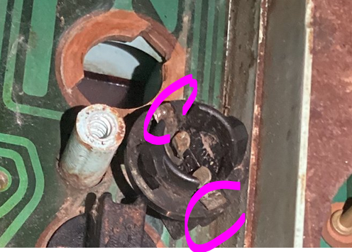

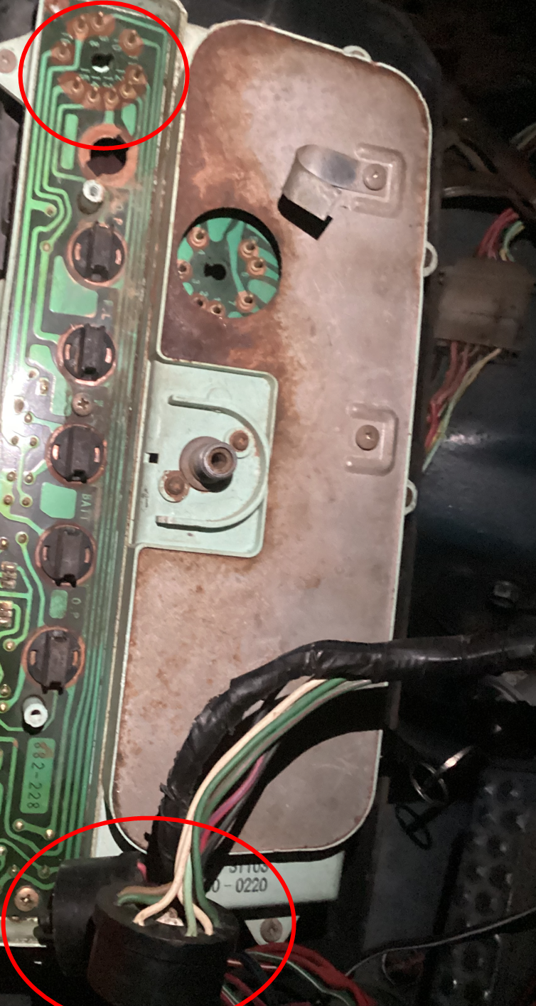

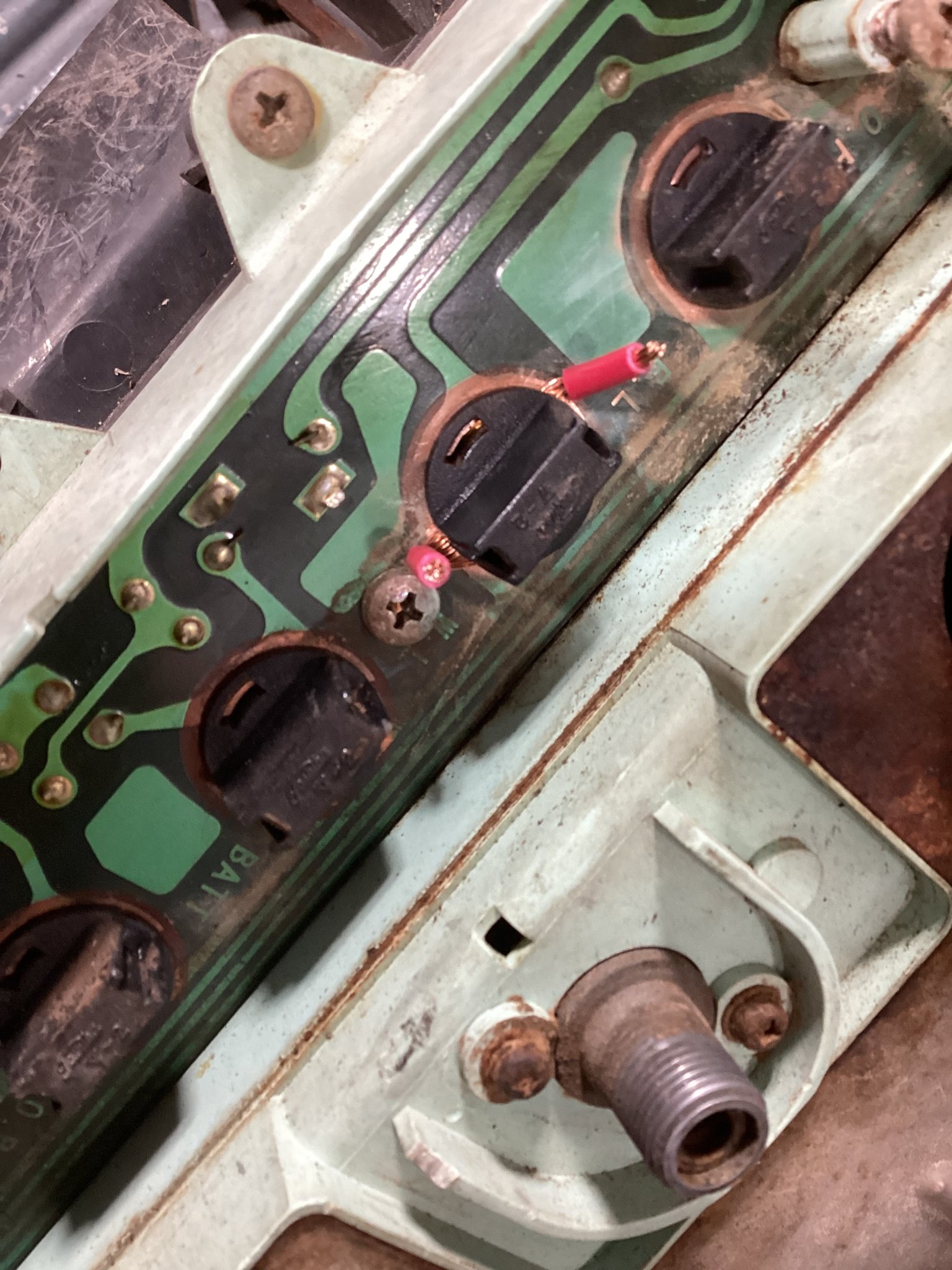

Update: ok, so where to start. I guess with the gauges. Since the bulbs werent making good connections I had an idea, at least for a test. I took a couple of pieces of wire just to use as "Brushes" for the bulbs contacts...
It worked pretty well and we actually ended up with some dash lights...
It was great to see those finally, however, it was still intermittent. As soon as I started to pick up the dash the lights went out. Went round and round with them and at the end of the day, the plug is not making good contact with the pins either.
I can test the wires all day long and they are good and the circuit performs as expected. But not the connection to the board, or the board to the lights. Not sure how easy or hard it will be to get into those plugs. After that discovery I set it aside. Still seriously considering using LED indicator lights on the original dash, and connecting directly to the wires. Will do some more thinking on it.

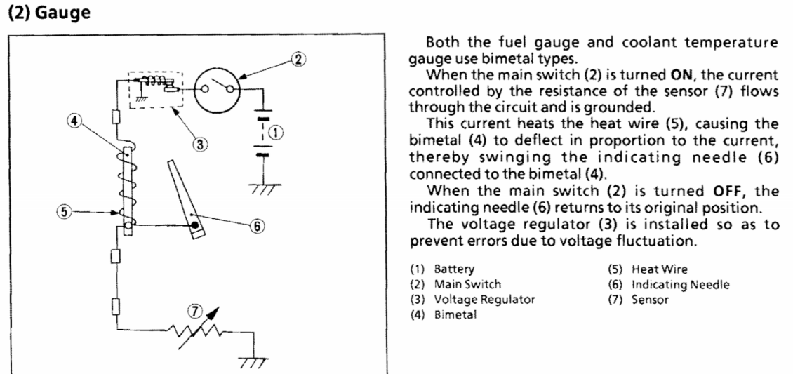

So, more dash related stuff. I reinstalled the thermostat, and tested the coolant gauge on the dash. It actually functioned well, getting up to halfway and holding there. And going back down as the engine cooled. There's a little nub of needle left, not sure if you can see it very well in this pic.
Fuel gauge...I originally thought the fuel low sensor worked because the light came on and the fuel was low, but after I filled the tank halfway with diesel, it still didn't go out. The fuel gauge is also not working (or the sender isnt) because the gauge never moved from half. I think the sender unit as a whole is bad...when i went through the gauge test procedure, the result was as expected...but the sender unit test failed.
From there I pretty much tested every circuit front to back. The oil pressure sensor, I checked while not running, then while running, etc. Through all the circuits. Everything is wired up in the harnesses to the dash/key/lights switch/Fuse panel as it should be now. So on to the headlights...

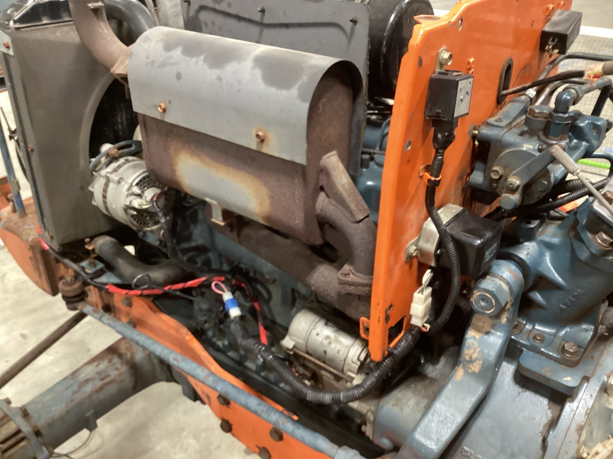

This is what we were starting with. (as a side note I dislike battery retaining bars that are on the same side as the terminals. so I flipped the battery, cleaned off the frame and main ground lead, and moved the lead to the left side. ...back to the headlights...) The wiring diagram shows 5 wires up front. Secondary circuit ground (not frame ground), ground for headlights, battery low wire, low beam, and high beam.
I was figuring out my approach because I wanted to leave the original wire colors showing if at all possible. So I started de-looming the wires...and this...the headlight grounds were just a "V'd" wire taped into the harness going nowhere. bizarre.

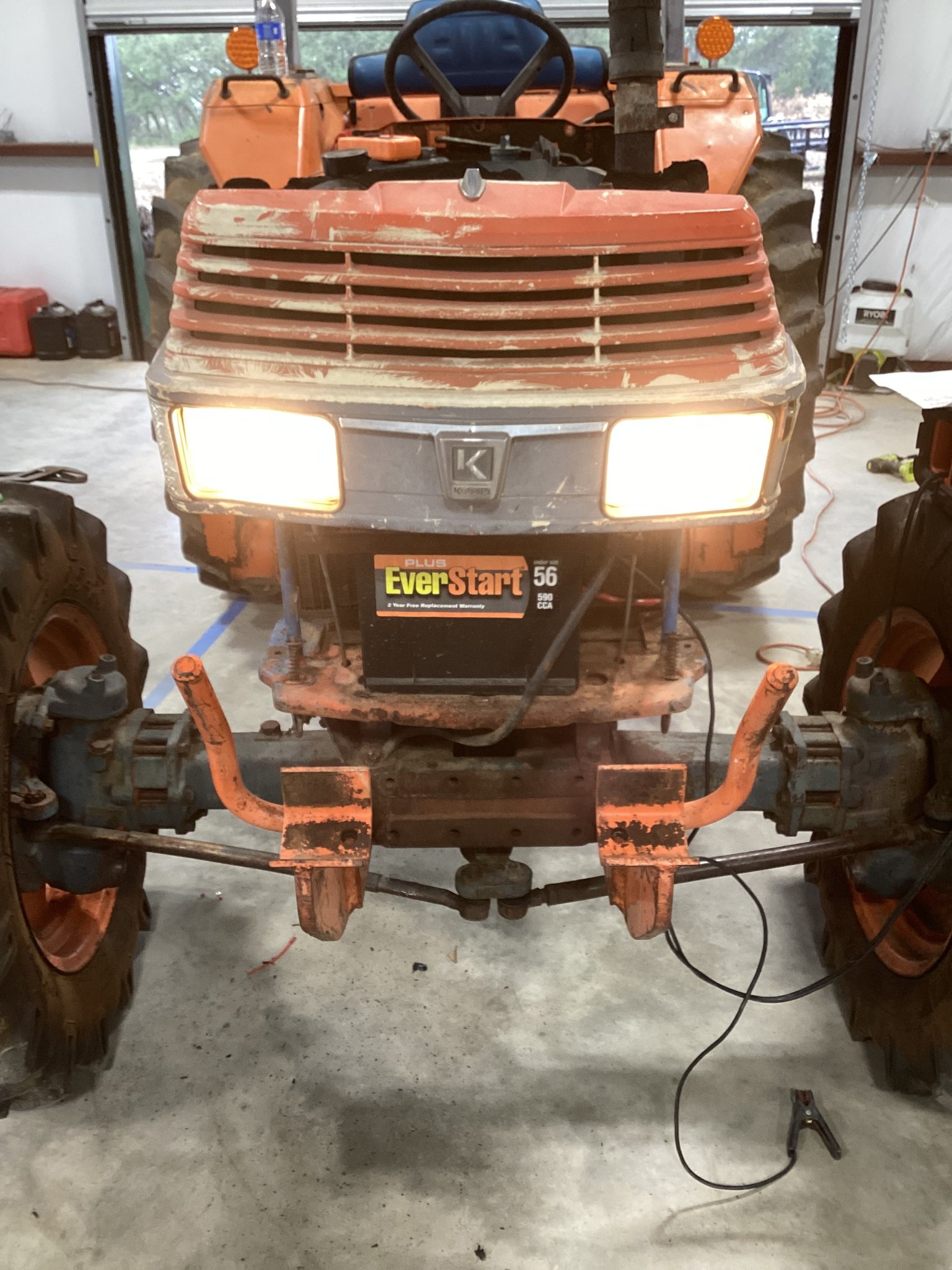

Anyway, glad I de-loomed it. Got the lows and highs wired up and....
With that done, everything Electrical from the firewall forward has been tested (except the glow plugs) so I put harness 1 and 2 back together. I still need to make them pretty, I'm just not sure how they are routed from the factory. Especially the harness going around the radiator. I'll finish the loom at the firewall when those two harnesses are ready to go together. And the blue and white plug in the middle of the right harness is the coolant reservoir sensor...but since there is no reservoir...
And the left side... That blue and white plug is the "Fusible link". Glad this half is done...

As for the dash, whatever you do, don't try solder on the circuit board. Those copper tabs on the light sockets don't look too bad from here - are they corroded and broken off? Is the plastic toast?
I was wondering if you could add a drop of solder with a needle tip iron to the socket's circuit board contacts? Then you could file the drop down to adjust tightness. Also, add a bit of dielectric grease.
As for the multi-pin socket - what is the condition of the contacts? can you bend them back to be tighter around the pins? Is there some kind of bracket that holds the socket to the board? It appears that there is the ole' typical "bend a piece of metal around the wire" thing. Well better than nothing - add some heat shrink to it
