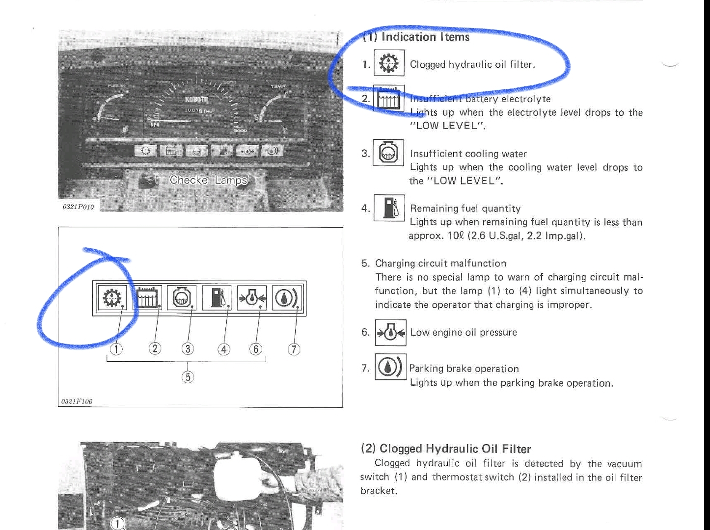

What is this "hydraulic warning light"? Thats a new one on me. Whatever it is it sounds like something you should not ignore.
Off the top of my head your 3pt failure sounds like a problem with the internal linkage for the control valve. Mechanical not hydraulic. The behaviour of the lift arms is normal.

The L3 models of that time have an "easy checker" in the dash that indicates when the hydraulic oil filter is clogged (or nearly so). I'm assuming your L4150 and my L5450 have similar parts - although the main pump on the L5450 is mounted in front of the engine
There should be a vacuum switch and a thermostat switch at the inlet port of the hydraulic pump that affect the light

Yes sorry that's the one. Here is a pic for reference.

That was my first guess. I reckon I was hoping it could be something different so I wouldn't have to dive into it that deep. Thank you Sir
