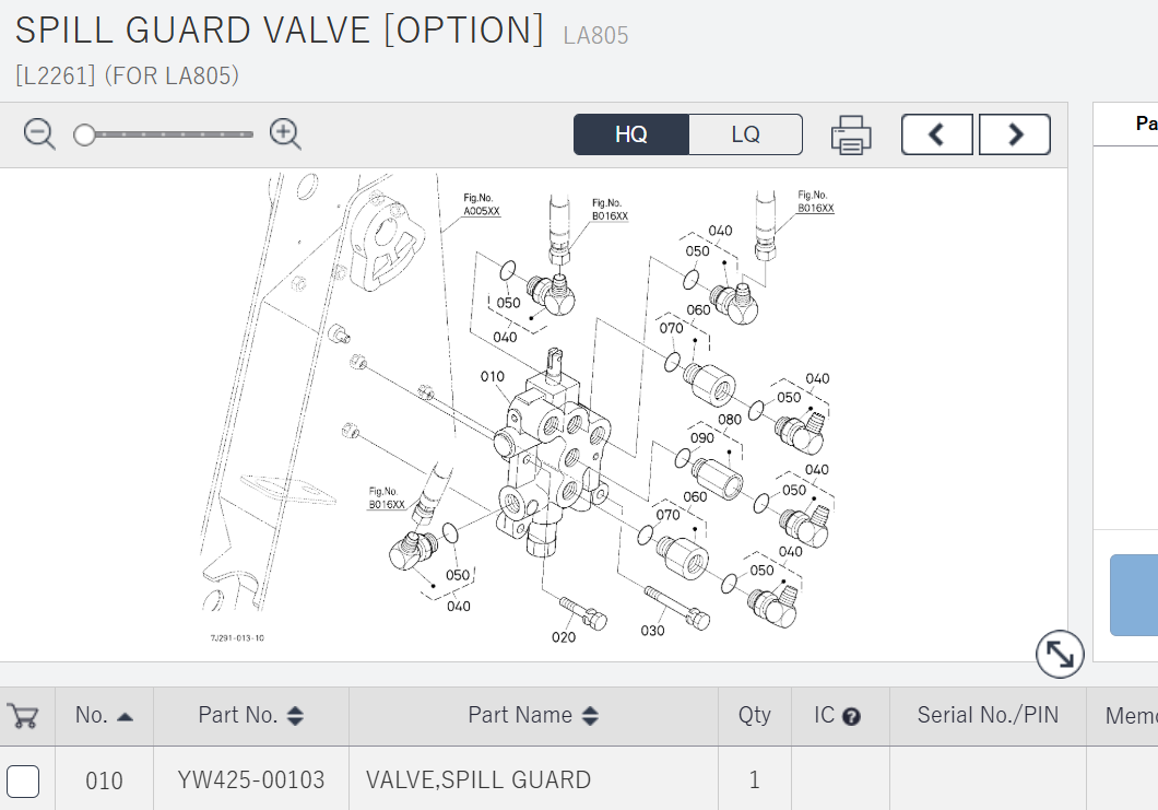

I want to use a platform on my pallet fork attachment so I can have someone elevate me a bit to help trim some branches and I am curious about a mechanical self leveling kit for my LA805 loader (to keep my platform level as it is lifted or lowered). I've seen self leveling kits for the smaller loaders (LA535 for example) but cannot find anything for an LA805. Can anyone confirm there isn't one or have I just not found it yet? I'v also seen hydraulic versions for larger loaders but I'm not interested in a hydraulic version.

I think it's called a spill guard valve on that loader.
Verify with a dealer that this will do what you want.

On my TL720 (L35) it's called self-levelling parallel linkage, but it functions as a spill guard. The linkage is physically connected to the control stick gimbal and you can feel it push the stick if you lift it past a certain point with the bucket curled. It wouldn't do what you're looking for.
From what I've read, people like the leveller with forks but not with a bucket. You'd probably want a way to disable it. In any case, what you're asking for would be pretty complicated.

I saw a video where someone was demoing a spillguard on a 6060 and it did not work exactly how you would expect it to. There were some drawbacks with the system. I dont remember exactly what those were but I think it would limit travel even when you did not want it to and it would not curl the bucket back down on downward movement to keep it level. It would only curl it while moving up.
