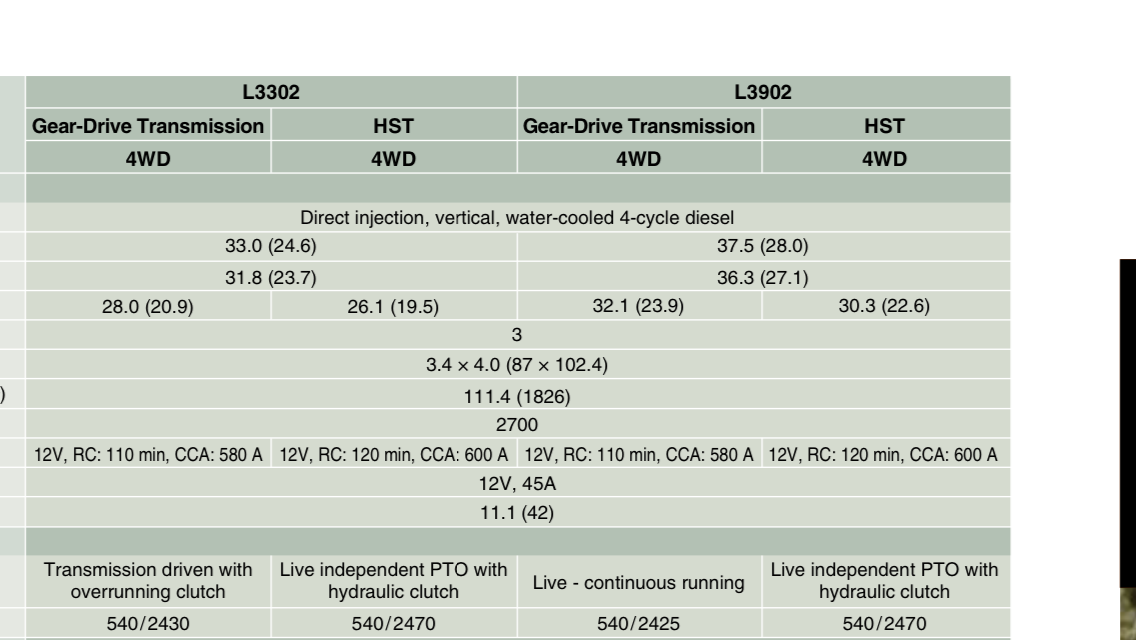

Based on the spec sheet on Kubota’s website if your L3902 has the gear transmission the PTO is “live continuous”. If HST transmission it’s “live independent with hydraulic clutch”. While “live continuous” is engaged/disengaged by the clutch, it isn’t transmission driven so the rotational inertia of an implement can’t backfeed into the transmission to push you after you disengage the clutch to stop the PTO.
For comparison, note the spec for the L3302 gear drive which is “transmission driven with overrunning clutch”. Being transmission driven, an overrun clutch is needed so they built one in as an integral part of the L3302 gear drive.

What does 'live continuous' mean? If it doesn't have a separate clutch, couldn't power still backfeed into the transmission?
2,947
4,614
Uses the same clutch to engage/disengage but it isn’t transmission driven (that’s the “live” part) so it doesn’t backfeed the transmission. How exactly the mechanics of that work, someone else would have to answer. I’ve never owned or operated a tractor with that type of PTO.

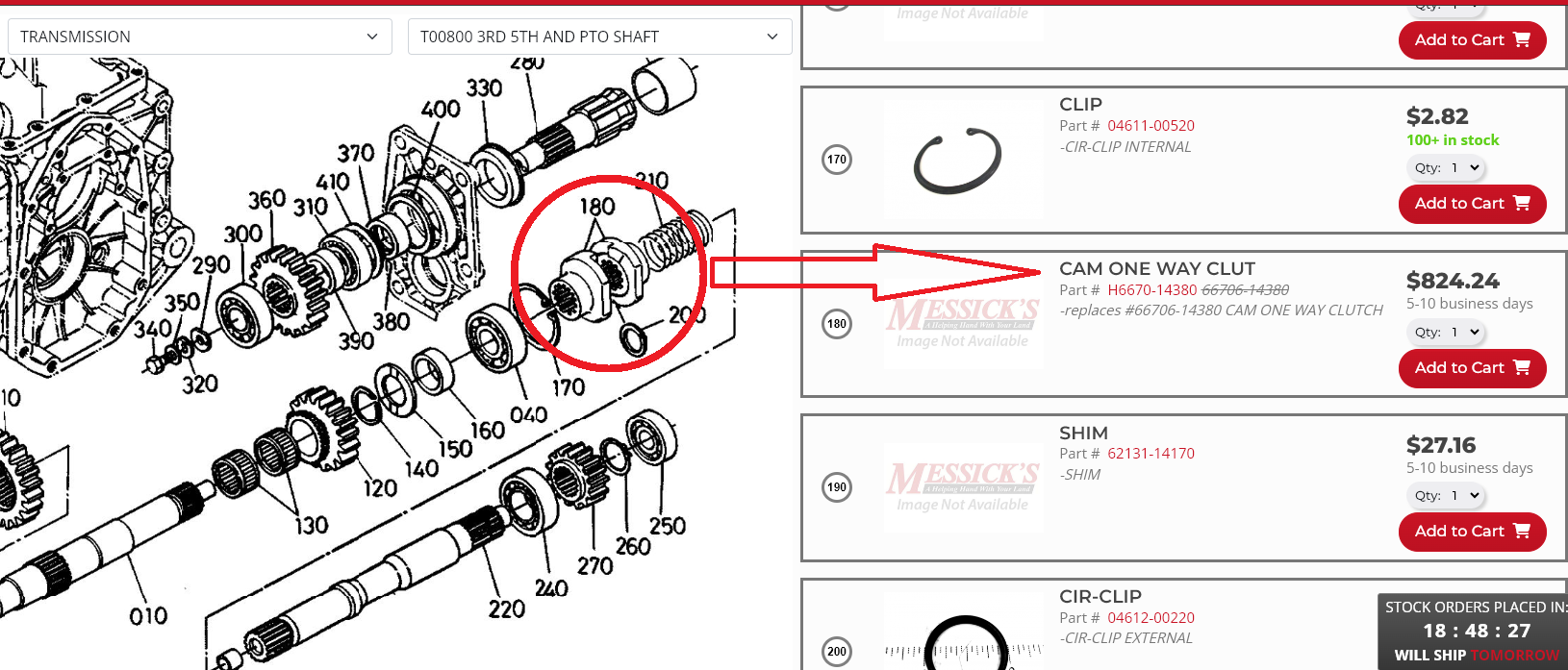

The PTO on my 1980s gear drive B7200 is transmission driven but it doesn't back feed because OEMs got smart around 1960 and started putting one way drives in the PTO itself.
