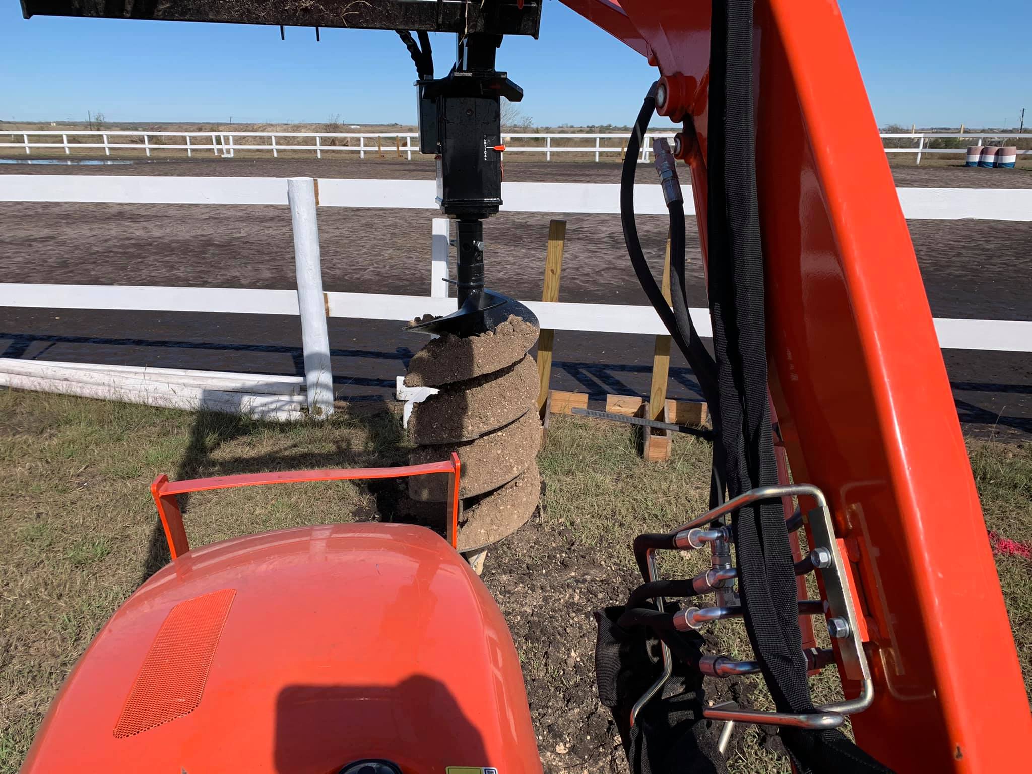

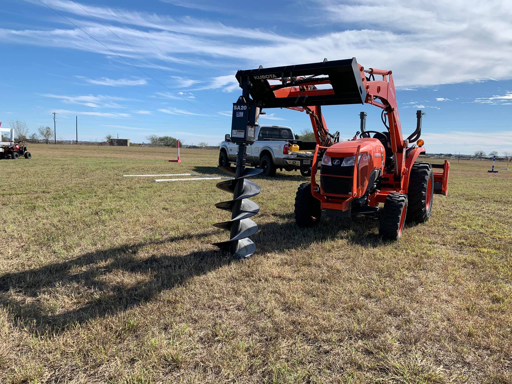

I ordered mine with the Land Pride 3rd function valve and I have no complaints so far. These are only the 3rd and 4th holes that I’ve dug with it, so I’m sure with a bit more practice I’ll get better at figuring out when to float and when to add pressure.

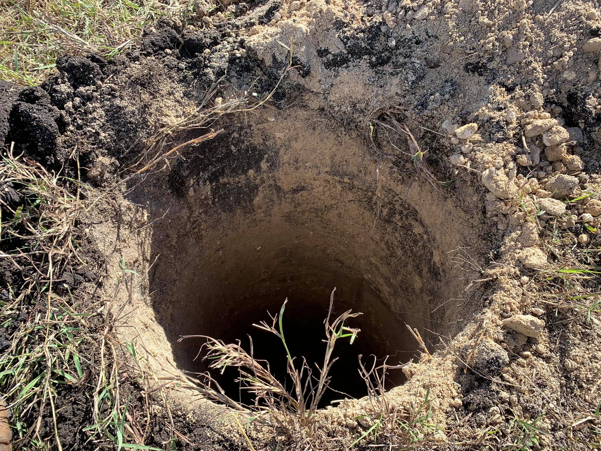

It turns slow, but it does the job and it’s way easier than using a 3pt auger. These holes were 4’-5’ from a fairly large tree, so there’s lots of roots that the bit is chewing through with very little complaints.

I used this to dig some 18" holes yesterday. No problems at all.
View attachment 51455 View attachment 51456 View attachment 51457
If it was mine (it's not), I believe I'd have it mounted centered between the loader arms. Too great a chance of tweaking the arms when applying down force wit it offset like that.

A few things there:
1. Having it in the center sounds like a good idea until you realize that you can't see the tip of the bit, so you HAVE to have someone on the ground guiding you.
2. Having it mounted on the side, I can get closer to existing fences/buildings/poles
3. You can put enough pressure on the bit to actually stop it from turning. As such, I typically go light on the pressure, so I'm not too concerned with tweaking the arms.
I usually just have a 9" bit on there for fence posts. I used the 18" bit to dig some 4' holes to form concrete light pole bases for our arena lights. If I were to be doing a ton of large holes in an area where I have to worry about roots or rocks, I'd probably mount it in the center position just for better stability. For what I typically use it for, the side mount works out the best.

If it was mine (it's not), I believe I'd have it mounted centered between the loader arms. Too great a chance of tweaking the arms when applying down force wit it offset like that.......
You need to see it, and you need to get close.
You need to keep the center available for the concrete mixer.
