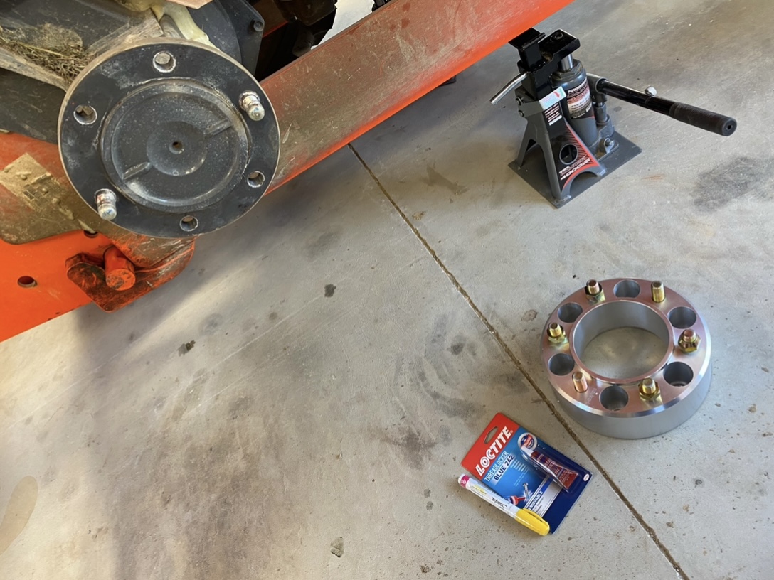

Also on hills—I went with 3” spacers from Bro-Tek on my 3301.
Easy install and good support from Richard there. Other than getting a wider box blade later, there haven’t been any other considerations for me.
Have had them on for three years now—and no issues with the added weight on the back when using my BH77.
FYI—Your fenders won’t stop as much mud coming off the rears and smacking you upside the head 😁 when you get going.

Can’t say whether or not 4” would be an issue or not, since I haven’t had them. The physics tells me it certainly adding more stress to things back there, but no problems so far for me with 3” and my BH77 in that timeframe—which in tractor hours, has been about 800hrs with the spacers on. I looked at it myself as my width (and hence the weight stress) at the back isn’t that far off from someone with R1’s with their rims set to all the way ‘out’.

You may not need to change to larger attachments, since you would about have to have the rears with no pressure in order to leave a complete edge to edge footprint. If I do have any trouble with my wider box blade, it’s usually going up a grade with a full box of rock—easy workaround on the fly with the TNT😁. My Rear Blade would be more of an issue with the ditching I do. I didn’t buy a new rotary cutter-saw no need. With your additional HP of the 3901, I doubt you’d overwhelm the tractor itself before the R4s start slipping on ya.
