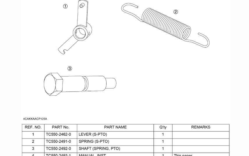

This kit will fix you right up, it removes the coil spring from around the shaft and replaces it with a stronger return spring that connects to the bottom of the control shaft lever.

Parts in this kit:

That update kits looks nice, just hoping there’s a way to get it done without taking both rear tires off.
I’ll keep cleaning out debris around the spring and keep it oiled up until that doesn’t work anymore.
