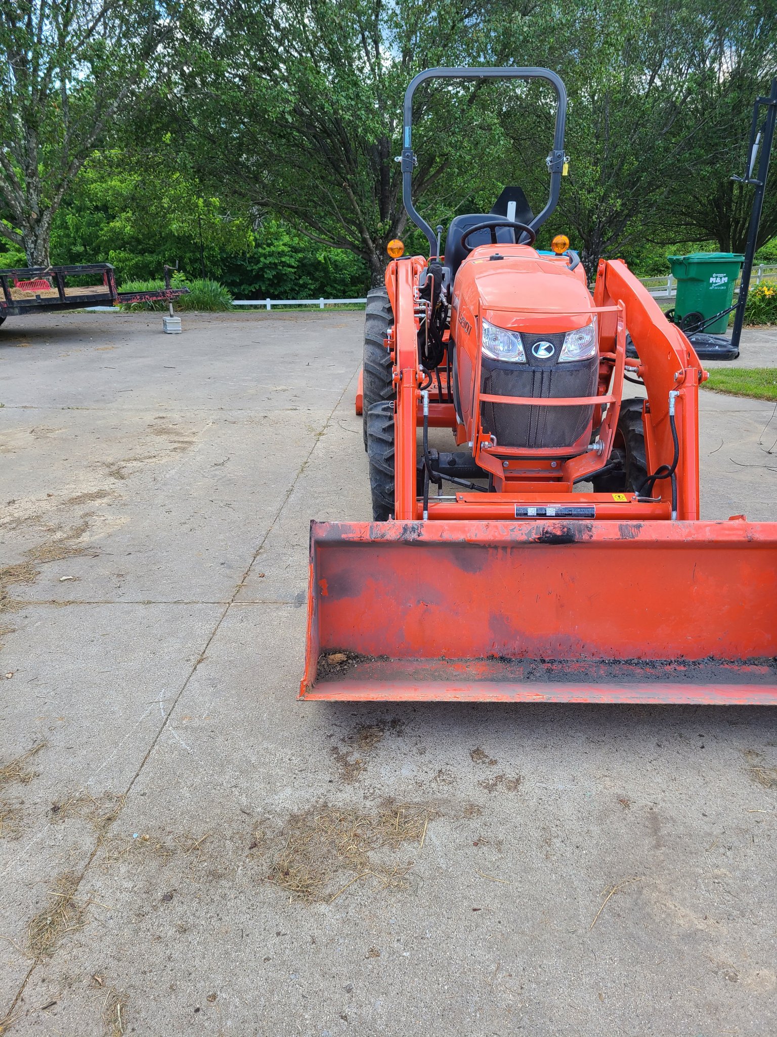

The front right tire seems to be tilted inward. Is there a fix? What needs to be done? Part replaced? Rim does not seem to be bend. very concerned as our land is rolling hills and feels like tractor will rollover. Take look at pictures. any help greatly appreciated. I am not very knowledgeable about tractors.

Park it on a level concrete surface and look at it again. It the picture of the RH side, it appears the front tire is setting in a ditch or wash.

Welcome aboard! Try parking the tractor on a good solid level surface and look again. Hard to tell from those pictures, but it appears the front axle isn't parallel with the ground. It's normal for both fronts to have a bit of positive camber. If your right front wheel is in a low spot where you're parked, it may make the left wheel to be straight up and down.
The front axle pivots in the center and doesn't provide any means of keeping the tractor from rolling. That's the function of the rear (solidly mounted) axle, along with weight distribution. From the pictures it looks like the rear wheels aren't set very wide.

All though the ground looks fairly level in the pics, park it on something flat and then compare the two sides. If there's still a difference, use the loader to raise the front axle off the ground a bit and give each tire a wiggle at the top and bottom to see if there is any play in there or strange noises.

I parked it on level ground and added 2 pictures, see above. I put front tires up, using the bucket, can turn left and right, and rod, like the axle, can move up and down both sides.

Consult your Owner’s Manual. Both should have positive camber (about 2-degrees.).

That's fine but you should raise it again then grab the wheel at the top and bottom and give it a push/pull and see if there is any movement. This will tell you if you've got a bad bearing in the hub.

Caster and camber is not adjustable. It's built into the front axle. Toe is and is adjustable via the tie rod ends. If the wheel 'appears to be tilting, with either rim after swapping them, it's an issue with the bearings (upper and lower) in the potboard casting. Usually, if there is a bearing issue, the knuckle to axle housing seal will be leaking, but not always. it depends on the degree of slop. Easiest way to determine if the bearings are at fault is loft the front end with the bucket and grasp the wheel and tire at the 6 and 12 o'clock positions with your hands and try moving it in and out. If there is movement, you have a bearing (and most likely a kingpin issue). The, grasp the wheel at 9 and 3 o'clock and try to move it again. If it moves in that position, the tie rod ends are sloppy or the radial ram to tie rod adjustment rod is sloppy and will need replaced. I presume your neoprene boots on the tie rods and radial joints are intact and not torn. Torn boots allow dirt into the joints and really accelerates joint wear. The radial (ram to adjustment rod joints are very expensive, boots are cheap comparatively.
Usually, when the bearings fail, the kingpins will also be impacted. Best to replace everything.
You can do the repair yourself (I have) but if you aren't mechanically inclined, I'd have your local Kubota dealer do it.
If there is slop, you'll need the bearing sets, the kingpin, the seals and a tube of Kubota 3 bond to seal the casting surfaces plus assorted hand tools and drifts and replacement lube.

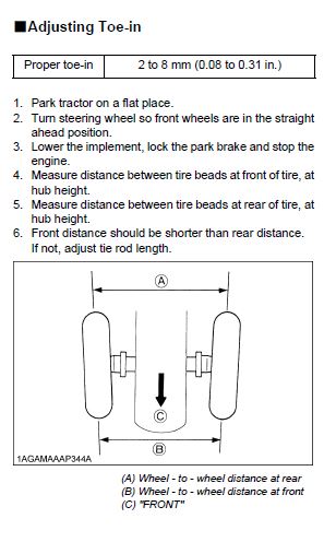

I have a L3901, the toe in is very visible, I don't worry about it as it was like that from new (2 years old). here is the info from the manual:
I have a 2014 L3800 and my front wheels look the same. Never any problems. I remember reading somewhere that the angle assists in turning. I’ve noticed that the angle also slings mud away front the operator when in 4WD.

That angle you see is called camber. It is normal and nonadjustable. Check the bearings. Lift the front wheels off the ground and make sure that you can't move the wheel by grabbing the wheel at 12:00 (top) and 6:00 (bottom) with either hand, then pull out on the bottom while pushing in on the top, then vise versa. Should be zero play. If there is any, you have a hub bearing fixing to fail if it hasn't already, stop using the tractor and repair it before the bearing completely fails and the balls/junk fall down into the kingpin assembly. Once the junk gets into the rest of the hub, you have to replace about everything--it just gets more expensive the longer you run it with a failing/loose hub bearing.
Camber is designed to make the tractor steer a little easier and it is more noticeable on smaller tractors than it is on larger ag tractors. You'll see that most passenger cars have a little camber (but the other way IOW top of tire closer to the body than the bottom is, called negative camber) which helps keep the tire stuck to the road in a curve.

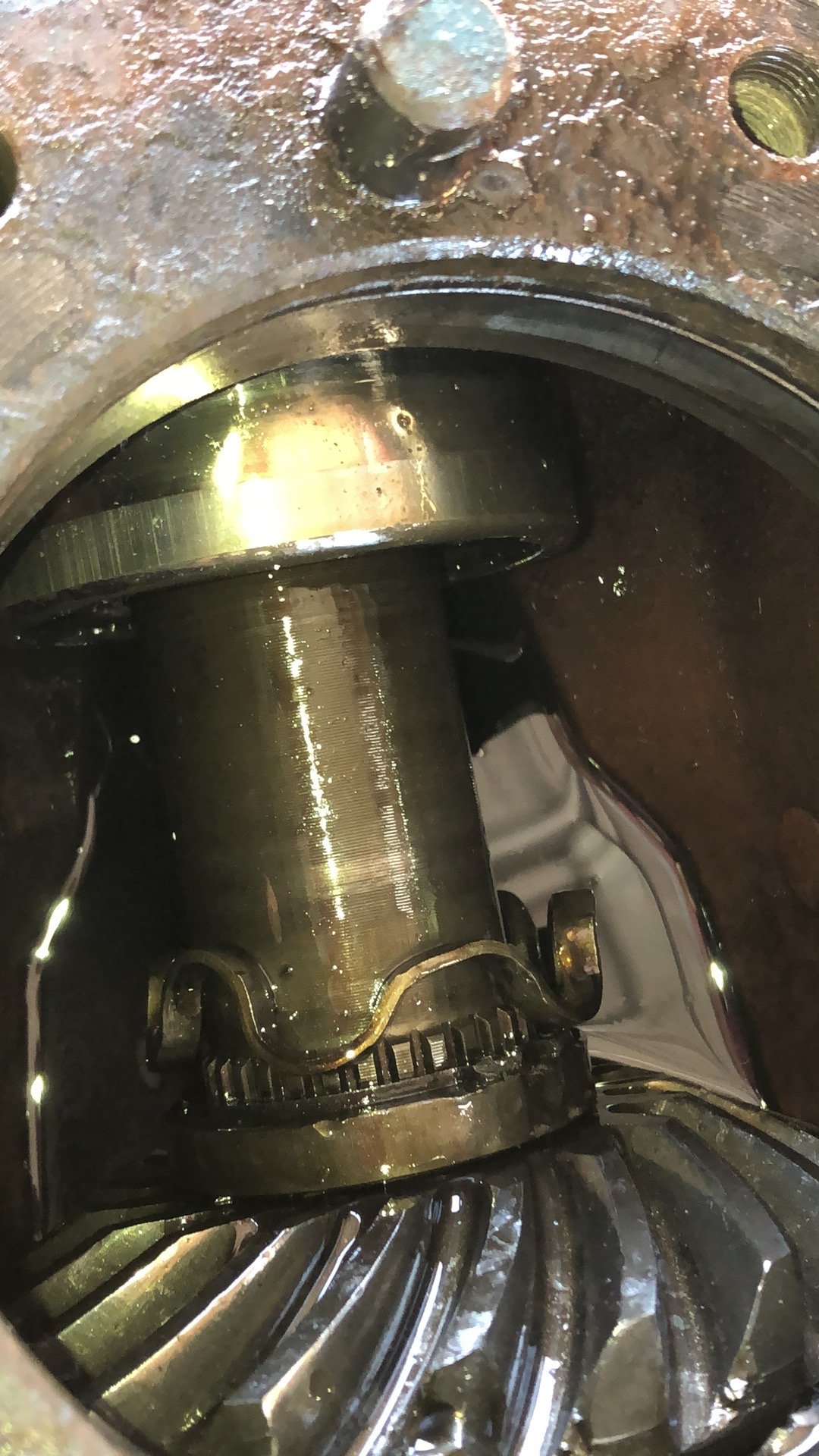

My first hint something was going on was a slight leak. The next was the wheel locking up while moving. Not bad but it would skid 6" every once in a while. It was bad. All bearings and seals and the pinion gear. Parts were over $1,200. I did the repair maybe 6 hours.
