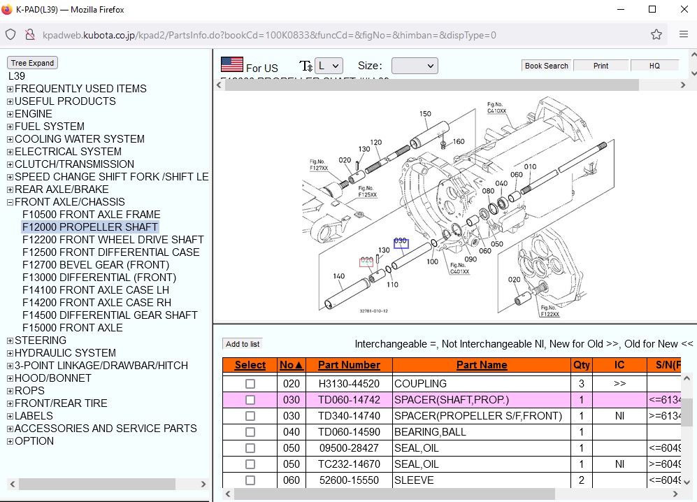

Looking at the parts drawing below, there's a spacer tube going through the clutch housing with o-rings on both ends that will "contain" the trans fluid when its all assembled, keeping the trans fluid from wetting the clutch. I think that "stack" of parts is kept snug in place by packing grease in the cover around the propeller shaft. On my L48 the driveshaft tube is full of grease too, so a small amount of trans oil getting all the way to there can't really mix much with front diff. - or tend to leak out, provided the covers are in place and the seal at the front of the trans is working .

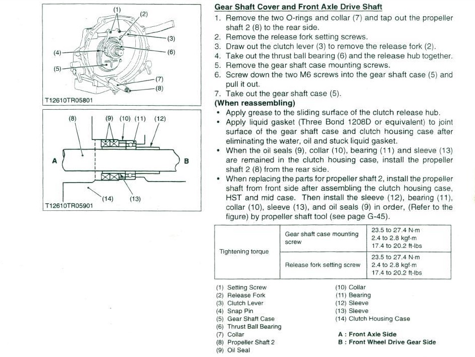

The seal has a short sleeve that sets on the propeller shaft and serves as its inner sealing surface. The tube and o-rings are to ensure the sleeve can not migrate forward out of the seal itself. There should be no grease involved with this setup.
There should be some grease in the splined couplers only.
The input shaft into the front axle has a seal so no oil could mix from the transaxle to the front axle.

I agree that's the way it all looks in published service information. But for some time the machines with front propeller shaft driven by a 30" long shaft coming from the rear axle through inside the clutch housing, the oil seal at the bottom has been an issue. When I took my L48 apart to replace that seal with the updated version I was surprised to see the enclosing tubes continuing to the front differential packed with grease.
I replaced the seals (and sleeves) as preventive maintenance during a split for HST repairs. In reading MikeinDewey's posts, it resonated with what I'd seen that my tractor already had - the presence of viscous grease encasing the shaft. It was clear it had been added intentionally - perhaps to inhibit oil leakage there without the large job of breaking down a TLB to replace a small seal. I put it back together as-found, with a couple of top-up grease gun strokes.
Whose idea the grease was is a mystery, but I think its a brilliant alternative to dismantling a TLB tractor. I don't think stirring the grease uses much extra fuel ;)

The bore in the midcase that houses the seal(s) is pretty tight. If the tube spacer is big enough to prevent the sleeve from migrating forward it would be big enough to allow pumped grease to flow to that area, filling the gaps, maybe pushing past the spacer and bearing, and obstructing or stopping gravity oil flow out of the trans.
I can't be sure how things actually fit - because the tube and o-rings were added AFTER my L48 WSM was printed. The L48 drawing below doesn't show the tube - but its in the parts list. Its part number is different on the L39. There may be other differences.
I'm just noting the OP's rig didn't leak before the shaft coupling got moved - and maybe it would go back where it was. The grease idea would be additional insurance - part of reinstating the shaft covers.

Here are a couple of pictures and sketches of the tube and o-rings. They clearly show the only purpose of the tube is to hold the sealing sleeve in place and the o-rings are to clamp the tube to the prop shaft so they spin together. You clearly would have to pump at least 4" to 5" of grease in the clutch housing to cover the seal, and it would just run out into the prop shaft shield as the tractor is driven.
The sealing sleeve the tube holds in place has a rubber liner in it to seal it to the shaft while the lip seal in the front of the transmission housing contacts the outside of it. In early units, the sleeve would migrate forward on the prop shaft enough that the seal had no surface to contact which naturally resulted in an oil leak. The rubber in the sleeve was changed and a tube with an o-ring was added to eliminate that problem.
