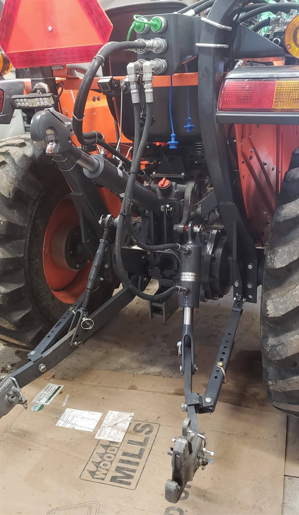

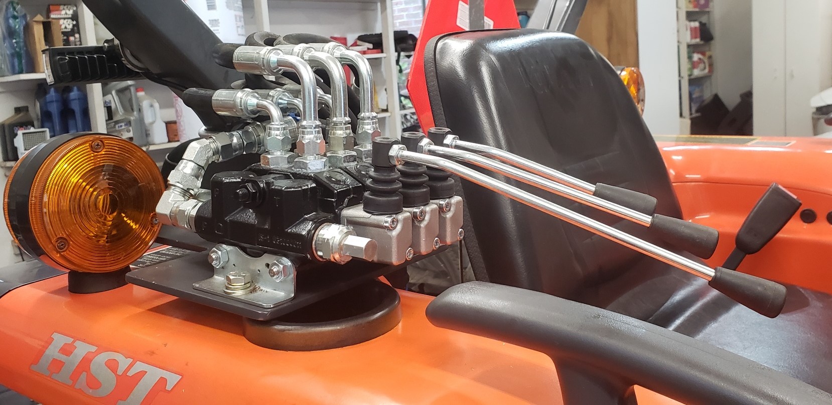

I installed Fit Rite's TNT - trust me if I can do it anyone can (with Brian's help).
I also installed a 3 valve rear remote package from him - your thinking like I did. Today I was measuring up for the hydraulic lines going from the back to my hopefully soon to be grapple from EA.
Here are some pix of what I did on my L3800
I also converted to the Euro style top ball connection that Brian also offers. He was a willing great resource for someone with 0 hydraulic knowledge.

The dealer will have the most expensive option. It should not be model specific but I don't know for sure for any brackets. If you have more money than time to build your own, go for it.
In my opinion, since parts are available, building your own is the most cost effective once you know enough about hydraulics....
I knew nothing about hydralics... What I did was added a 3 spool valve after my FEL from surplus center. https://www.surpluscenter.com/Hydra...l-8-GPM-Prince-MB31BBB5C1-DA-Valve-9-7863.axd
I plumbed mine above the FEL valve since I mainly used the 3rd function for a grapple. I wanted the handle to be very near by... This also allowed me to re-use hoses from the FEL to be used on power beyond (high pressure out).
I've never needed float nor do I think it's an advantage. When I set a top link or a side link. I do not want them to move so Double Acting Pilot Valve is what I wanted.

For an old fart like me it just makes life so much easier - one less thing to fiddle with. I store most of my implements on skids below my deck. Not one is level :( but once I get aligned with the lowers (tilt is great) I just extend / retract the top link and snap the end over the ball.
Brian fabricates his own balls (hmmm that doesn't sound right) so I ordered a few extra.
Oh, and that wait is 30 weeks, not 30 months.

Not sure, but I would guess an inch or two.
For the new top link Brian had me hook up my back blade and adjust the top link so the blade was level front to back. That was how we determined how long the hydraulic top cylinder had to be.
