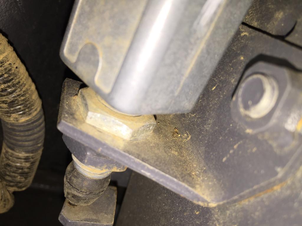

If it's the same as my L3200, the adjustment was at the switch located under the dash. No need to even crawl under the tractor. One picture shows the location looking toward the dash, and the other shows a closeup of the switch.
I removed the L-shaped bracket because it was a either a bit too tight for my hands or the switch wouldn't spin while it was still in place. I don't recall if the bracket is tapped or not but sort of think it was.
The switch plunger operates it OFF-ON-OFF if I recall, And it has 4 wires going to it. So the adjustment is a bit more important than that of an OFF-ON switch. There's a sweet spot in the middle. I posted info when I first did mine. That was probably in mid-2012 and likely has better details than what I remember today.

Nice photos, chim. In this case the L3200 is the same as the L3800.
Ranger, there is no grease fitting at the pedal. But these moving parts need lubrication.
As chim has pointed out, adjustment can be made at the switch and bracket to move the plunger up or down.
Getting down on the right side of the tractor you can use your left hand to move the pedal and observe the mechanics under the tractor. The plunger should be hit with the arm when the pedal is in center position.
You can electrically test by removing the switch connector. There are two switches to check. One is from pins 1 to 2, the other from pins 3 to 4. Resistance should be zero when pushing the plunger.

thanks guys... great help. I am thinking and hoping its in the pedal/switch. I thought I had the problem solved by cleaning the contacts at the starter, but the clicking returned.
In looking at the HST pedal switch plunger, I jiggled up and on the plunger and noticed it wasn't completely seated in, on the bracket. I pushed it back down in, just a hair to where it should be and it started without clicking. I am optimistic this is the problem but you know how that goes. I will loosen and adjust the bracket in a little bit too and see if that helps as well....
So, am I even remotely close in thinking that if the plunger sensor is not in that "sweet" spot or is on the edge, It would produce the clicking?
Need to get this figured out... thanks again folks !!!

If the plunger is in a fuzzy position, cutting in and out, interrupting, it could look like what is happening.
That is the most common symptom of the switch needing screwed in a turn and a half.
The switch is OPEN until it is depressed in a bit, then it is CLOSED to the bottom of the stroke. The engine does not crack until the switch is CLOSED.
