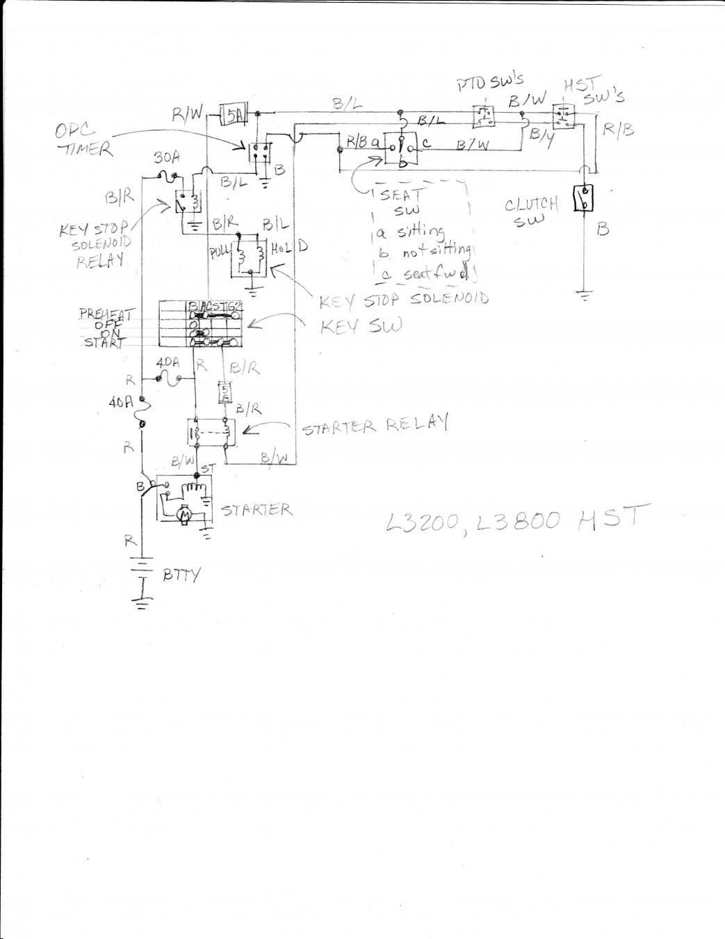

Where can I get a good wire diagram? I have searched but haven't found one to see what the relays are on the top of the dash. Since this is he area of damage that's all I can think it is. I am hung up on it being a PTO wire issue since when i stood up the tractor tried to shut off.

For a wiring schematic you will need to get the WSM, I don't know of a cheap or free copy that you can download. :(

Is your L3800 an HST, or is it a manual transmission? Some difference in circuit components.

OK, looks that the diagram is in the last post.
I would get a good printout(s) and use a highliter to trace out what you find, using voltmeter and/or bulb test.
If I were in the spot of trying to get the tractor back out of the field, with knowledge that bypassing the safety circuits could have deadly consequences, the circuit shows where to put a ground conductor and a live conductor to bypass the safety.
Otherwise, I would tow it back with another vehicle. Or put a tarp over it to diagnose in field. But it looks that the rear bonnet will need to come off to get to the components if that's what is damaged.

Update. It was the neutral position switch for the pedal. I bent the tap up a little and good to go. New dash and glass should be here next week. Only out about 160$ is what it is looking like. Thanks for the help.
