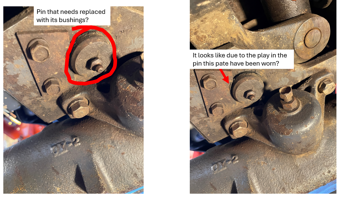

I have looked through the forums and I think I understand what is causing the slop. It is the main pin that the steering arm pivots about (the steering arm as I call it connects the tie rods to the hydraulic cylinder,
The post below shows the parts involved.
My question is, what is the best way to remove the pin and bushings.
Do I need access to the top of the pin? I think that is removing the radiator?
I have attached some pictures and videos of my issue. I think the part with the grease zerk is the pin and the bushings it is in also would need repaired.

You can paste pictures, videos you need to host them someplace like youtube and then give us a link to see them.
And yes I do believe the best way to get to everything is to remove the radiator.
