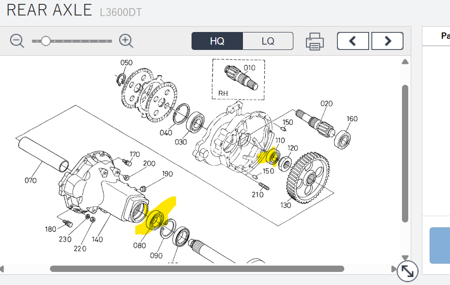

D DRJr New member Equipment Kubota L3600, L2350F, Ford 9N & Ford 600. Bush Hog loader, Ford rear scoop & b Oct 4, 2025 1 0 1 Alabama Yesterday at 4:59 PM #1 I have a L3600 that the right rear wheel will not turn when I try to drive forward or reverse causing left rear to spin. If I jack up the RR wheel I can turn it by hand Any suggestions ?
Shawn T. W Well-known member Equipment '05 L5030 HSTC - '21 MF GC 1725 MB - '18 JD Z960M Z-Trak Dec 9, 2024 356 630 93 SW Missouri Ozarks Yesterday at 5:27 PM #2 Are your tires filled? What air pressure are they at? Sometimes with low air pressure, there is enough of a seep in the bead, and you wheel spins inside of the tire ...
North Idaho Wolfman Moderator Staff member Lifetime Member Equipment L3450DT-GST, Woods FEL, B7100 HSD, FEL, 60" SB, 743 Bobcat with V2203, and more Jun 9, 2013 34,006 9,209 113 Sandpoint, ID Yesterday at 8:02 PM #3 Sounds like you have a bearing or gear issue and and when you put weight on it, it binds up and won't turn.
