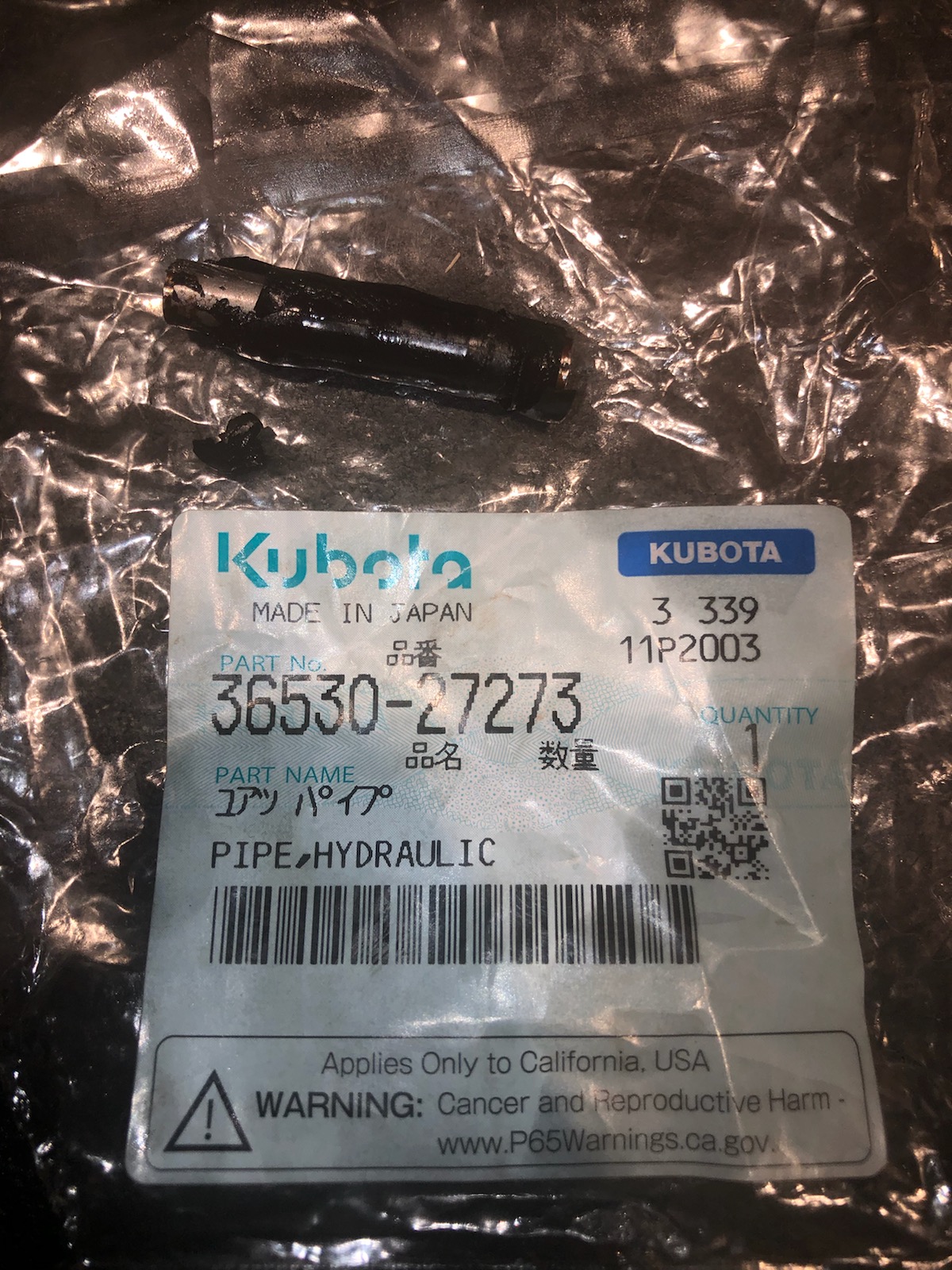

New here, inherited a L3600 that the shuttle was off the shaft inside. Restored shuttle and placed stops on topside... now bolted up side access transmission panel and replaced fluid. No joy. Feels like it’s in neutral. I can toggle fwd and reverse. Nada..tries, but no progress. tried 1-8 gears. Took banjo Fitting off / loose and have clean fluid, took shift lever off and confirmed alignment (180 out first time), and next plate to ensure fluid pushed out air... still no luck. Raises and lowered front end loaded and 3 pt, all seems normal except no fwd/Reverse. Any ideas out there? Am I missing a procedure to bleed air from valves behind all these Allen head plugs??

looking at low-pass valve I think, reading more.
May be as simple as I missed stabbing the H-L.
Bought a new rubber coated hydraulic tube that inserts, so I'll have to open it up again anyhow.
mine the rubber covering was degraded and completely gone on the end that inserts into the GST plate.
May be losing pressure there.
