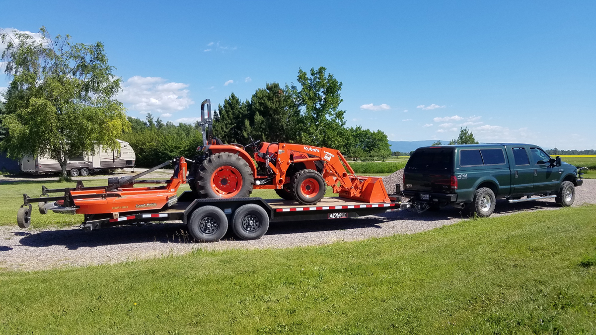

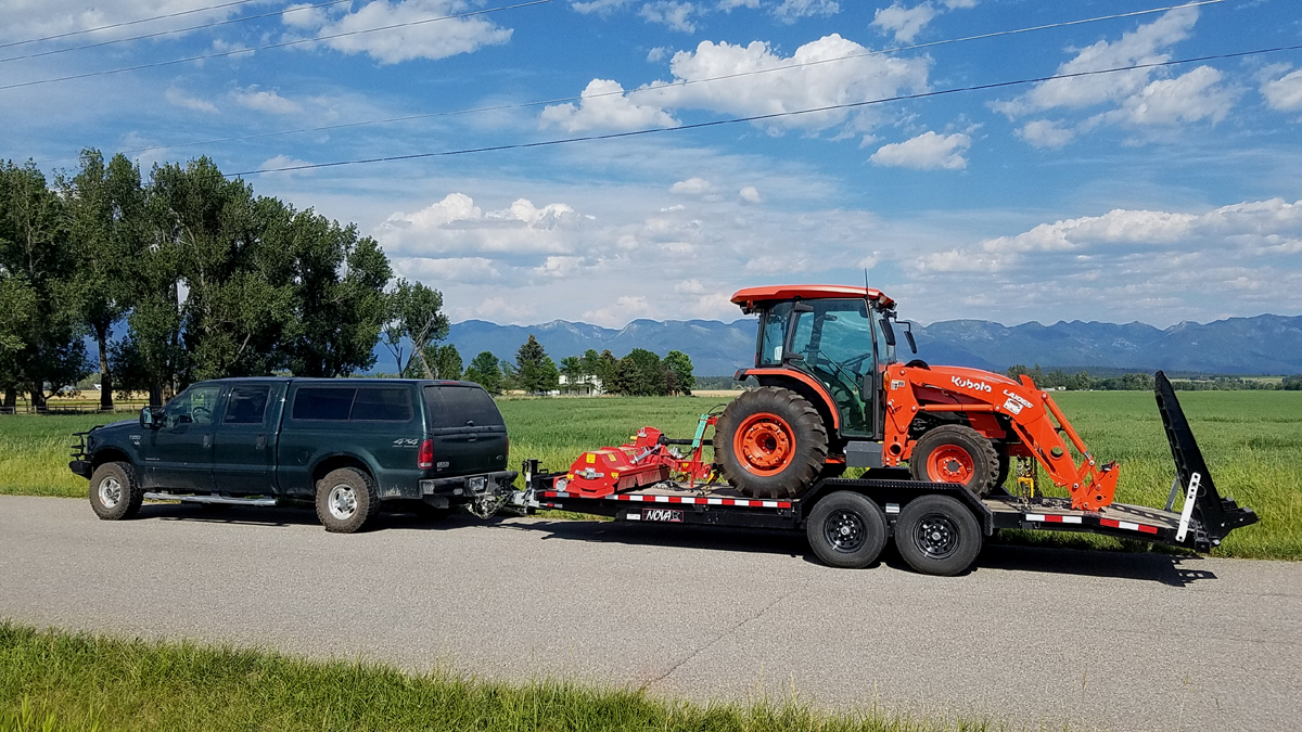

That L3560 is only 11" shorter than my MX6000 which I move around on a couple of 22ft equipment trailers. The photos below show two MX6000 tractors with three different implements , both with and without the bucket, and they might give you some idea as to amount of room available. Personally I'd opt for at least 20ft as others have said.
Even without the bucket on, the MX and 7ft rotary cutter wont fit on the 22ft trailer. I'll be using the 22ft hydraulic tilt deckover trailer to haul the M6060 and 7ft rotary cutter without the front loader attached, and that might just fit on the trailer without the tail wheels hanging over the back. We'll see soon enough.

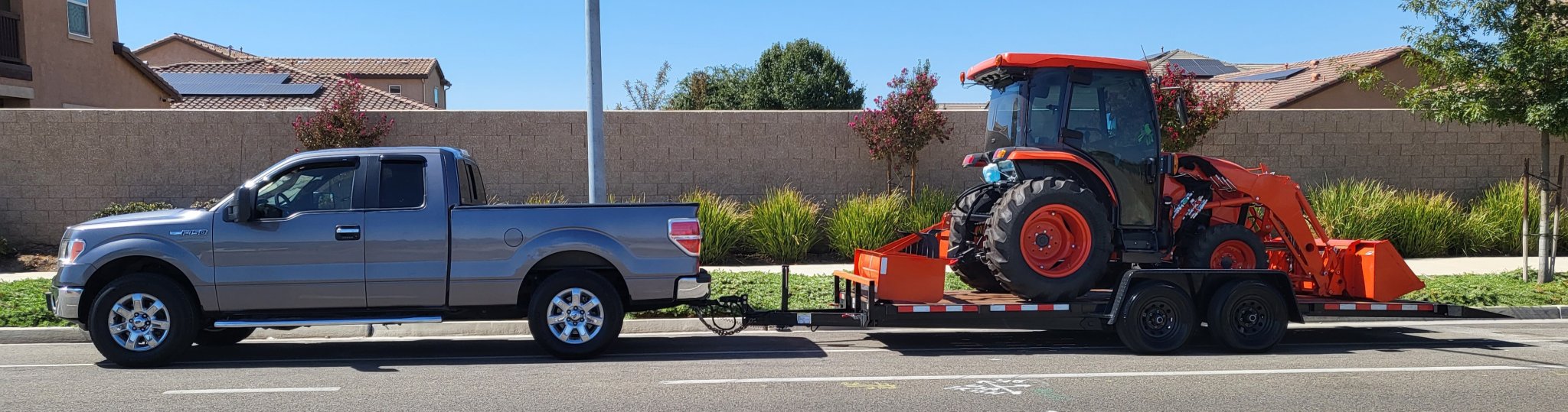

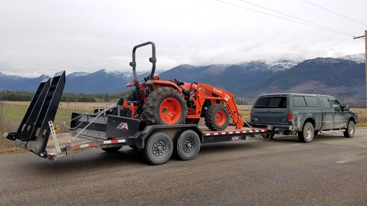

My L3560 LE with LA805 loader and box blade fits on my 18 foot 10K tilt. Hauled over 1020 miles so far.
If I had the choice to do it again I would go with a 20 foot trailer to give some room to play.
Ignore the lack of chains, this was just before unloading so chains were already off.
