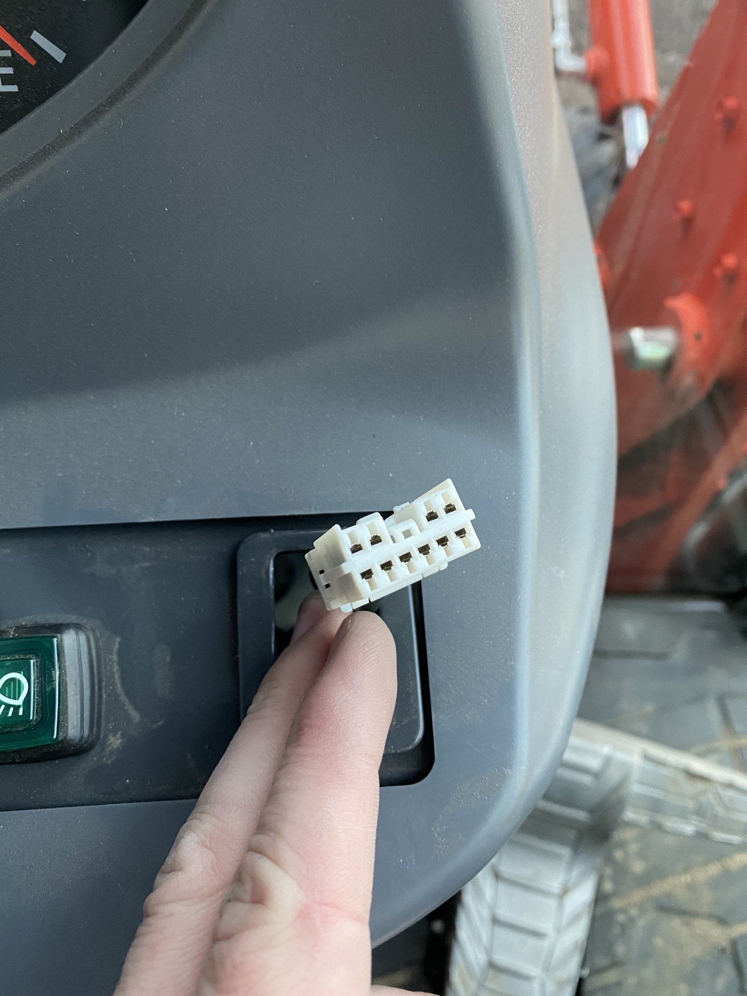

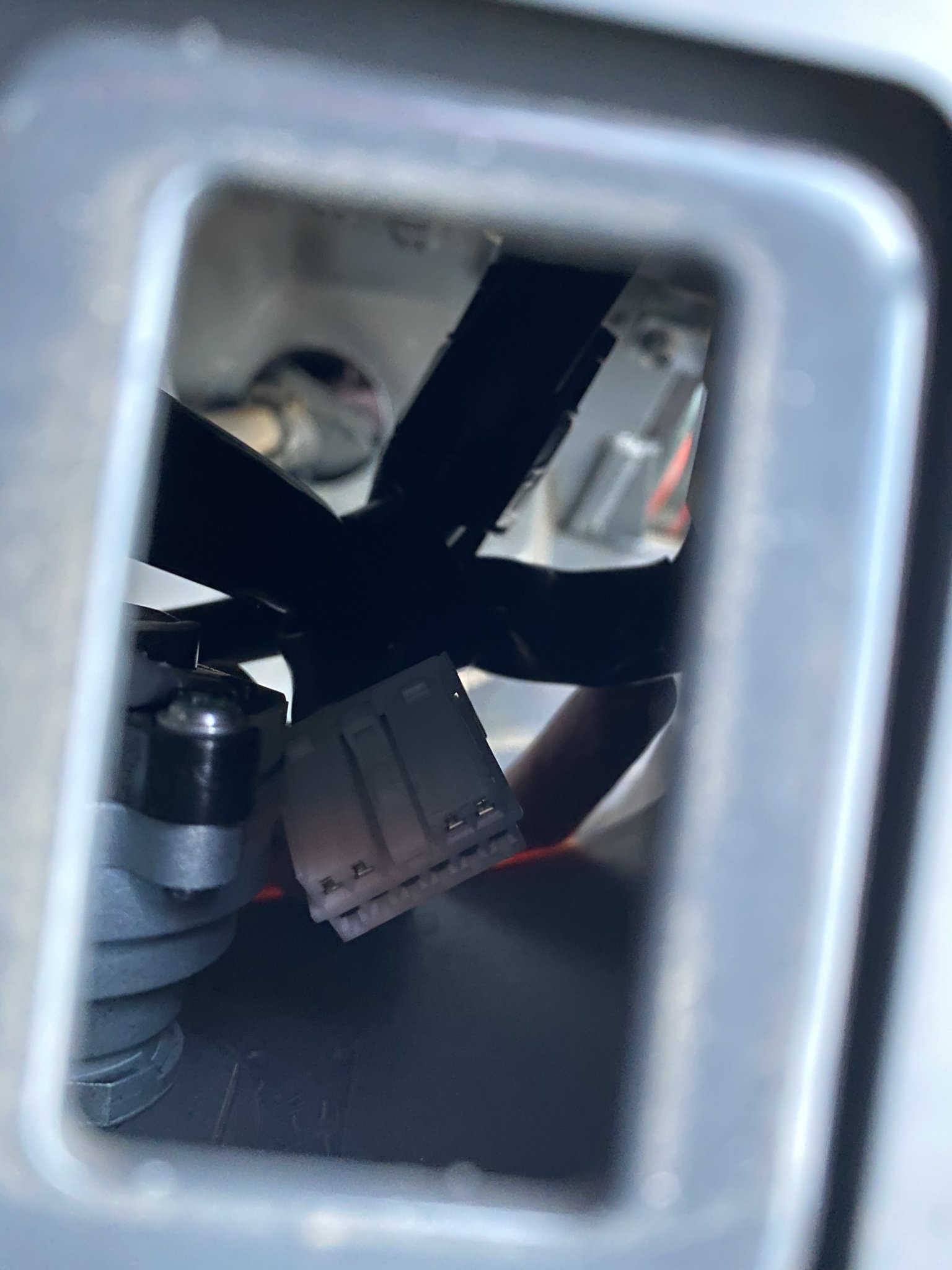

The harness was tied to another harness (with a reusable tie) just below the switch location. The plug was white IIRC and was the only unused plug in the area. I was able to push out the block off plate from underneath w/o removing any trim panels. I pushed the plug through the hole, snapped it in the switch and pushed the switch in place. All w/o any tools.

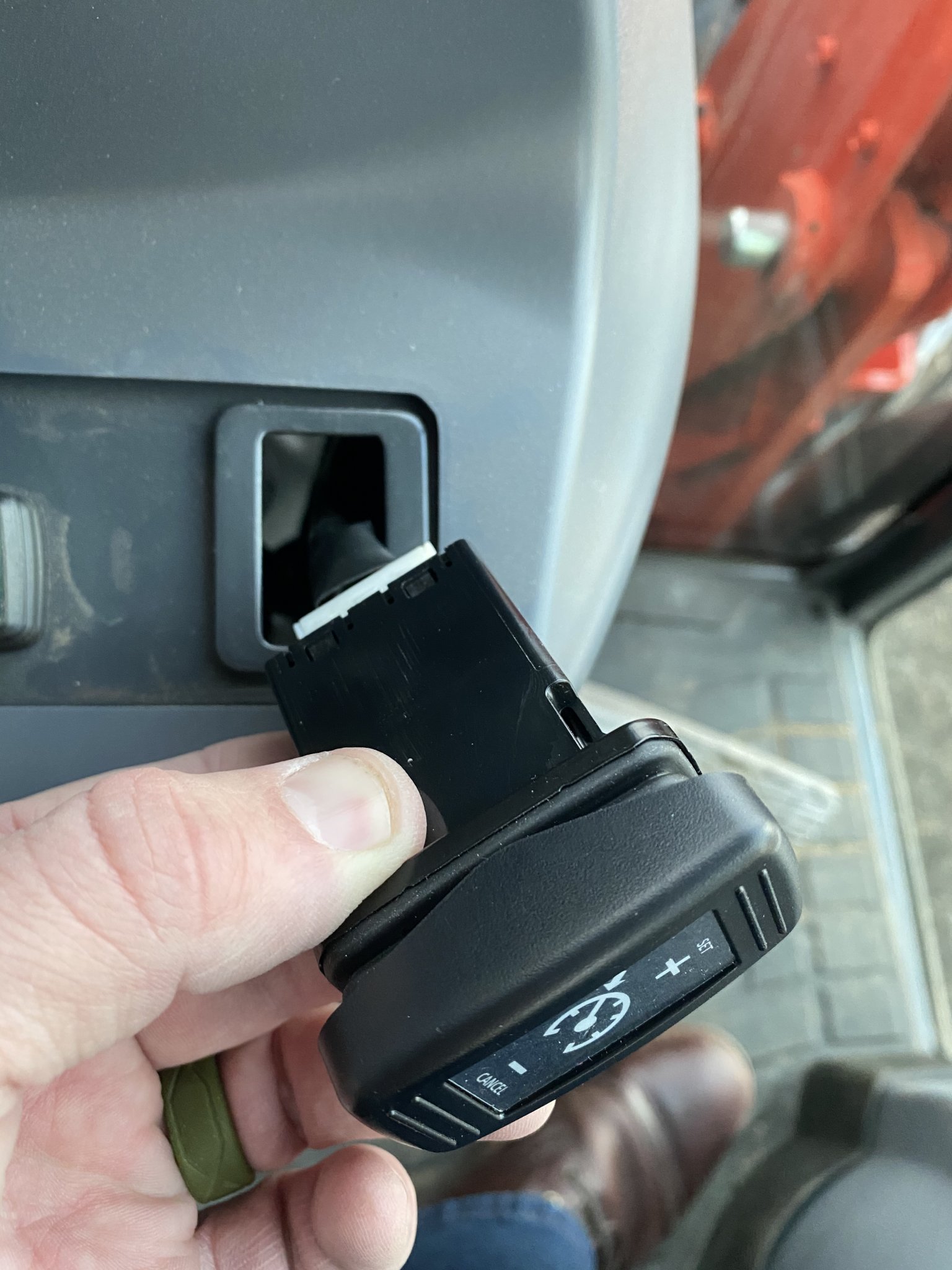

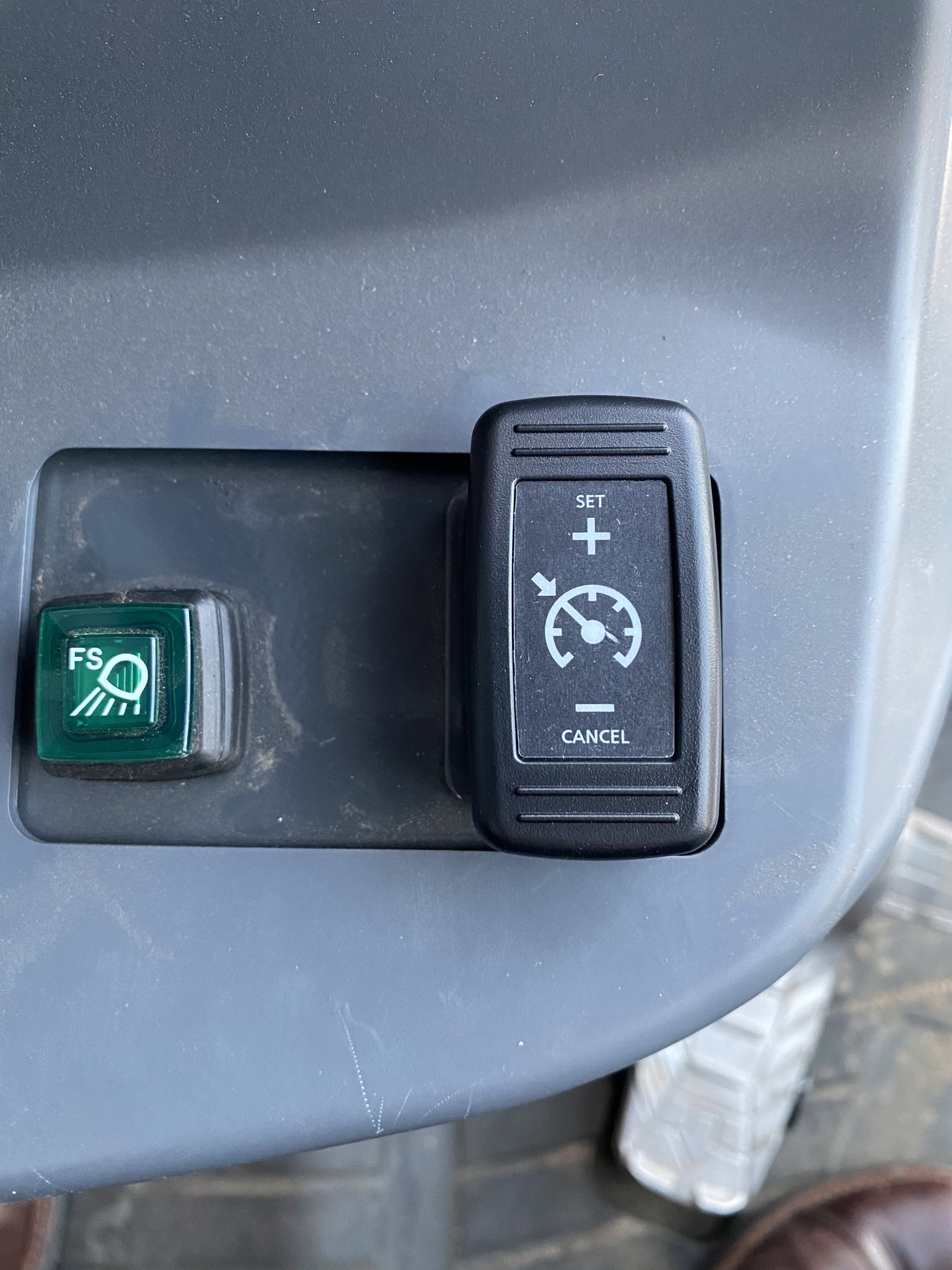

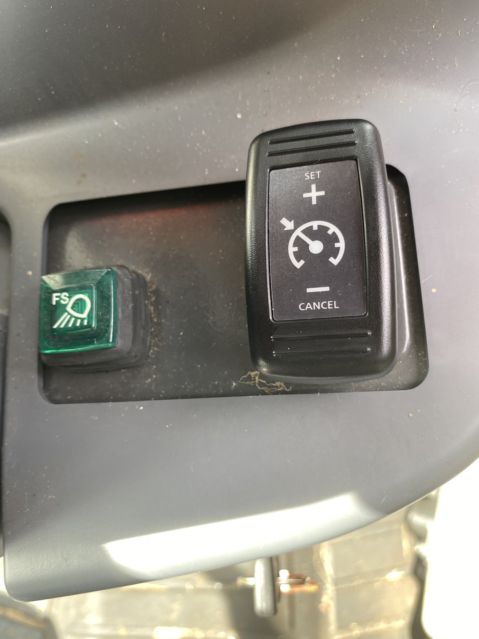

OP thanks for the tip! Got my switch yesterday and installed it in about 3 minutes. Few pics for everyone attached. Dealer couldn’t believe it as Kubota told them it wasn’t an option. I’ve added mirrors, LED work lights (front and rear), and rear wiper and saved a bundle compared to an non-LE unit.
got the work lights on amazon, they’re the 8” bars and are really bright. Wiring is all there, just have to find the plugs and get the switches.
got the work lights on amazon, they’re the 8” bars and are really bright. Wiring is all there, just have to find the plugs and get the switches. View attachment 54062 View attachment 54063 View attachment 54064 View attachment 54065
Well I installed the cruise control switch. Took about two minutes. Switch is a little pricey but worth the $$. Works GREAT!!! 👍

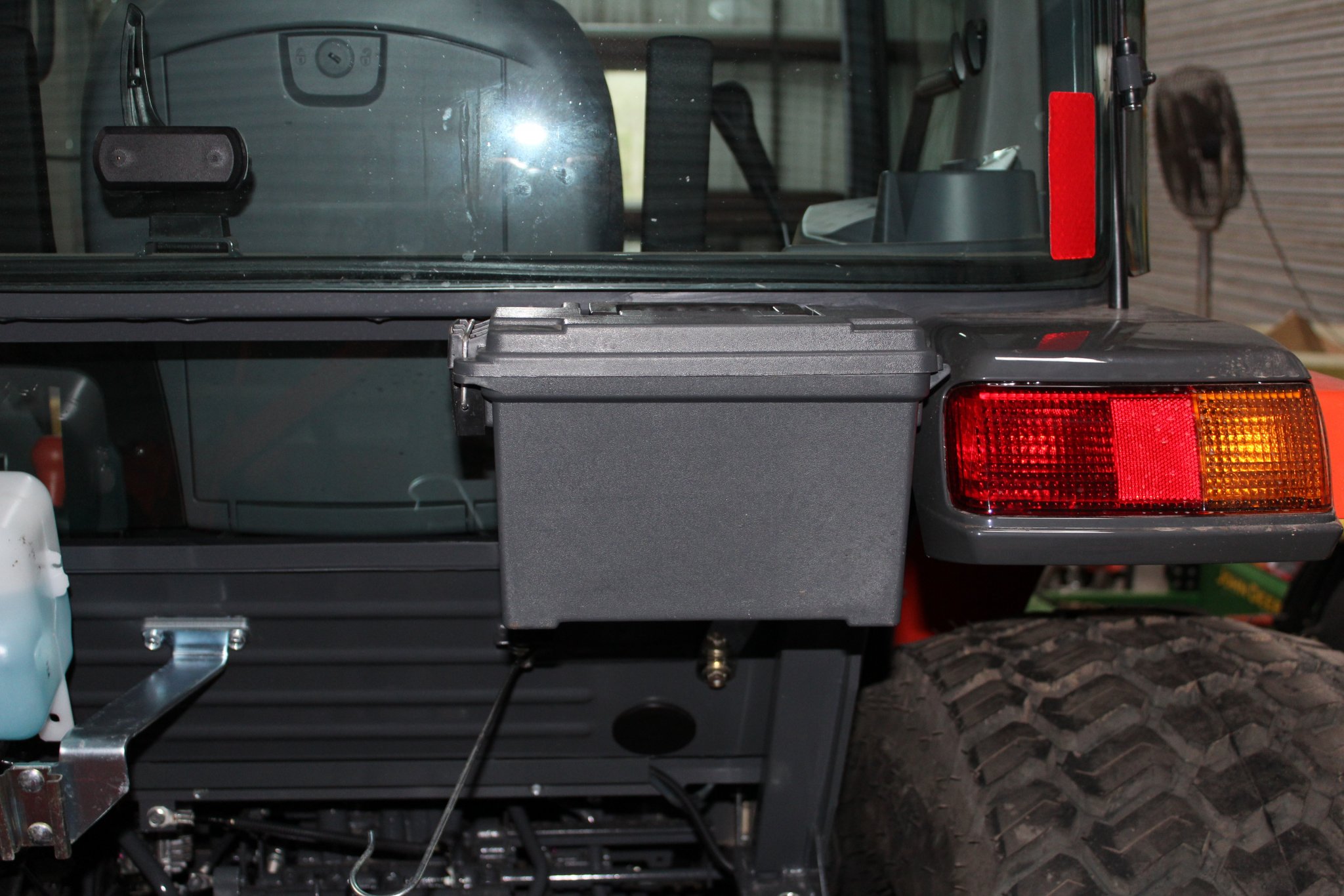

I just ordered my cruise control switch today, and wanted to show the tool box that I will be mounting on my tractor. I had originally purchased this box to keep tools dry on my boat, but have now re-purposed it for the Kubota. Gotta love the fact that it is nearly a perfect match for the Kubota Orange.
Plano Marine Box
