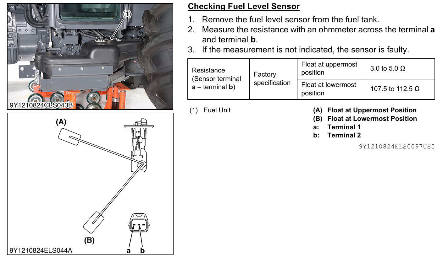

If you can get to the sending unit
How does one do this? I downloaded the wsm but have not found an r&r procedure yet.
They do have a side picture of it with the steps and what not removed for testing the circuit. Guess i'll just have to see what they've removed when I get home tonight.
