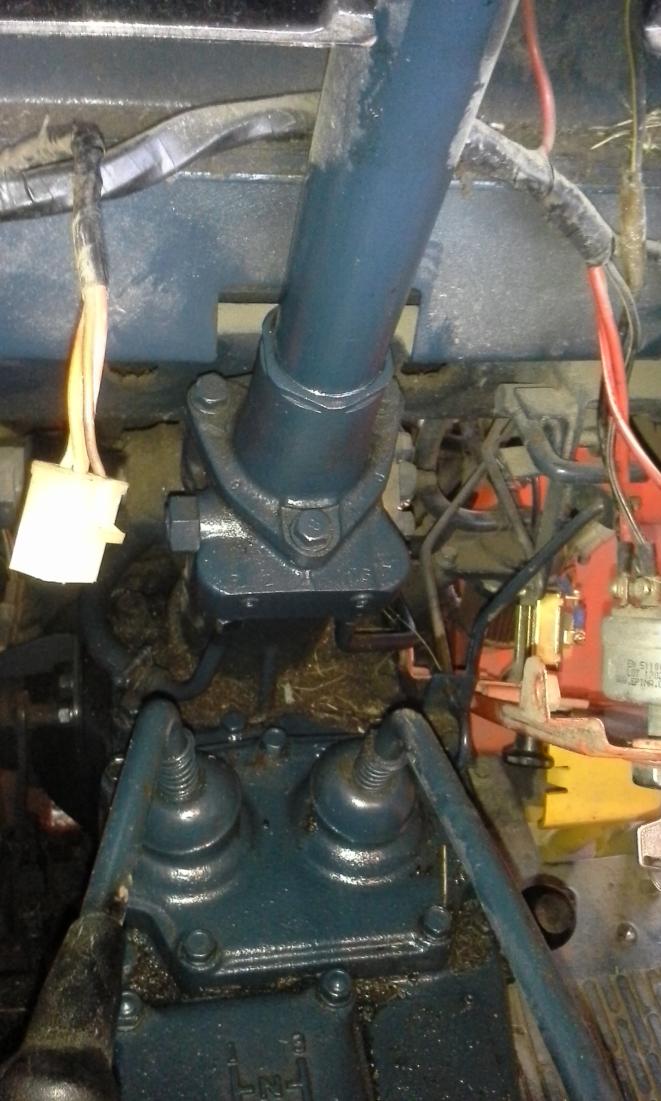

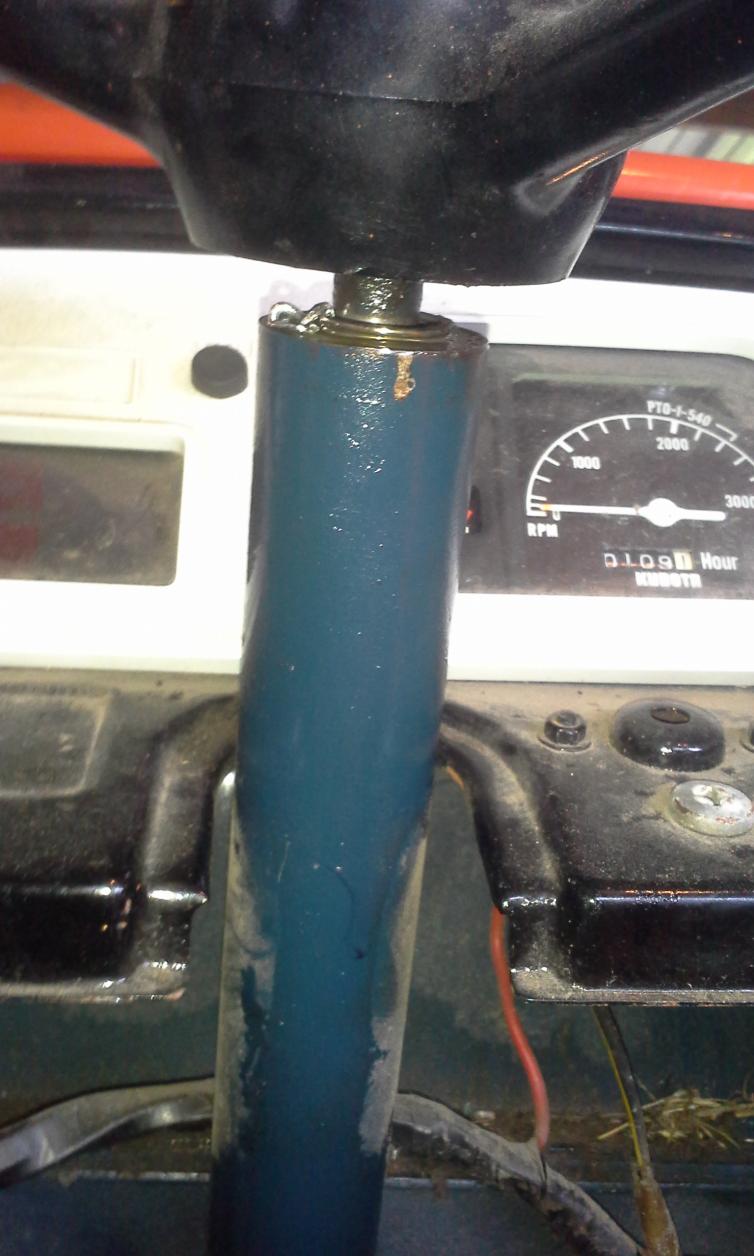

ok. Steering wheel is off. This is as far as I got. any suggestions what next?
With the steering wheel off, can you shoot us a pic of the top of the steering column looking down at it. Trying to figure out if that is a lip seal in the top of the column.
I'm also wondering if you have a bearing out, causing access movement in the column causing a lip seal to go bad,

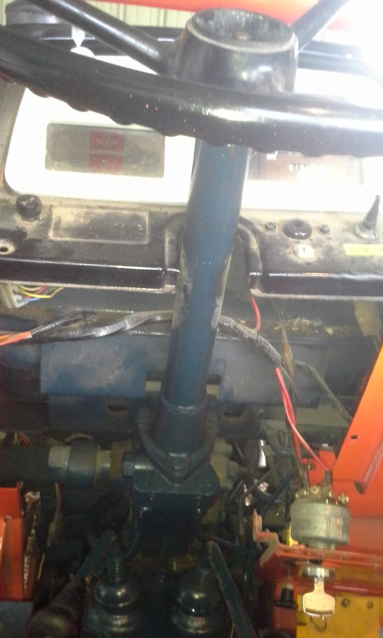

26
Axtell, Texas, USA
So, looking at the top of the column with the wheel off, it looks like a teflon sleeve down the tube. My question is - at the base of the column is three bolts, above those is a locking nut which I can loosen. (See pic #2 above) When loose, should the column above unscrew or will i need to take the three bolts off and take the base off to remove the column, giving me access to the steering shaft and hopefully a bad seal? I hope this makes sense. Also, where can I get a steering box replacement if i have to go that route. Sorry for the barrage of questions. Thanks for the help.
