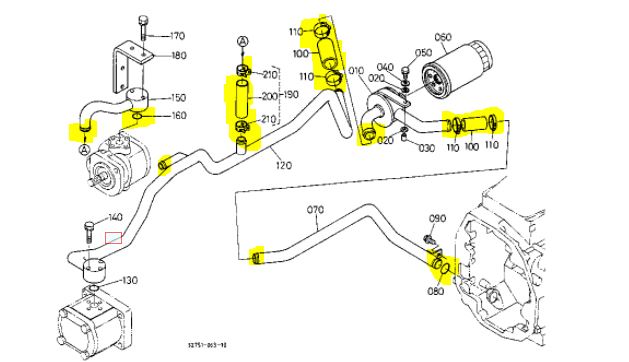

Check all of these connections, look for seeping fluid.
L35
Jun 13, 2010
582
516
CT
I just replaced those highlighted 3 inch rubber hoses they are under vacuum and will let air in but not noticibly leak fluid out. I notice quiter shifting now.
