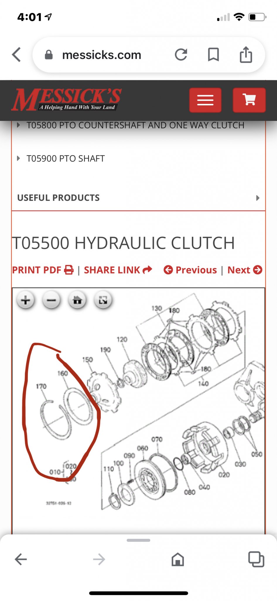

want to make sure I’m on the right track here, I’ve read other post with the same issue and believe I have a bad seal in the GST or the “snap ring” issue

next steps, I think I will invest in a hydraulic pressure test kit and try to figure out the testing process, I did purchase the wsa so that should help.
