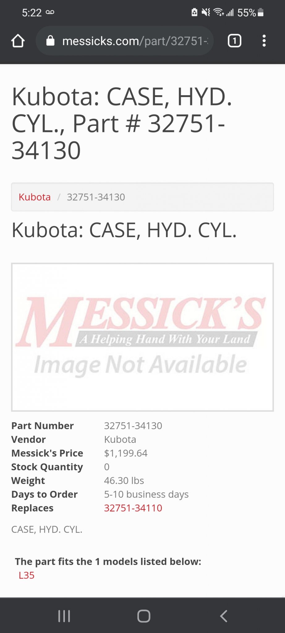

I have a L35 that has a broken Hydraulic Cylinder Case for the 3 point and Kubota has supposedly stop making a replacement for it. The part I am in need of is 32751-34130 if anyone has one or if I cant find the part, does anyone know a workaround for the 3 Point?
It looks like it can still be ordered through dealerships but it's not cheap ($1200).

Try # 32751-34114 $ 976.86
Thanks! that was worth a shot. I called 3 dealers, 4 parts houses, and 2 salvage yards this morning but no one has that part either. I have searched for 32751-34110, 32751-34130 and 32751-34114. I called 15 salvage yards yesterday and this part is gone before they put it on the shelf. Is there an aftermarket place that makes Kubota parts?

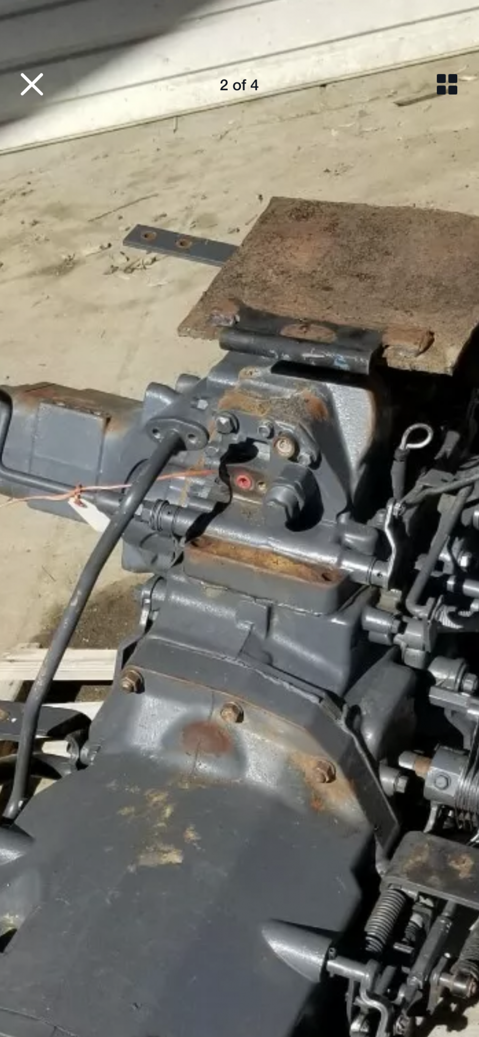

Problem is his is the TLB backhoe version. I have found one from an l series that would work for 3 point, and position control. The issue is how the front of the housing is machined. His machine has a double stack hydraulic feed that the prior is not machined for.
DRAGOK, do you have the broken off part (pic)close up? I have discerned the front O port flange pipe goes to the loader circuit, the rear O port flange is the feed in to the system from the front main implement pump. The two bolt flange pipe is the feed to backhoe. They reversed this pipe as a pb instead of the delivery on the regular L.
If the castings are the same, the part can be finished/machined to accept the feed.
All the l 3300-3710 look similar to these pictures with a single hydraulic feed.
I dont have the original piece unfortunately. I will work with the dealer and see if I we can find a way around this with that single hydraulic feed. Here to crossed fingers. Thanks a lot for you help!

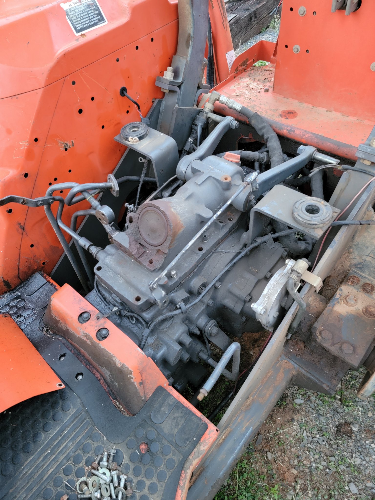

I had a conversation with a guy at Wingers and I bought the part for a L3710 he had in stock. I am going to try to use that part and reengineer the hydraulic lines by adding another valve where the old line was connected and send it directly to the backhoe. I should have the part on Tuesday and start figuring this out.

Sorry for the long delay, the Rockshaft housing fit right on but it takes A LOT of hydraulic hose engineering. I have had adapters made to fit from the L35 to the L3710 and then added, removed and changed hoses trying to get it to work. I had to buy all the components for the 3710 Rockshaft housing but it finally works. It unfortunately doesn't have the power of the old one. In my opinion, it would be better to make a hydraulic lift using the backhoe brackets to lift a 3 pt. I have spent a lot more money and time trying to make this work.
