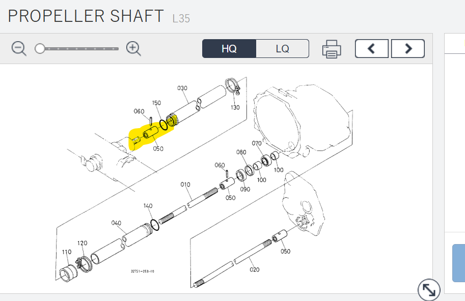

A even more common issue is the front coupler splines on the propeller shaft wears out.
36,493
11,273
I stated that I checked them and hoped that was the issue, it is not. I have been informed by the dealer there is also a coupler inside the trans that can only be checked by splitting the machine. I believe it is the shaft #20 in the exploded view above.
