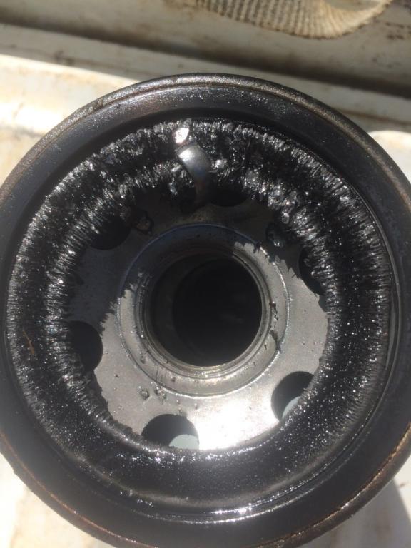

Sad day at the farm. Drained the oil and pulled the filter. Found carnage including a piece of cage bearing. Just bought the tractor last year. Got it with too many hours for too much money. It is not worth the cost of repair. Now to find something better. I really did like the way it could work.

I would look inside before I gave up on her.
33,391
8,704
They are not hard to fix, parts are easy to get and most are fairly reasonable.
