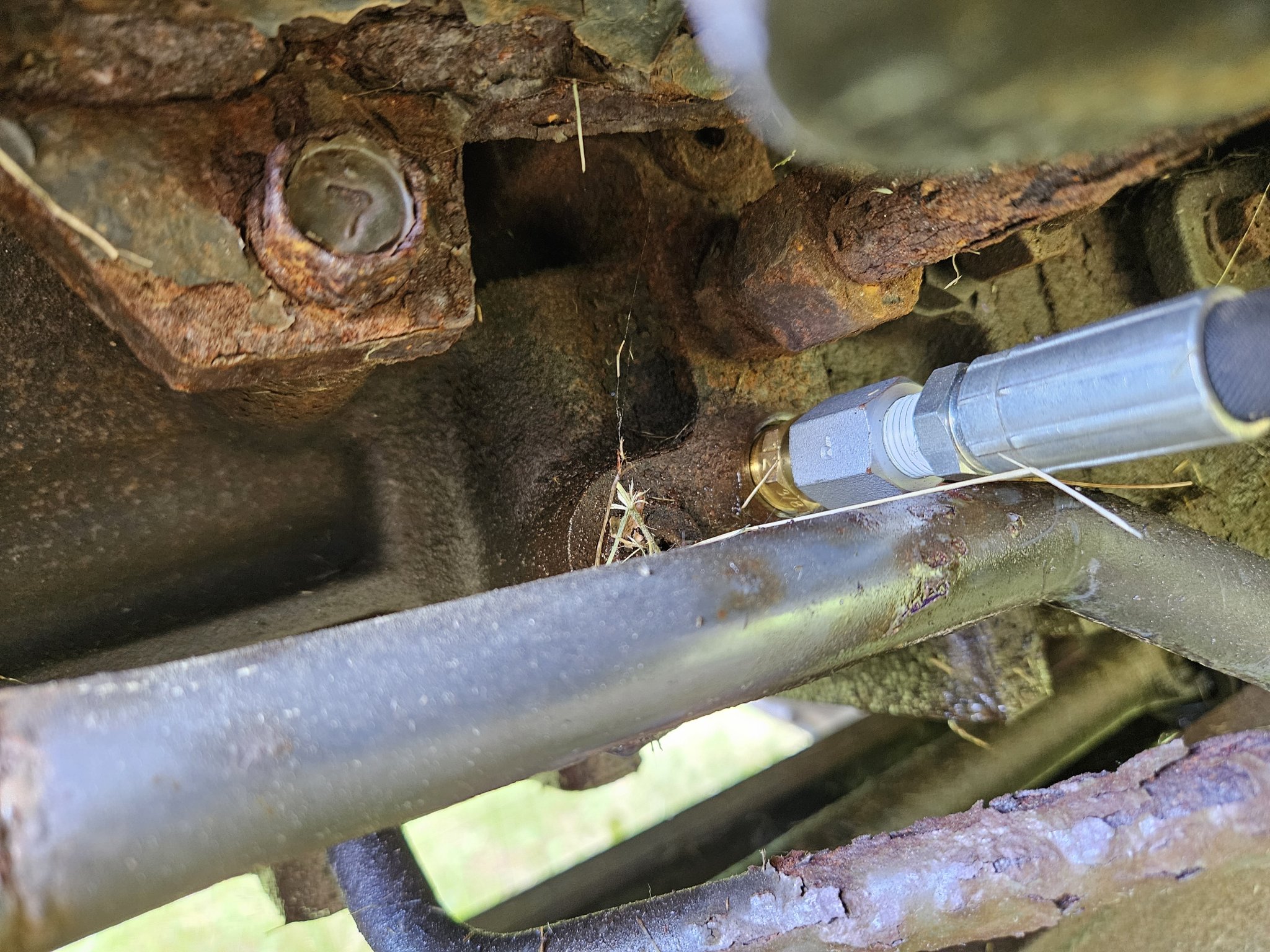

I'm using p2, p1 appears obstructed by something (see pic), possibly the cab floor which is pretty crunchy. The tractor was used for plowing snow at a hospital, and for spreading rock salt. Unfortunately they never heard of a pressure washer.
As for my gauge setup, I have a couple adapters connected to a 1/4" hose, connected to a quick connect coupling to a gauge manufactured by winters. I used a 0-3000 psi gauge for the charge relief pressure and a 0-10000 for the high relief pressure test.
