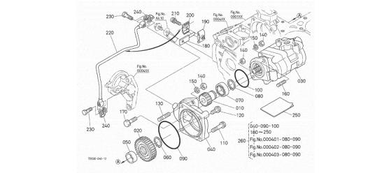

First thought without looking at manuals, hydraulic pump, or hydraulic drive shaft/spline.
IIRC, this model runs everything from this pump, including HST.
EDIT: Just noticed yours is GST, but appears to be similar.
33,588
8,829
Pull the Hydraulic pump and drive case and fully inspect it. ;)

Thank you very much for your help. I loosened the banjo bolt at the relief valve from the pump and started the tractor. No hydraulic oil came out so I followed your advise and removed the pump. Unfortunately, the bearing that supports the small gear failed which damaged both gears and broke the splined shaft off the end of the pump. About $1300 in parts. Ouch! I guess the wolves were chasing me today.
Anyway, thank you both again for taking the time to help me with my question.
