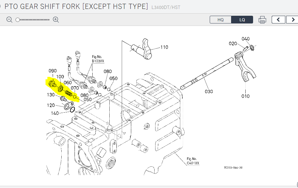

had this tractor for a few years, I noticed last year the PTO w/ snowblower on 3pt, would disengage frequently when not under load. Snowblowing works fine
When is disengages, simply push in the clutch and move the PTO lever back and forth and its good to go
I am thinking adjustment ?
33,010
8,457
There is ZERO adjustment to that setup.
The detent ball is what holds it in the engaged and disengaged position.
You could remove the bolt seal spring and ball (could have ball or spring damage).
Other than that, It would take splitting it to find out what else could be wrong.

thanks for the reply, much appreciated, I will have a look...I should also mention when it does disengage its kind of gradual with increasing rattling noise
33,010
8,457
Worn or Broken internal parts.
Fix it now before it causes other damage.
If it's slow to spin that's a clutch issue, get the WSM and try adjusting the clutch.
