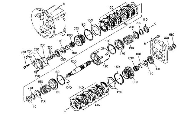

About this L3350 that loses tractive wheel power under load, my L5450 has a similar hydraulic shuttle - so my WSM gets into it somewhat. Your actual L3350 WSM would be easier to follow. (on the L5450 the shuttle clutch system was made larger and renamed the Ever Clutch).
I had been "conversing" with obrionmi for some time about the dry clutch replacement. But that was before I knew his L3350 has the optional hydraulic shuttle. This model has two clutches operating in series to power the wheels. I think the old worn dry clutch may now be fine - after all the replacements done - but the wet clutch (hydraulic shuttle) may not be getting adequate oil flow to do the job.
I'd do a deep dive on the shuttle control valve. My L5450 has a similar one and my manual tells how and what to test (without splitting the machine). Your control valve may be slightly different than mine since they changed the design when developing the new Ever Clutch version.
The fact the machine was used for six months using it's hydraulic shuttle as it's only clutch may have put more wear on it than normal. But these disk packs don't fail in both directions at the same time from normal use. The parts drawing here shows the hydraulic shuttle inside the trans case, this tractor's SECOND clutch. Take care, Dick B.
