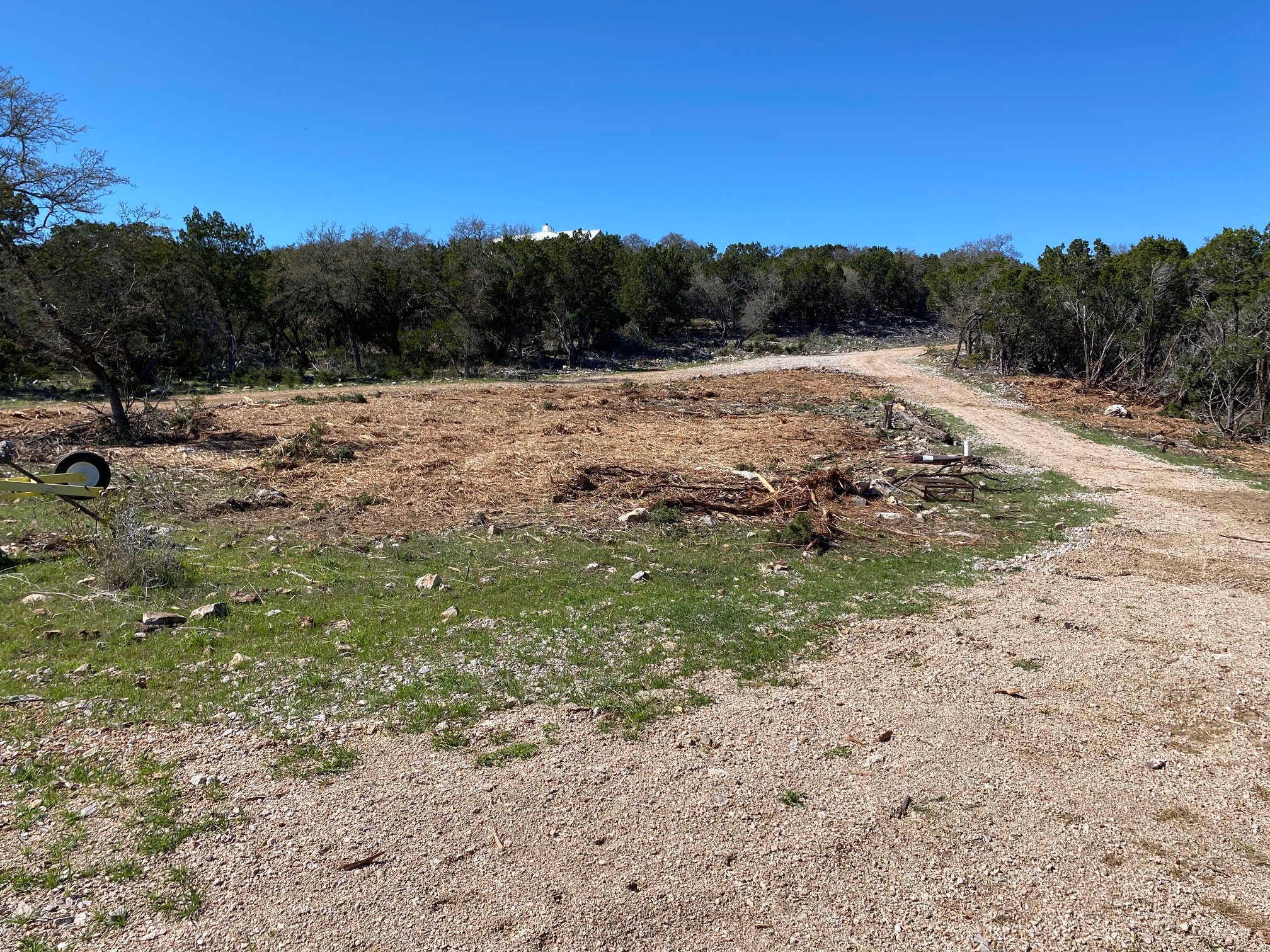

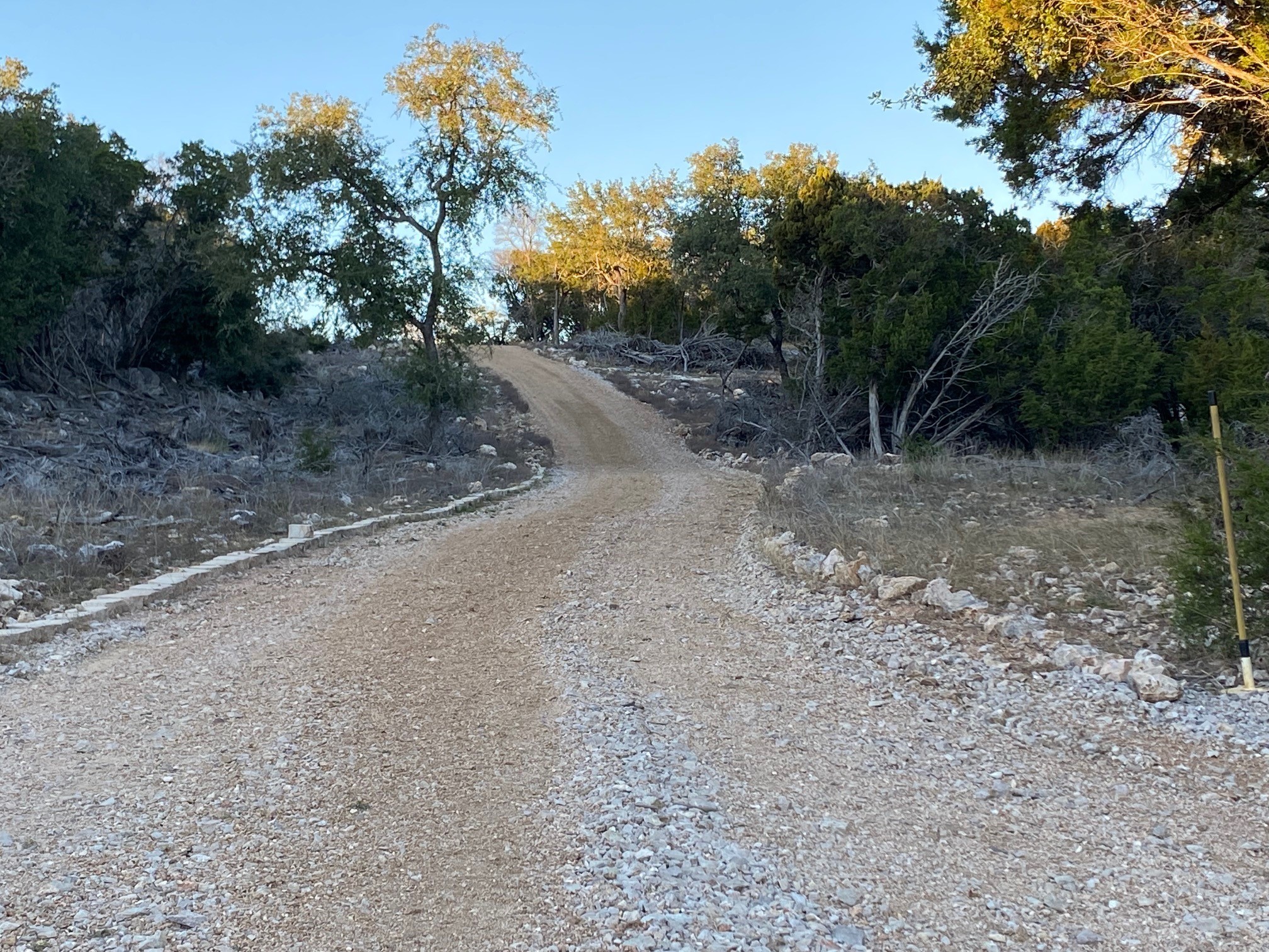

I’m about to buy my first tractor for a hilly lot in the hill country of central Texas. 13 acers with the whole lot full of trees other than what has been cleared with bulldozer, forestry mulcher, etc. I have a 1000’ driveway on a slope. Lots of down trees to clean up from the bulldozer, moving rocks, take care of driveway, scrapping small rocks to clear area around build site, prep barn foundation, clear trails, etc.
I have access to a large 12” chipper from a family member to chip all the piles of bull-dozed trees and he is giving me a PTO chipper he doesn’t need after getting the big chipper.
I think I’ve decided on the L3302? I think I need the extra HP to move around better on my steep hills and to run a PTO chipper. I also like the extra options of the new 02 series over the 01 models. At $2300 more for the L3902 I think I’d be better off spending that money on two rear remotes for the L3302.
I might rent a PTO Belltec post hole digger for putting in fence around house.
Tractor package looks like this:
L3302 HST 4wd, QA loader, R4
3rd function
2 rear remotes
Box blade, grader, grapple, pallet forks, 3 pt QH
As of today, 0% financing says till end of June 2022. Will it continue past June? I planned to purchase around September when my RTV is paid off but I could move that up if I have too.

It sounds like an awesome place with fun to develop it the way you want. It’s hard to understand size and scale of your work without pics…It might be helpful to estimate the size and weight of the stuff you want to lift and move with the front end to make sure the machine you select meets your expectations….whether with grapple or forks or whatever…how much do you want to safely pick up and move? When I hear ‘steep and hill country’ I think you may not be able to use the full lift capability as you may rarely be on level ground. So that’s maybe something to think about. I don’t think it matters which model when it’s on a slope you start losing safe lift. / move capability. You can always cut stuff small or split a load on a pallet, but I think it might be helpful to think about machine size and how much you want to be able to move…do those two things match? Maybe I missed it but have / are you considering ballasting options, weights, width of track/stance? Just my thoughts.
