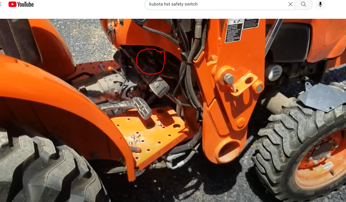

When you look at your tractor you will see a metal plate covering this area. It can be removed with three bolts I think. Pull that off and you will see the switch in plain sight. By the way, you can see the plate resting on the front tire in this photo.
Here is where I snipped the photo from. (20) KUBOTA L3901 NO START! saftey switch OPC Tractor - YouTube
It is possible that your switch just might need adjusting vs. replacing. I went ahead and replaced mine as I didn't want to mess with it and get stuck in the middle of nowhere :)

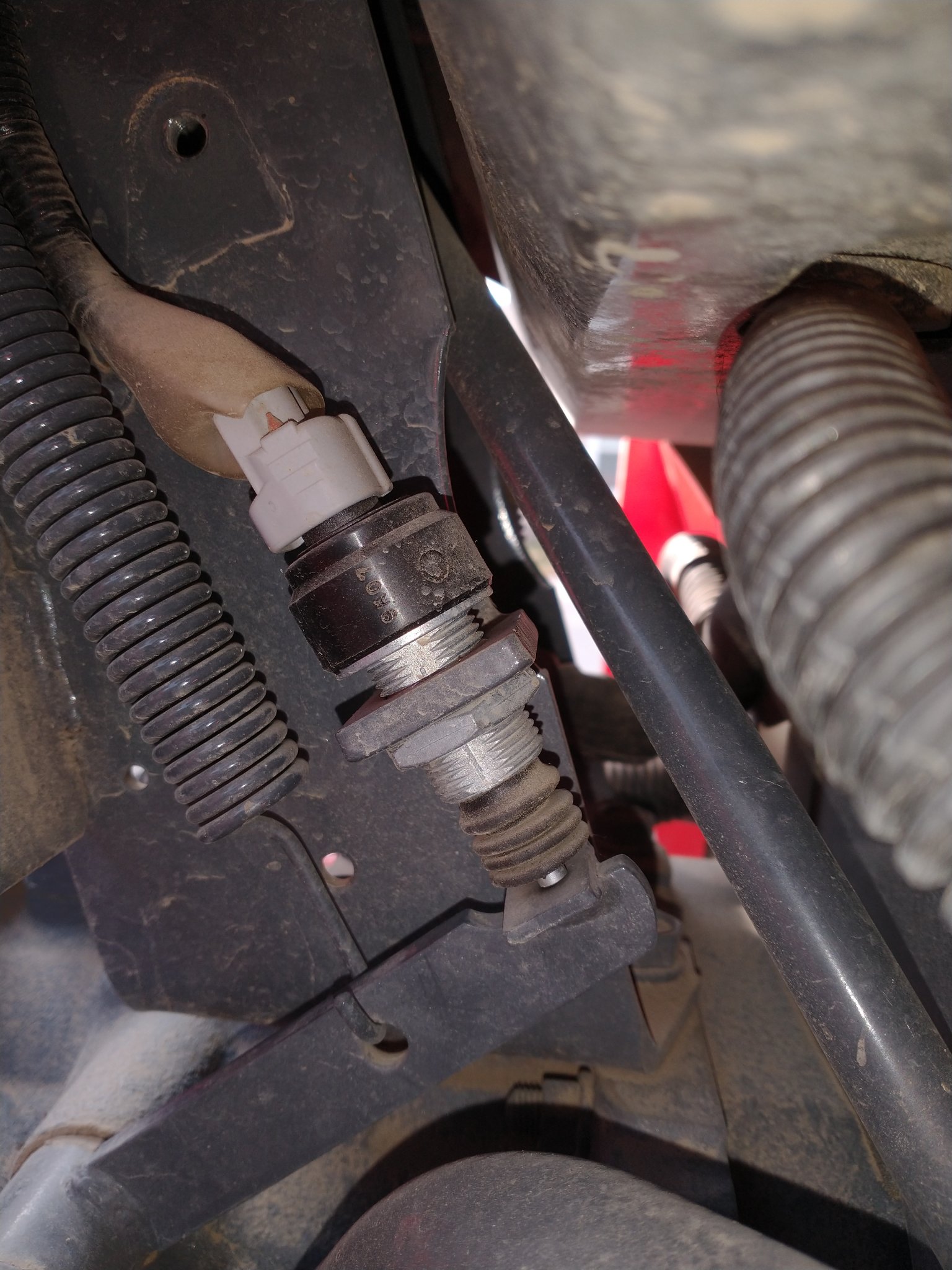

Thanks to you I found it. I'll try adjusting it, just have to figure out if it needs tightened or loosened.
You clearly have some thread left to screw that switch down towards the lever the presses the plunger, so you can try that. Also, you can take a meter to the switch and test it a whole bunch of times. Mine only worked about half the time.
let us know how and if you get this fixed.
rr
7,388
2,764
Disconnect the wiring harness before you start turning the switch in circles or you will probably hurt the wiring. Hopefully this is good advice and not insulting in any way.
