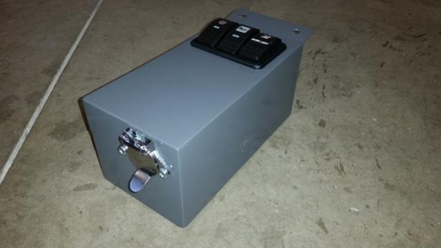

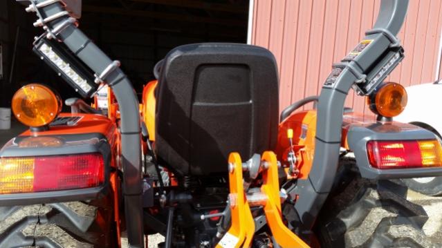

Been wanting front and rear LED worklights , horn and rear accessory jack to plug in sprayers. Decided to build a control panel take care of all at once.

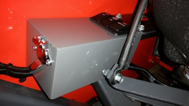

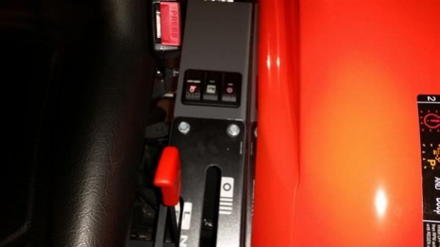

Tried to make it look as OEM as possible by essentially extending the range selector plate. Designed to use all existing fasteners so I wouldn't have to drill holes in my new tractor and possibly affect warranty.

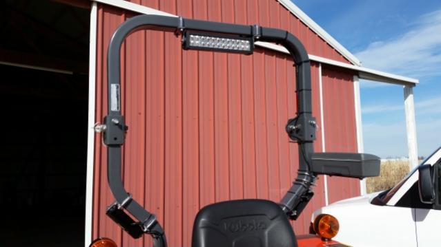

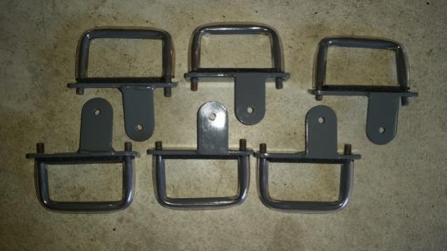

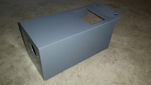

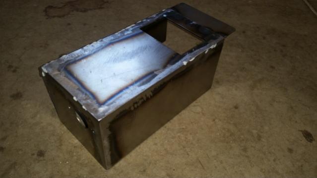

Fabricated the control box out of 16 gauge plate. Used 5/16 rod to make the ROPS u-bolts and 1/4 plate on the brackets for mounting the lights. Painted everything gray and sheathed the u-bolts with vinyl hose so they won't scratch the ROPS paint.

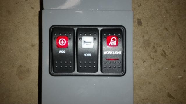

Surprisingly, when done, everything works! The spst accessory switch turns my sprayer jack on and off, the momentary horn switch...well...honks the horn, and the spdt work light switch turns on the front work lights when pressed forward and turns on the rear work lights when pressed to the rear position, center is off.

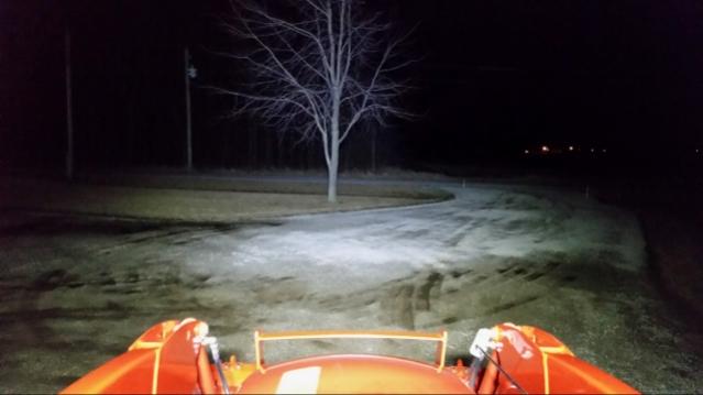

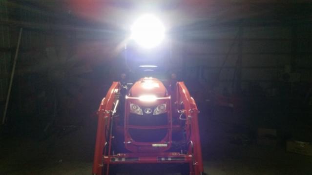

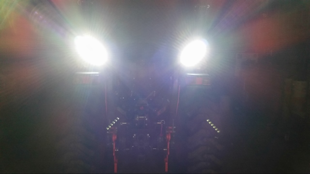

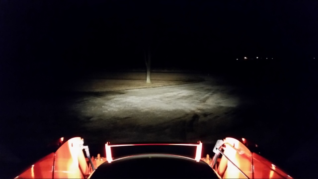

The LEDs are incredible. Since the tractor headlights are blocked by the FEL and the factory rear worklight was a big disappointment, this is a huge improvement. Pictures don't do them justice,turns night into day.
Only bummer is now I have to come up with another project.
