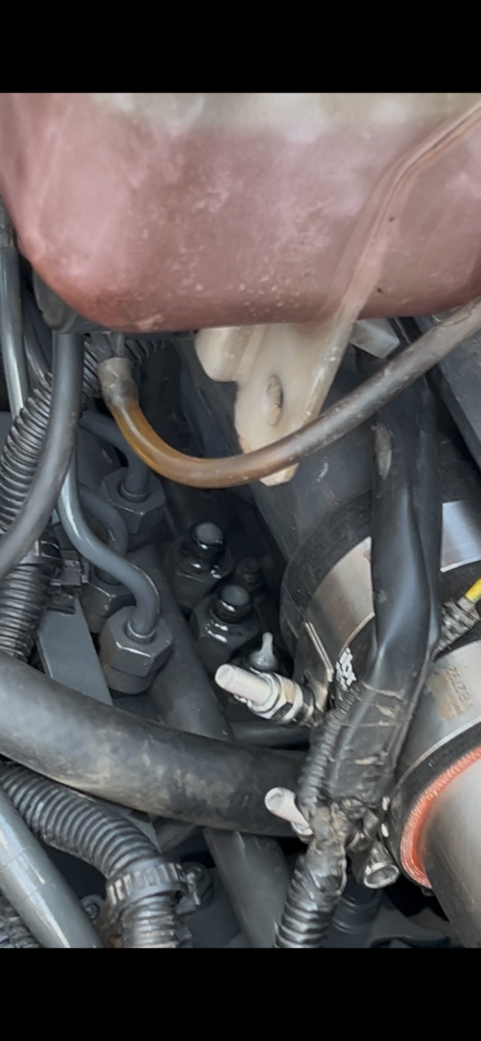

Guys, Quick question. I can’t attach a video to this forum of my injection pump cranking operation with fuel lines removed, but I will attach a photo. All 3 injection pump ports only burp fuel about 1/4” high, this doesn’t seem normal. I have seen BX 3 cylinders shoot fuel across the shop in cranking test??
Now, if I’m not mistaken. This would explain the engine running smooth until a load demand of higher rpm’s / 540 is imitated. Any thoughts.?
32,892
8,366
Your fuel also looks frothy???
If your starving the injection pump that bad it really shouldn't run at all.
Pull the fuel line feeding the injection pump and bottle feed it.
This eliminates all fuel delivery issues.
I don't think it's going to help you much.
I'm thinking the pump or governor has got an issue?

You could be right.
After applying a head psi to the fuel tank during the power Surging operation, the power surging clears up and then again returns when tank head psi is removed. So Kubota tech is thinking we have a fuel pump with a crack in the internal bellows. We will install a new fuel pump tomorrow and report back.
