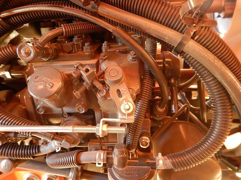

The WSM only talks about where the hour-meter cable is hooked up behind the panel. It doesn’t show where the other end of the tach/hour meter cable goes on the engine. Does anyone have a picture of where the non-instrument panel end goes in the engine of a L3200DT?

Not sure if your engine is the same, but location should be close.. the cable loops in directly above the oil filter close to the front of the engine on mine..

I have access to the WSM. The issue I’m having is it only mentions the instrument panel end of the cable. I can’t find any reference to the other end and where it goes. It is probably obvious if I start pulling the body parts off, but I was hoping I didn’t have to do that. Thanks for the suggestion though!

I believe that might be it, Shadetree. Thank you!

This is an L3800, which for this purpose is the same as the L3200. Right hand side of tractor, look from white filter up at 11 o'clock to black cable ending in knurl - that is the tach cable.

Now to unscrew it, lube it, and cross my fingers...
